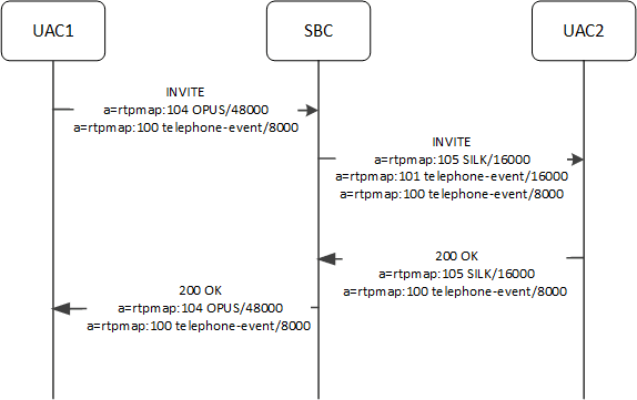

Example 1
In this example, you have configured allow-diff2833-clock-rate-mode to the value use-2833-clock-rate on both the ingress and egress sip-interface elements.
  • allow-diff2833-clock-rate-mode to use-2833-clock-rate on the ingress and the egress sip-interface
  • Ingress codec-policy allows OPUS and telephone-event
  • Egress codec-policy does not accept OPUS, but adds SILK wide-band, and telephone-event::8k
This image depicts the SBC supporting different clock rates for media and telephone events at ingress and egress.
The call flow proceeds as follows:
  1. The ingress codec-policy allows telephone-event having a different clock rate than audio codec. So, the first offer contains OPUS/48000 and telephone-event/8000.
  2. The egress codec-policy removes OPUS, which is not supported, but does not remove telephone-event/8000. It adds SILK/16000 and the corresponding telephone-event/16000, and sends out the offer to UAC2.
    The egress side allows a telephone-event clock rate that is different from the audio clock rate. Therefore, the system does not remove telephone-event/8000 from the offer. Because telephone-event/8000 is already present in the offer, the system does not add the configured telephone-event::8k (based on codec policy) again.
  3. The egress side generates an answer and sends it towards ingress containing a telephone-event that is the same clock rate as was originally offered, in this case (telephone-event/8000).
  4. The system generates RFC 2833 packets towards the ingress and egress using telephone-event clock rate, which is 8000.
Results of this call flow include the ingress codec-policy allowing OPUS and telephone-event. The egress codec-policy does not allow OPUS, but adds SILK-wideband, telephone-event::8k.

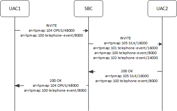

Example 2
In this example, you have configured allow-diff2833-clock-rate-mode to the value use-codec-clock-rate on both the ingress and egress sip-interface elements.
  • allow-diff2833-clock-rate-mode to use-codec-clock-rate on the ingress and the egress sip-interface
  • Egress codec-policy does not accept OPUS, but adds SILK wide-band, telephone-event::8k and telephone-event::24k
This image depicts the SBC using the codec clock rate setting to support different clock rates for media and telephone events at ingress and egress.
  1. The ingress codec-policy allows telephone-event having a different clock rate than the audio codec. Therefore, the first offer contains OPUS/48000 and telephone-event/8000.
  2. The egress codec-policy removes OPUS, which is not supported, and doesn’t remove telephone-event/8000. It adds SILK/16000, the corresponding telephone-event/16000, and telephone-event/24000 and sends out the offer to UAC2.
    The egress side allows different clock rates for telephone-event and audio, Therefore, the system does not remove the telephone-event/8000 from the offer. Since telephone-event/8000 is already present in the offer, the system does not add the configured telephone-event::8k (based on codec policy).
  3. The egress side generates an answer and sends it towards the ingress containing a telephone-event with the same clock rate that was originally offered (telephone-event/8000).
  4. The system generates RFC 2833 packets towards the ingress and egress, based on the audio codec’s clock rate, which is 48000 towards ingress and 16000 towards egress.

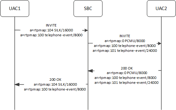

Example 3
In this example, you have configured:
  • Ingress codec-policy allows SILK and telephone-event
  • Egress codec-policy does not accept SILK, but adds PCMU, telephone-event::8k and telephone-event::24k
In addition, the Enterprise SBC sends and receives multiple telephone-events in the answer.
  1. The ingress codec-policy allows the telephone-event to have a different clock rate than the audio codec. Therefore, the first offer contains SILK/16000 and telephone-event/8000.
  2. The egress codec-policy removes SILK, which is not supported. This policy adds PCMU/8000 and telephone-event/24000 and sends out the offer to UAC2.
    The egress side allows the audio and telephone-event to use different clock rates. Therefore, the system does not remove telephone-event/8000 from the offer. Since telephone-event/8000 is already present in offer, the system does not add the configured telephone-event::8k (based on codec policy).
  3. The egress side generates an answer, selects the topmost telephone-event (8000) and sends the answer towards the ingress containing a telephone-event using the same clock rate that was originally offered (telephone-event/8000).
  4. The system generates RFC 2833 packets towards the ingress and egress, based on the audio codec’s clock rate, which is 16000 towards the ingress and 8000 towards the egress.
Results of this call flow include the ingress codec-policy allowing SILK and telephone-event. The egress codec-policy does not allow SILK, but adds PCMU, telephone-event::8k and telephone-event::24k;.
