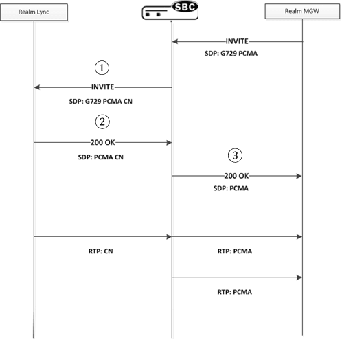

Case 1
The Case 1 CN generation SPL call flow is described below.
  1. SDP offer received from the realm that has comfort-noise-generate enabled. If the SDP offer contains CN, no IWF is required. If it does not contain CN, and at least one of the offered audio codecs is PCMU or PCMA, CN is added in outgoing SDP offer.
  2. If SDP Answer contains the CN codec and topmost audio codec is PCMU or PCMA, Enterprise SBCenables CN IWF.
  3. Enterprise SBC strips CN from outgoing SDP Answer.
