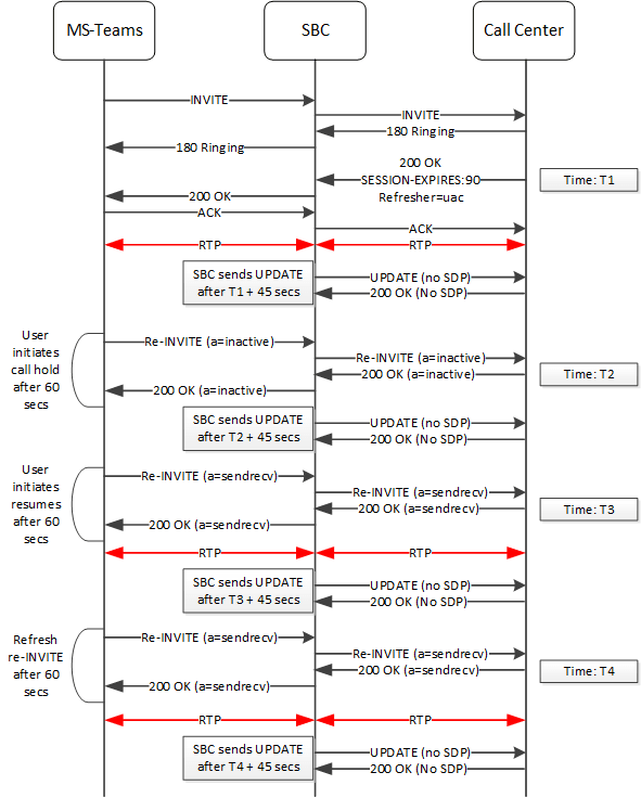

The call flow below presents the Enterprise SBC performing the functions of the session-timer-profile below. This profile has its force-reinvite parameter set to its default, enabled.
The SBC supporting session timer configuration with no re-INVITE suppression
