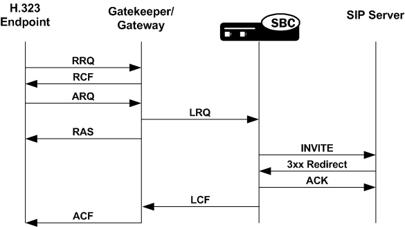

SIP Redirect—H.323 LRQ Management

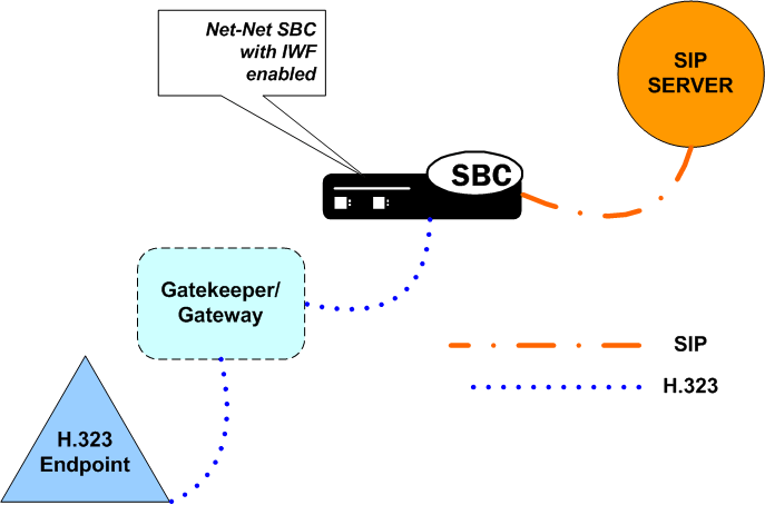

When it needs to interact with a SIP Redirect server, the Enterprise SBC can interpret the SIP messages and manage them on the H.323 side of the session. For IWF sessions, the Enterprise SBC handles SIP Redirect and H.323 LRQ messages.
The Enterprise SBC supporting a SIP redirect within H.323 IWF.
Redirect—LRQ Management Sample 1
This section presents three possible scenarios for SIP Redirect-H.323 LRQ management.
The following diagram shows an established session that uses SIP Redirect—H.323 LRQ management. Here, the Oracle Enterprise Session Border Controller sends an INVITE to a SIP Redirect Server that responds with a 3xx Redirection message. The Oracle Enterprise Session Border Controller then sends the gatekeeper/gateway an LCF message that causes an ACF message to be sent to the H.323 endpoint.
The Redirect-LRQ Management Sample 1 call flow is described above.

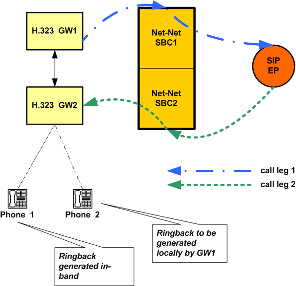

When interworking SIP and H.323 to a gateway, PSTN gateway, or other endpoint, the Oracle Enterprise Session Border Controller uses the mappings shown in the table below. The absence or presence of SDP in the SIP provisional message determines whether the tones are generated in-band or locally.
For each of the mappings listed in the following table, this section provides a sample call flow.
SIP Message H.323 Message
No Message CallProceeding
No Message Progress without PI
183 with SDP Progress with PI
180 w/o SDP Alert without PI
180 with SDP Alert with PI

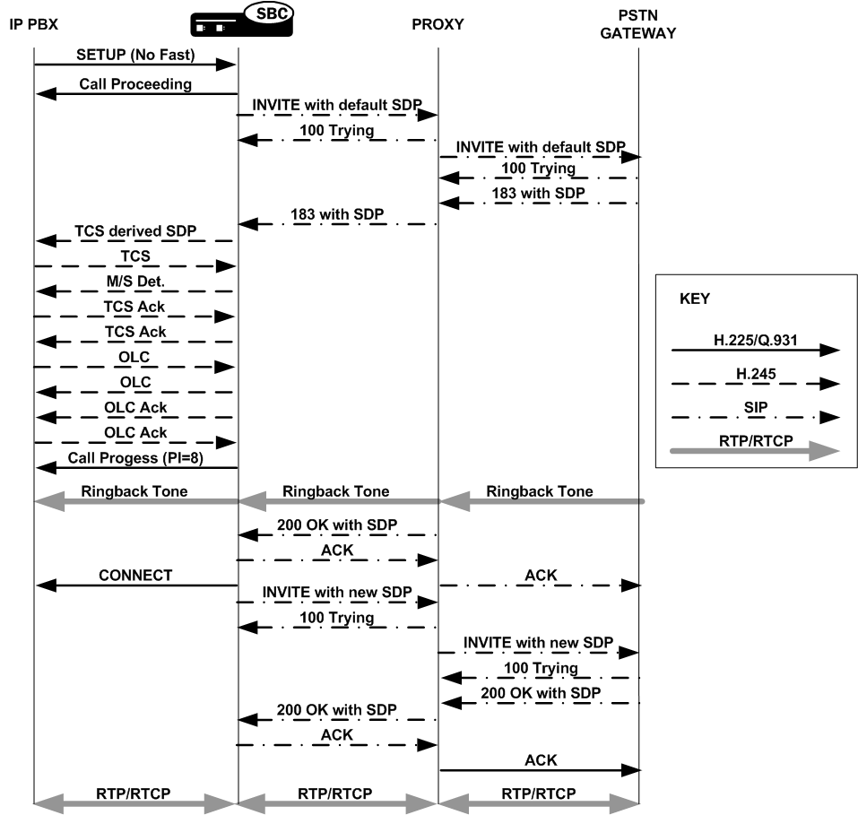

In the following diagram, a call that requires the IWF passes through the Oracle Enterprise Session Border Controller twice, creating two call legs. The call originates from H.323 GW1 and terminates in Phone 1 or Phone 2.
The IWF Ringback diagram is described above.

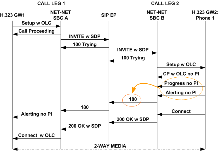

Sample 1 In-band Ringback without Progress Message
This sample flow shows how the Oracle Enterprise Session Border Controller handles a call that requires the IWF where there is no progress message. In this call flow, there is a progress indicator of eight (8), meaning that ringback is in-band.
In this diagram, you can see that the Oracle Enterprise Session Border Controller maps the progress indicator included in the Alerting message sent from Phone 1 through H.323 GW2 to a SIP 180 message with SDP. When the Progress message appears, it contains the progress indicator rather than the Alerting message containing it.
The In-Band Ringback without Progress Message call flow is described above.

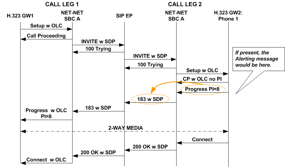

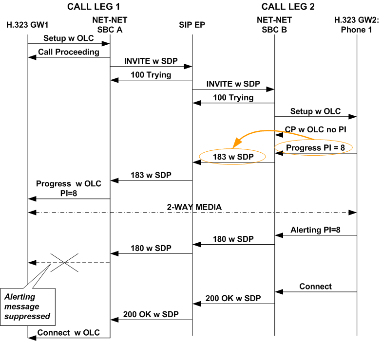

Sample 2 In-band Ringback with Progress Message
This sample flow shows how the Oracle Enterprise Session Border Controller handles a call that requires the IWF where there is a progress message. In this call flow, there is a progress indicator of eight (8), meaning that ringback is in-band.
For this call flow, you can see again that the Oracle Enterprise Session Border Controller maps the progress indicator included in the alerting message sent from Phone 1 through H.323 GW2 to a SIP 180 message with SDP. Note that now the Progress message contains the progress indicator.
The In-Band Ringback with Progress Message call flow is described above.

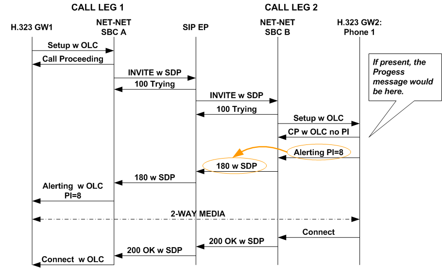

Sample 3 In-band Ringback without Alerting Message
In this diagram, you can see that the Oracle Enterprise Session Border Controller maps the progress indicator included in the Progress message sent from Phone 1 through H.323 GW2 to a SIP 180 message with SDP. When the Alerting message appears, it contains the progress indicator rather than the Progress message containing it.
The In-Band Ringback without Alerting Message call flow is described above.

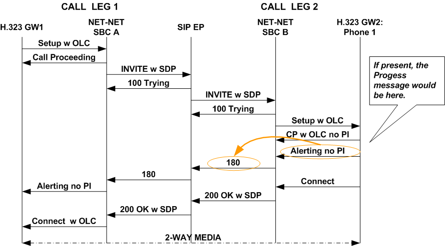

Sample 4 Out-of-band Ringback without Progress Message
When there is no progress indicator included in the Alerting message, then there is out-of-band ringback. The system maps the Alerting message to a SIP 180, but it it does not include SDP in the SIP 180. This call flow shows that there is no Progress message and that media cannot be set up until after H.323 Connect and SIP messages are sent.
The Out-of-Band Ringback without Progress Message call flow is described above.

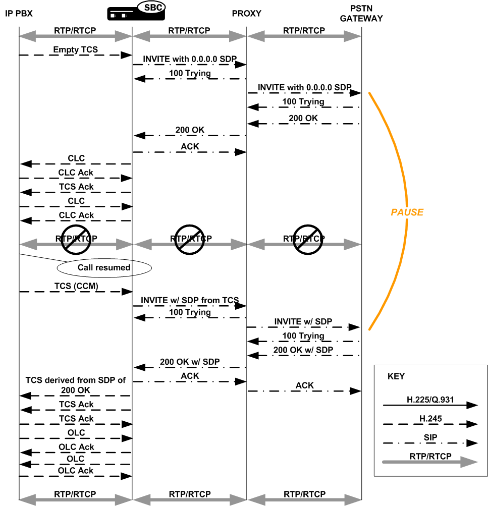

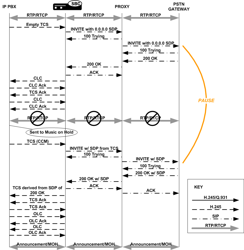

Hold
This sample call flow assumes that the IWF call is established and that the RTP/RTCP flow is already in progress. The hold button is pushed, and IP PBX A sends an empty TCS to the Oracle Enterprise Session Border Controller . The Oracle Enterprise Session Border Controller puts the called party on hold by sending an INVITE message with 0.0.0.0 SDP to the SIP side of the call. Using 0.0.0.0 as the media address effectively stops the media flow. This INVITE is acknowledged, and the Oracle Enterprise Session Border Controller closes the channels on the H.323 side, halting the RTP/RTCP flow.
When the caller on the H.323 side takes the call off hold, it resumes with a TCS that the Oracle Enterprise Session Border Controller receives and then translates on the SIP side as an INVITE with SDP. After that INVITE is acknowledged and received, the Oracle Enterprise Session Border Controller opens logical channels on the H.323 side and RTP/RTCP flows resume.
The IWF Hold call flow is described above.
Music On Hold
This scenario is similar to the hold feature enabled for calls that require the IWF, except that after the RTP/RTCP flow between the H.323 and SIP sides stops, the call is sent to music on hold. Before the announcement or music plays, the Enterprise SBC sets up the necessary support for media to be exchanged.
Supporting music on hold within H.323 IWF.

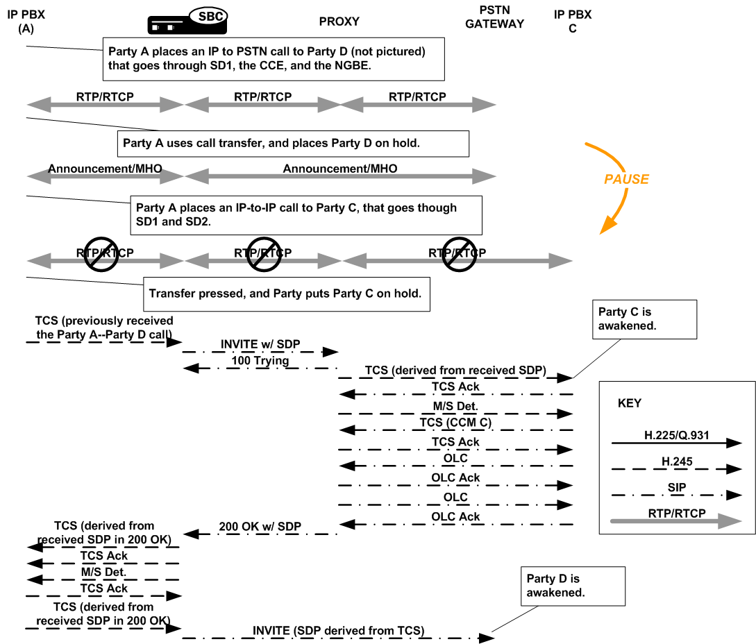

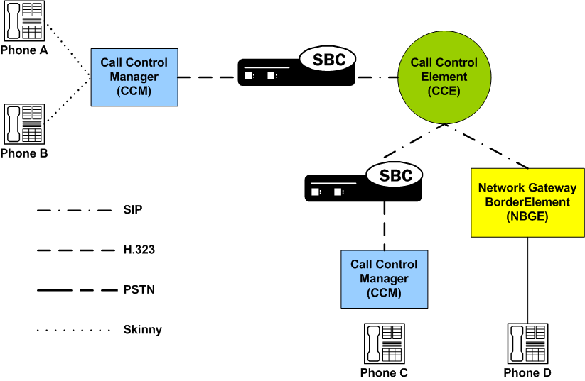

Transfer
The call flow described in this section recalls the diagram at the top of the H.323 Endpoint-Originated Call Hold and Transfer section, where endpoints A, B, and C are H.323 devices and endpoint D is a SIP device. When you follow the signaling and media flows, note that there are two Oracle Enterprise Session Border Controller s in the call transfer and two sets of SIP/H.323 translations that take place. The first Oracle Enterprise Session Border Controller translates H.323 to SIP, and the second performs the same operations with the protocols reversed.
In the scenario pictured, Party A is on a call with Party D, but wants to transfer Party C to Party D. Party A places Party D on hold, and then makes the call to Party C. Party A then puts Party C on hold, pressing the transfer button. You can see that Oracle Enterprise Session Border Controller 1 receives a TCS from the IP PBX, which is then translated to SIP. Oracle Enterprise Session Border Controller 2 receives it, performs the required protocol translations, and then opens a session with Party C via another IP PBX. Once this session is up and Party D is awakened, channels are established for media exchange.
In order to redirect the media so that it flows between Party C and Party D, the Oracle Enterprise Session Border Controller 1 and IP PBX C exchange OLC and OLC Ack messages that contain address information for Party C and for Party D. Address information for both parties is contained in the OLC Ack messages that the Oracle Enterprise Session Border Controller exchanges with the IP PBX. IP PBX A does not move forward with the call until it has the necessary address information.
Even though Party A’s participation in the call stops early in this scenario, the IP PBX with which it is associated keeps the signaling sessions with the Oracle Enterprise Session Border Controller alive to manage the transfer.
The IWF Transfer call flow is described above.

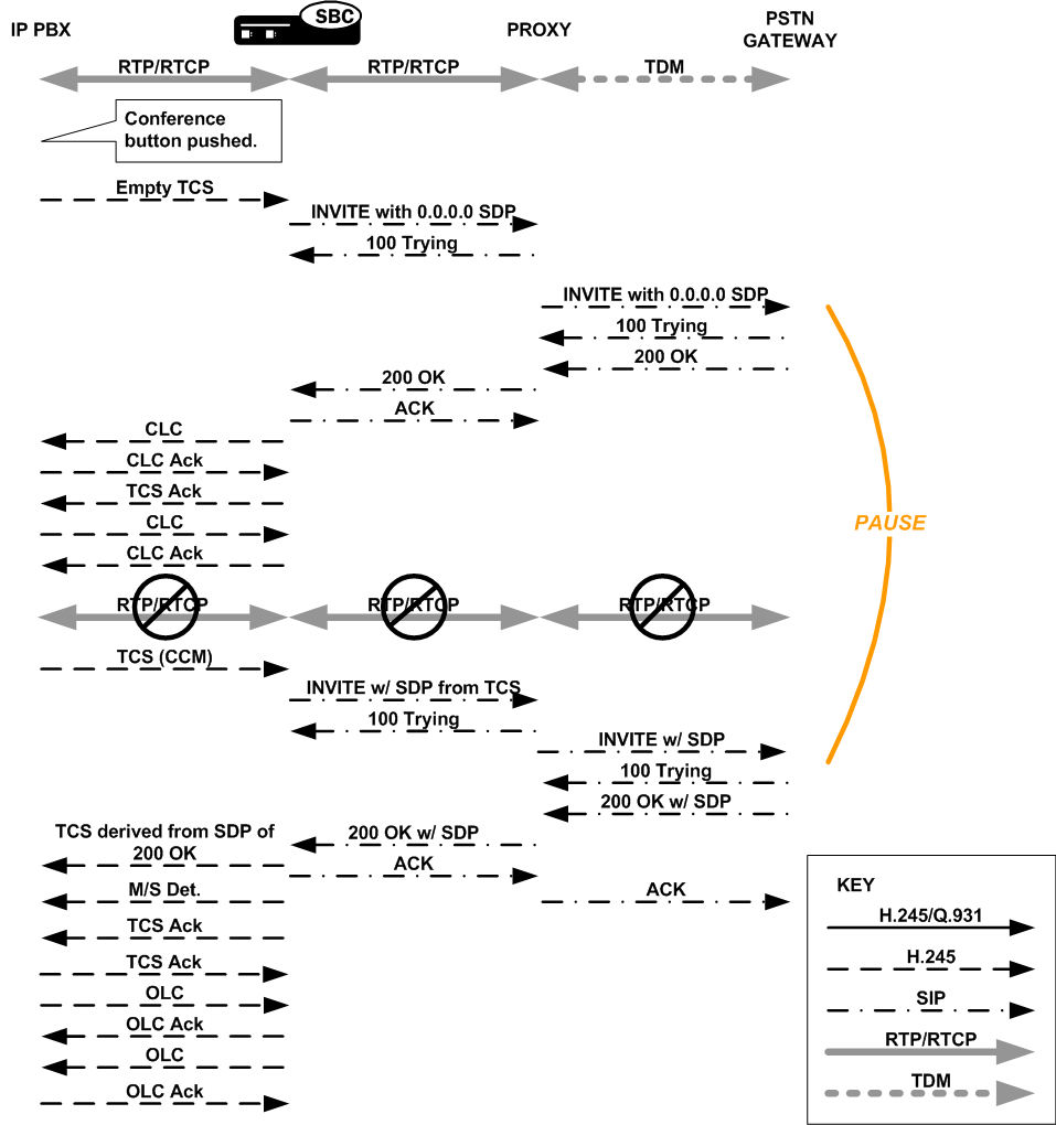

Conference
To conference a call that requires the IWF that starts in H.323, the Enterprise SBC uses a scenario much like the one used for holding a call that requires the IWF. Here again, the INVITE with 0.0.0.0 as the media address and the closing of logical channels stops the flow of RTP/RTCP. After signaling and SDP/media information are re-established, RTP/RTCP for the conference flows.
The Enterprise SBC supporting a conference call within H.323 IWF.

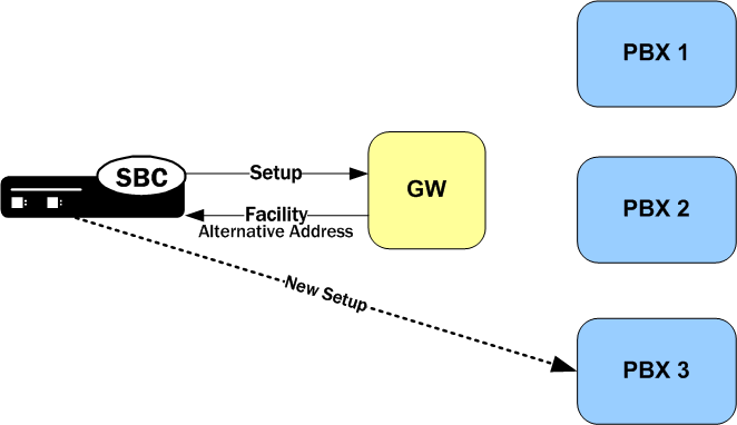

IWF Call Forwarding
This section describes the Oracle Enterprise Session Border Controller ’s IWF Call Forwarding feature, which is supported for calls initiated in SIP that require interworking to H.323.
Prior to the implementation of this feature, the Oracle Enterprise Session Border Controller did not forward calls when the remote H.323 endpoint sent a Facility message with Call deflection as the reason and an alternate address for forwarding. Instead, it would either:
  • Fail to release the initial call and initiate the forwarded call
  • Drop the entire call when the remote endpoint for the call tore down the session
New Behavior
In the diagram below, you can see that the Oracle Enterprise Session Border Controller sends the initial Setup message to the gateway, and the gateway returns the Facility message with an alternate address for forwarding. Rather than engaging in its former behavior, the Oracle Enterprise Session Border Controller now releases the call with the gateway and sends a new Setup to the alternate address from the Facility message.
This new Setup up has no effect on the first call leg, which remains connected.
The IWF Call Forwarding diagram is described above.
When it receives a Facility message with the reason CallForwarded, the Oracle Enterprise Session Border Controller looks for an alternate transport address in the Facility’s alternativeAddress or alternativeAliasAddress element. The Oracle Enterprise Session Border Controller releases the egress call with the reason facilityCallDeflection. Then it takes one of two courses of action:
  • If it does not find an alternative address, the Oracle Enterprise Session Border Controller releases the ingress call (with 486 BUSY HERE for a call being interworked from SIP to H.323).
If it finds an alternative address and the egress call has not been alerted or answered, the Oracle Enterprise Session Border Controller at this point tries to initiate a new egress call. The Oracle Enterprise Session Border Controller uses the alternative alias address to populate the calledPartyNumber information element (IE) and the destination address of the new Setup.
