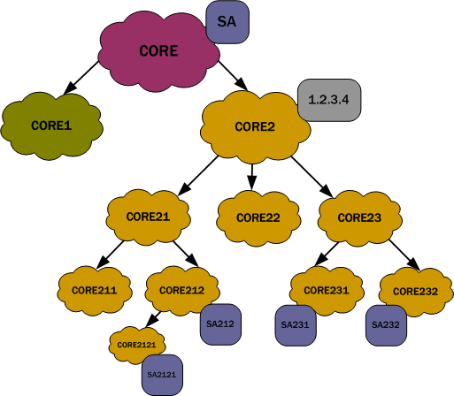

The following diagram shows the realm tree, where the clouds are realms and squares are session agents, representing a group of session agents sharing the IP address 1.2.3.4. The Oracle Enterprise Session Border Controller searches for the session agents lower in the tree along the session agent realm-path and the desired realm.
The Local Policy Session Agent Matching for SIP diagram is described above.
For the diagram above, the following shows how the hostname would look for this group of session agents.
Key Session Agent (hostname[realm])
1.2.3.4
(This session agent owns the primary key for the IP address because its hostname is the IP address.)
1.2.3.4[CORE2]
1.2.3.4:CORE
(IP+realm key entry)
SA[CORE]
1.2.3.4:CORE
1.2.3.4[CORE2]
1.2.3.4:CORE212
SA212[CORE212]
1.2.3.4:CORE2121
SA2121[CORE2121]
1.2.3.4:CORE231
SA231[CORE231]
1.2.3.4:CORE232
SA232[CORE232]
1.2.3.4:CORE:
(IP+realm-path key entry)
SA[CORE]
1.2.3.4:CORE:CORE2:
1.2.3.4[CORE2]
1.2.3.4:CORE2:CORE21:CORE212
SA212[CORE212]
1.2.3.4:CORE2:CORE21:CORE212:CORE2121
SA2121[CORE2121]
1.2.3.4:CORE2:CORE23:CORE231
SA231[CORE231]
1.2.3.4:CORE2:CORE23:CORE232
SA232[CORE232]
For each realm in the table above, the search results for each realm would look like this:
IP Address Realm Session Agent (hostname[realm])
1.2.3.4 CORE SA[CORE]
1.2.3.4 CORE2 1.2.3.4[CORE2]
1.2.3.4 CORE21 SA212[CORE212[
1.2.3.4 CORE211 1.2.3.4[CORE2]
1.2.3.4 CORE212 SA212[CORE212]
1.2.3.4 CORE2121 SA2121[CORE2121]
1.2.3.4 CORE22 1.2.3.4[CORE2]
1.2.3.4 CORE23 1.2.3.4[CORE2]
1.2.3.4 CORE231 SA231[CORE231]
1.2.3.4 CORE232 SA232[CORE232]
