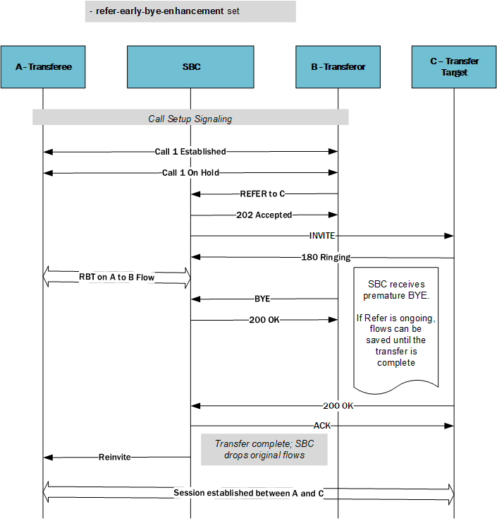

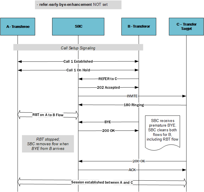

This first scenario is a simple transfer scenarios. Upon receiving a BYE from user agent, the Enterprise SBC performs its default behavior, which includes the system stopping the RBT and clearing the flow on both sides. This drops the flow from the Enterprise SBC to A even though it is busy supporting an RBT media flow.
When you set the refer-early-bye-enhancement option, the Enterprise SBC does not tear down the flow during this blind/attended (Invite) transfer because it detects a pending REFER. Instead, the Enterprise SBC maintains the flow until the transfer is complete or it receives a 200OK from B.

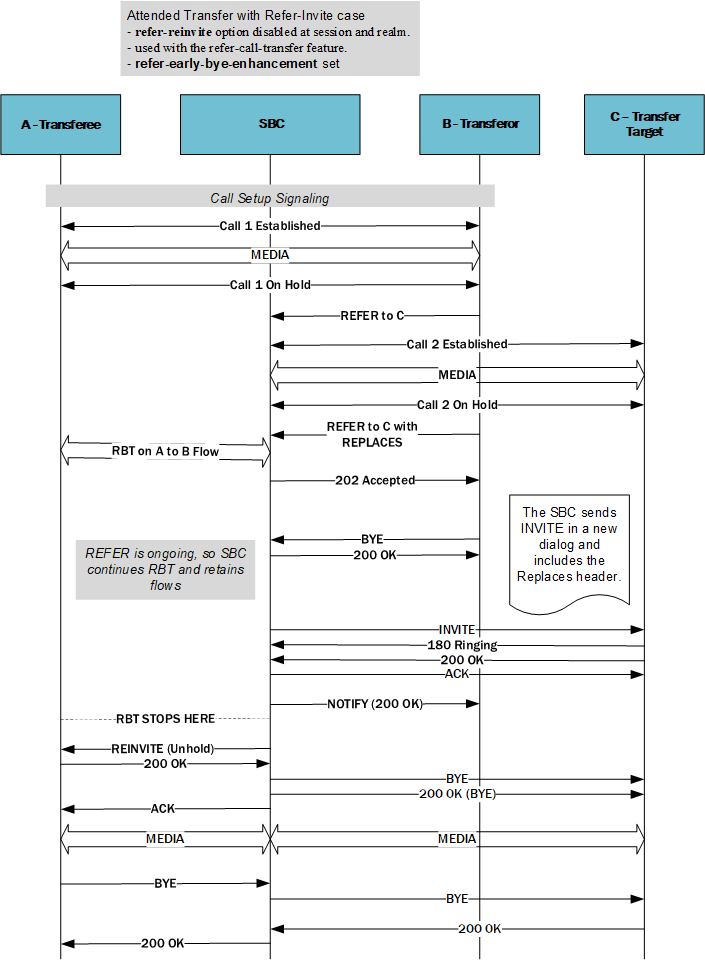

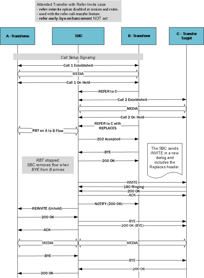

This scenario depicts the Enterprise SBC supporting an attended Transfer with Refer-Invite case. You have left the refer-reinvite option disabled at the session and realm. Here, the Enterprise SBC sends an INVITE in a new dialog and includes the Replaces header. This is used in conjunction with the refer-call-transfer feature
Again, because you have set the refer-early-bye-enhancement option, the Enterprise SBC does not tear down the flow during this attended Transfer with Refer-Invite case because it detects a pending REFER. Instead, the Enterprise SBC maintains the flow until after it sends a NOTIFY (200 OK) to B confirming the transfer is complete.
