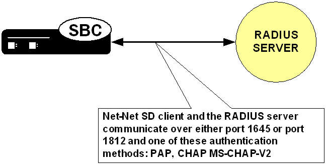

After it selects a RADIUS server, the Enterprise SBC initiates communication and proceeds with the authentication process. The authentication process between the Enterprise SBC and the RADIUS server takes place using one of three methods, all of which are defined by RFCs:
Protocol RFC
PAP (Password Authentication Protocol) B. Lloyd and W. Simpson, PPP Authentication Protocols, RFC 1334, October 1992
CHAP (Challenge Handshake Authentication Protocol) B. Lloyd and W. Simpson, PPP Authentication Protocols, RFC 1334, October 1992
W. Simpson, PPP Challenge Handshake Authentication Protocol (CHAP), RFC 1994, August 1996
MS-CHAP-V2 G. Zorn, Microsoft PPP CHAP Extensions, Version 2, RFC 2759, January 2000
MS-CHAP-V2 support includes authentication only; password exchange is not supported or allowed on the Enterprise SBC.
Illustration of SBC and RADIUS server communications.
PAP Handshake
