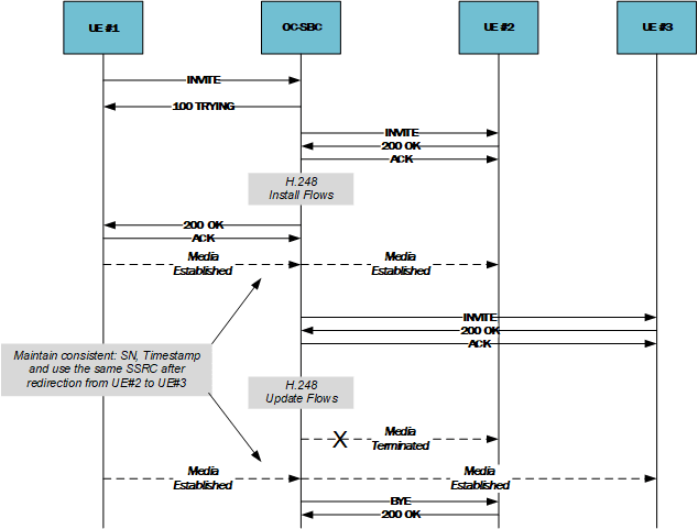

A common cause for SSRC changes is call transfer. The diagram below depicts a transfer from UE #2 to US #3. The call transfer creates an SSRC change that the administrator has determined may not be accepted by UE #3. By configuring HMU on the egress realm, the administrator prevents these changes from causing the call to fail.
This figure shows the Enterprise SBC managing call termination changes with HMU
The HMU function operates on traffic at the egress realm. The Enterprise SBC evaluates SSRC changes when the traffic reaches the egress interface and corrects RTP data before it egresses the Enterprise SBC. You may determine that the Enterprise SBC needs to hide media changes from one realm only. If you are not configuring bi-directional HMU monitoring, refer to the following table to understand where to apply your HMU configuration.
