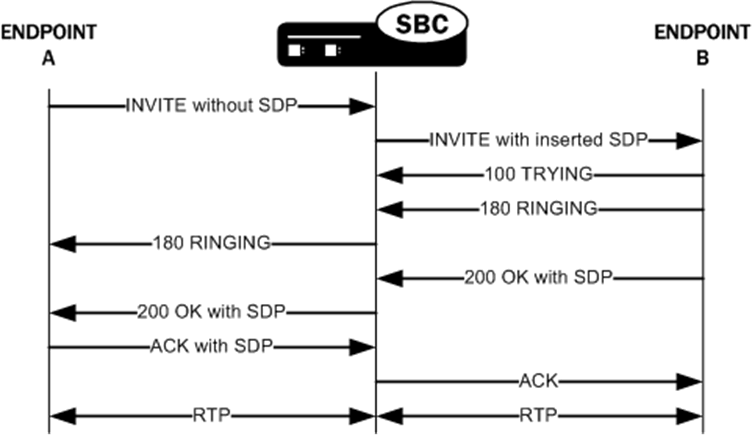

SDP Insertion for SIP INVITES
With the parameters mentioned above appropriately configured, the Enterprise SBC inserts SDP into an outgoing INVITE when the corresponding incoming INVITE has none. Because no SDP information is available for the session, the Enterprise SBC uses a media profile from a list of them you configure and then apply for SDP insertion.
The Enterprise SBC inserting SDP for a SIP INVITE.
