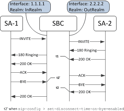

Call Duration Calculation
Call duration is calculated as the time between (t1) when the Enterprise SBC receives the 200OK for the INVITE from terminating endpoint, and (t2) the time when Enterprise SBC receives the final 200OK for the BYE message from terminating endpoint, regardless of whether media is released. If the set-disconnect-time-on-bye parameter is enabled in the sip-config, then the call termination time (t2') is when the Enterprise SBC receives the BYE message originally from the endpoint ending the call.
Figure 4-1 Call Duration Calculation Example - Ladder Diagram
Example ladder diagram showing times used for calculating call durations. Refer to previous paragraph for description of call flow, refer to next table for calculating call durations from various system perscpectives on the SBC.
Table 4-1 Call Duration Calculation Example - Results
Element Inbound Duration (sec) Outbound Duration (sec)
Session Agent: SA-1 t2 - t1 0
Session Agent: SA-2 0 t2 - t1
Realm: InRealm t2 - t1 0
Ream: OutRealm 0 t2 - t1
Interface: 1.1.1.1 t2 - t1 0
Interface: 2.2.2.2 0 t2 - t1
The global system call duration for the previous example is t2' - t1 seconds if the set-disconnect-time-on-bye parameter is enabled.

  21. trans-expire—Set the TTL expiration timer in seconds for SIP transactions. This timer controls the following timers specified in RFC 3261:
    • Timer B—SIP INVITE transaction timeout
    • Timer F—non-INVITE transaction timeout
    • Timer H—Wait time for ACK receipt
    • Timer TEE—Used to transmit final responses before receiving an ACK
      The default is 0. If you leave this parameter set to the default, then the Oracle Enterprise Session Border Controller uses the timer value from the global SIP configuration. The valid range is:
    • Minimum—0
    • Maximum—2147473
