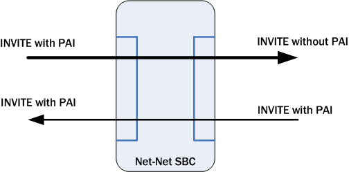

  • SIP PAI header stripping enabled for an untrusted realm—If the PAI stripping parameter is set to enabled in a realm that is untrusted, then the Oracle Enterprise Session Border Controller strips the PAI headers from SIP INVITEs that are received from the external address, regardless of the privacy type. The Oracle Enterprise Session Border Controller then sends the modified INVITE (without the PAI). If the INVITE comes from a trusted realm, then the Oracle Enterprise Session Border Controller does not strip the PAI header and the system behaves as it does when you are using previous 1.3.1 releases.
The SIP PAI Header Stripping diagram is described above.

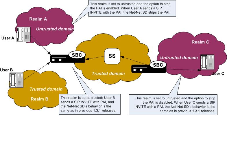

  • Oracle Enterprise Session Border Controller behavior bridging trusted and untrusted realms—The following graphics shows you how Oracle Enterprise Session Border Controllers can be positioned and configured to handle PAI stripping between trusted and untrusted realms.
This image shows PAI stripping between trusted and untrusted realms.
Realm Configuration Settings REALM A REALM B REALM C
Realm designation trusted or untrusted
(trust-me)
Disabled Enabled Enabled
SIP PAI stripping (pai-strip) Enabled Enabled or disabled Disabled
SBC’s behavior Strip PAI regardless of privacy type Same as behavior for SIP privacy support in previous 1.3.1 releases Same as behavior for SIP privacy support in previous 1.3.1 releases
