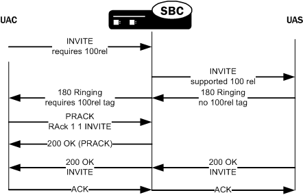

UAC-Side PRACK Interworking
The Oracle Enterprise Session Border Controller applies PRACK interworking on the UAC side when:
  • An incoming SIP INVITE contains the 100rel tag in a Require header
  • The ingress SIP interface is enabled with the 100rel-interworking option
  • The UAS fails to send reliable provisional responses
When it is to forward a non-reliable response to a UAC that requires RFC 3262 support, the Oracle Enterprise Session Border Controller converts the non-reliable response to a reliable one by adding the 100rel tag to the Require header and adding an Rseq header to the response. Further, the Oracle Enterprise Session Border Controller adds a Require header (complete with the100rel tag) if there is not one already in the response, and then also adds Rseq header.
Note that the Oracle Enterprise Session Border Controller sets the value of the Rseq header as 1 for the first provisional response, and then increments it by 1 for each subsequent provisional response. It also adds the PRACK method to the Allow header when that header appears.
The Oracle Enterprise Session Border Controller retransmits the converted reliable provisional response in accordance with RFC 3262, until it receives a PRACK request. For the initial timeout for retransmission, the Oracle Enterprise Session Border Controller uses the value you set in the init-timer parameter in the global SIP configuration. It stops retransmitting when either it receives a transmission, or when the ingress SIP interface’s trans-expire timer elapses.
If it never receives a PRACK, the Oracle Enterprise Session Border Controller does not generate an error response to the INVITE, relying instead on the downstream UAS to produce a final response.
The call flow for this application looks like this:
Call flow depicting UAC side PRACK interworking.

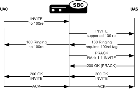

UAS-Side PRACK Interworking
The Oracle Enterprise Session Border Controller applies PRACK interworking on the UAS side when:
  • An incoming SIP INVITE does not contain the 100rel tag in a Require or Supported header
  • The egress SIP interface is enabled with the 100rel-interworking option
  • The UAS does send reliable provisional responses
When the UAC does not support RFC 3262, the Oracle Enterprise Session Border Controller generates a PRACK request to acknowledge the response. It also converts the response to non-reliable by removing the 100 rel tag from the Require header and removing the RSeq header from the response.
In the case of the UAS, the Oracle Enterprise Session Border Controller matches the PRACK to a converted reliable provisional response using the PRACK’s RAck header. If it finds a matching response, the Oracle Enterprise Session Border Controller generates a 200 OK to the PRACK. And if it finds no match, then it generates a 481 Call Leg/Transaction Does Not Exist response. The Oracle Enterprise Session Border Controller generates a 400 Bad Request response if either the RAck is not in the PRACK request or it is not formatted properly.
Call flow depicting UAS side PRACK interworking.
