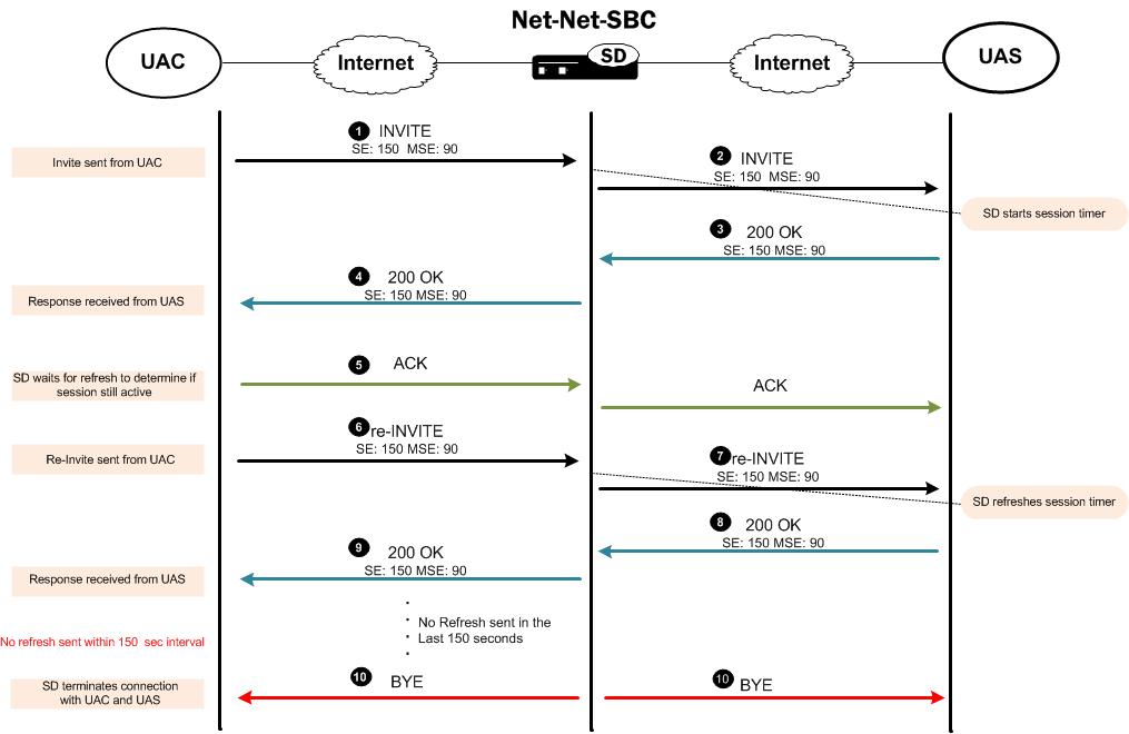

If the Enterprise SBC receives an INVITE from the UAC with a Session-Expires header, it starts a new session timer, or refreshes an existing session timer and then forwards the INVITE to the UAS. The subsequent 2xx Responses and re-INVITES also include the session timer intervals. If the Enterprise SBC does not receive a session refresh within the time specified in the session timer interval, the session timer expires, and the Enterprise SBC terminates the session between the UAC and the UAS.
The following occurs when you enable the session timer feature on the Enterprise SBC:
  1. The UAC sends an INVITE to the Enterprise SBC with the SE and min-SE values (session timer interval). The Enterprise SBC starts a session timer.
  2. The Enterprise SBC forwards the INVITE to the User Agent Server (UAS) with the same values.
  3. The UAS sends the 200 OK Response to the Enterprise SBC with the session interval values.
  4. The Enterprise SBC forwards the Response to the UAC.
  5. The UAC sends an ACK (Acknowledge) to theEnterprise SBC, and the Enterprise SBC forwards the ACK to the UAS.
  6. The UAC sends out a re-INVITE (Session Refresh Request) to the Enterprise SBC with the session interval values. The Enterprise SBC refreshes the session timer.
  7. The Enterprise SBC forwards the re-INVITE to the UAS.
  8. The UAS sends the 200 OK response to the Enterprise SBC with the session interval values.
  9. The Enterprise SBC sends the 200 OK response to the UAC.
  10. If the Enterprise SBC does not receive a Response within the session interval (150 seconds in the following illustration), the timer expires, and the Enterprise SBC terminates the session between the UAC and the UAS. The following illustration shows an example of a dialog between the UAC, the Enterprise SBC, and the UAS during an active session.
    The Enterprise SBC using the session timer to terminate a session.
    When the Enterprise SBC terminates a session it sends a BYE to both the ingress and egress call legs. If accounting is configured, the Enterprise SBC also sends a RADIUS stop record with Acct-Terminate-Cause = Session-Timeout. You can enable or disable the use of the session timers using the ACLI interface at session-router, sip-config, options.
