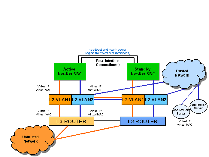

HA Node Connections
To use High Availability (HA), you must establish Layer 2 and Layer 3 networks that interconnect two Oracle® Enterprise Session Border Controllers (Enterprise SBC) and support HA with the required physical network connections. The basic network set-up in the following diagram shows an HA node deployment where each system is connected to its own Layer 2 switch. This set-up provides a measure of added redundancy in the event that one of the switches fails.
Here, the active system is using the virtual MAC and IP addresses.
The HA Node Connection diagram is described above.

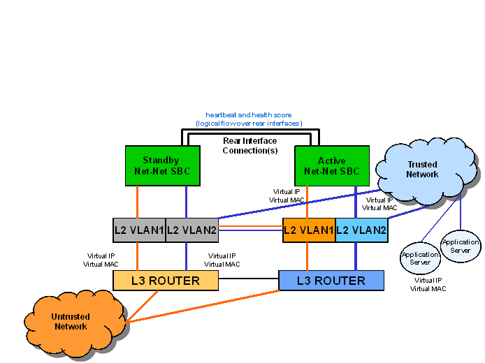

In the second diagram, the same network is shown with the HA node having experienced a switchover. The previously standby Enterprise SBC has taken over the active role in the HA node and is using the virtual IP and MAC addresses.
The HA Node Connections Switchover diagram is described above.
