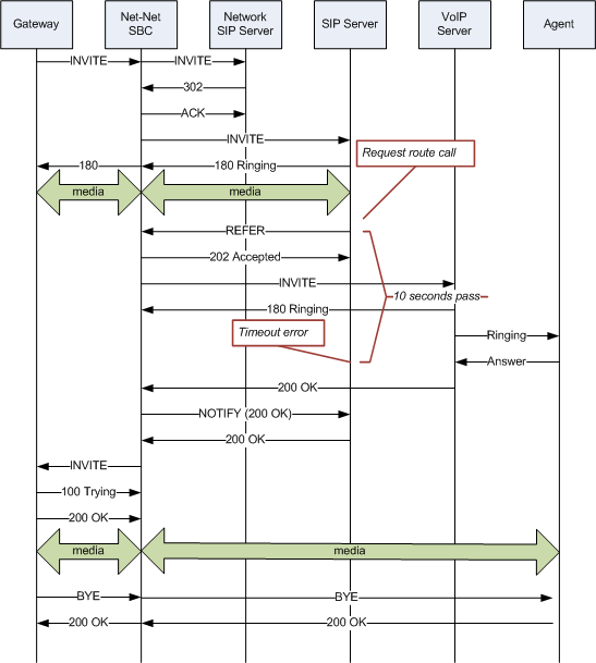

Basic Scenario
In the basic scenario for REFER initiated call transfer, a call is established between two User Agents (Alice and Bob). User Agent Bob then sends a REFER request to transfer the call to a third User Agent Eva. With dynamic call-transfer enabled, the Oracle® Enterprise Session Border Controller (Enterprise SBC) prevents the REFER from being sent to Alice and generates the INVITE to Eva.
If the INVITE to Eva succeeds, the Enterprise SBC sends a re-INVITE to Alice modifying the SIP session as described in Section 14 of RFC 3261, SIP: Session Initiation Protocol. At this point the Enterprise SBC cancels the original dialog between the Enterprise SBC and Bob.
If the INVITE to Eva fails, call disposition depends on whether or not Bob issued a BYE after the REFER call transfer. If the Enterprise SBC did receive a BYE from Bob (for instance, a blind transfer), it proxies the BYE to Alice. Otherwise, the Enterprise SBC retains the original SIP session and media session, thus allowing Bob to re-establish the call with Alice by sending a re-INVITE. In this case, the Enterprise SBC sets a timer (32 seconds), after which it will send a BYE.

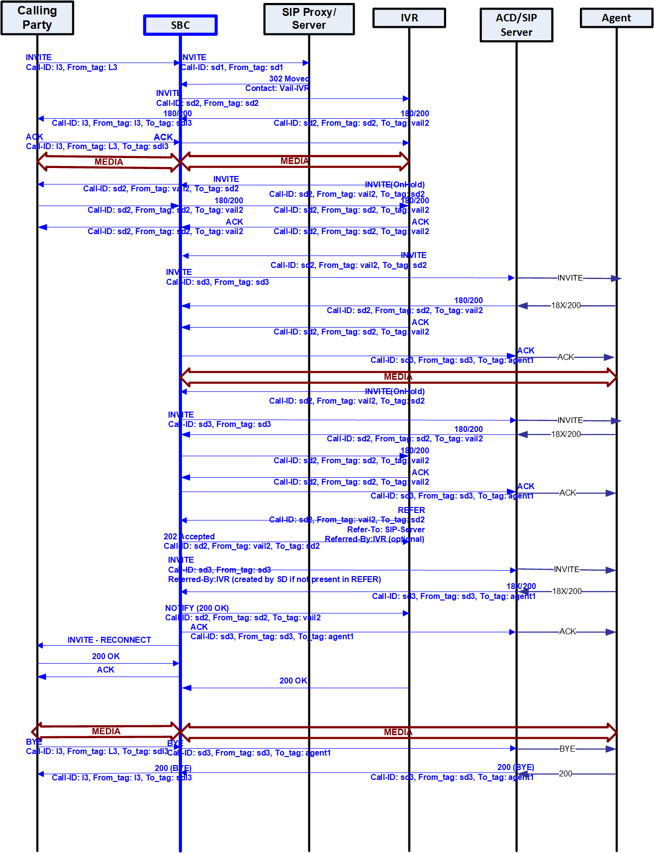

The following is an example call flow for an unattended call transfer:
An example of a call flow for an unattended call transfer.

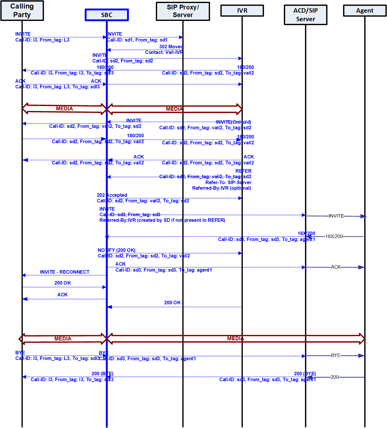

The following is an example call flow of an attended call transfer:
An example of a call flow for an attended call transfer.

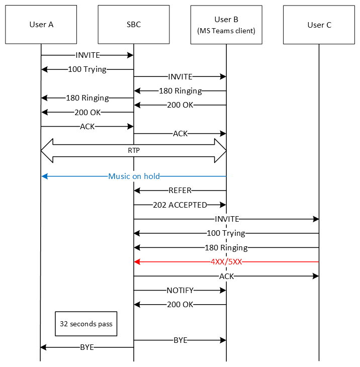

Continuing Calls in Failed REFER Call Transfers
When a REFER call transfer fails, you can configure whether the Enterprise SBC ends the original call automatically, or lets it continue.
By default, when a REFER call transfer fails for unattended transfers or attended transfers where Enterprise SBC issues a new INVITE rather than a reINVITE, the Enterprise SBC waits 32 seconds, and then ends the original call.
However, some Advanced Media Termination clients, such as Microsoft Teams, play music on hold (MoH) while transferring calls, during which no signaling updates are sent to the recipient or the Enterprise SBC (this is music sent directly from the client, different from the local media playback configuration for REFER on the Enterprise SBC). If the transfer fails, and the original caller resumes the call with the original recipient, the Enterprise SBC is not aware of any signaling updates or that the original call has resumed, and ends the call after 32 seconds.
To ignore the 32 second timer after a failed transfer and continue the original call, you can enable the refer-fail-resume parameter on the realm-config. Instead of automatically ending the original call after 32 seconds, the Enterprise SBC allows the call to continue and it ends as normal: when either side sends a BYE, when the session-timer for the original call elapses, or when the subsq-guard-timer for RTP configured for the realm elapses, whichever happens first.
Call Flows

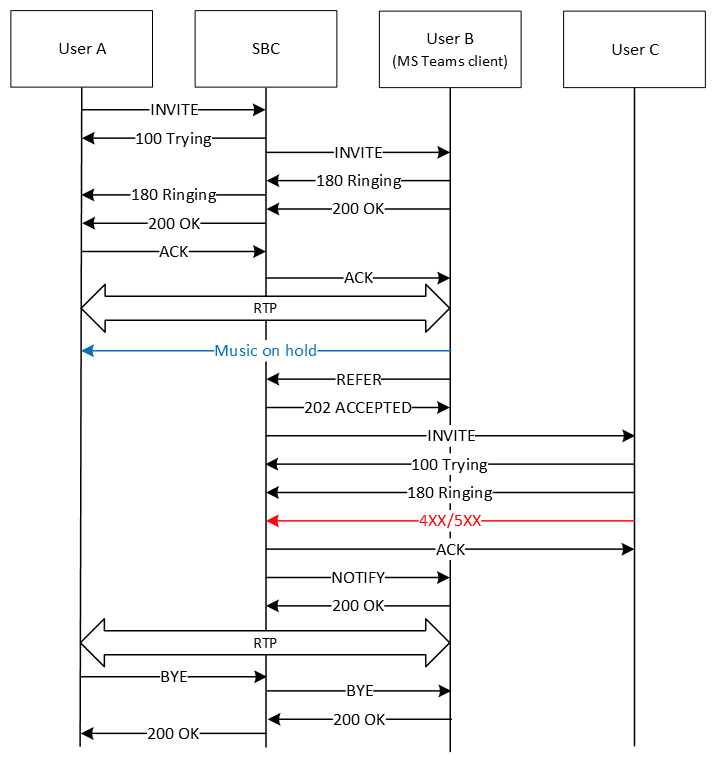

The following image shows the default unattended referral call flow, when refer-fail-resume is disabled, and the referring user is an Advanced Media Termination client. In this flow, a call between User A and User B is established, then User B plays music on hold for User A while referring the call to User C. The referral fails with a 4XX or 5XX response, and the Enterprise SBC notifies User B. Because the Enterprise SBC does not see any further signaling updates in 32 seconds, it ends the call.
The image shows the default flow, with the call dropped after 32 seconds.
The following image shows the same call flow as above, but with refer-fail-resume enabled. In this flow, after notifying User B of the failed referral, the Enterprise SBC does not end the original call between User A and User B.
The image shows the unattended call flow with refer-fail-resume enabled.
A similar flow applies when refer-fail-resume is enabled in the following unattended referral situations:

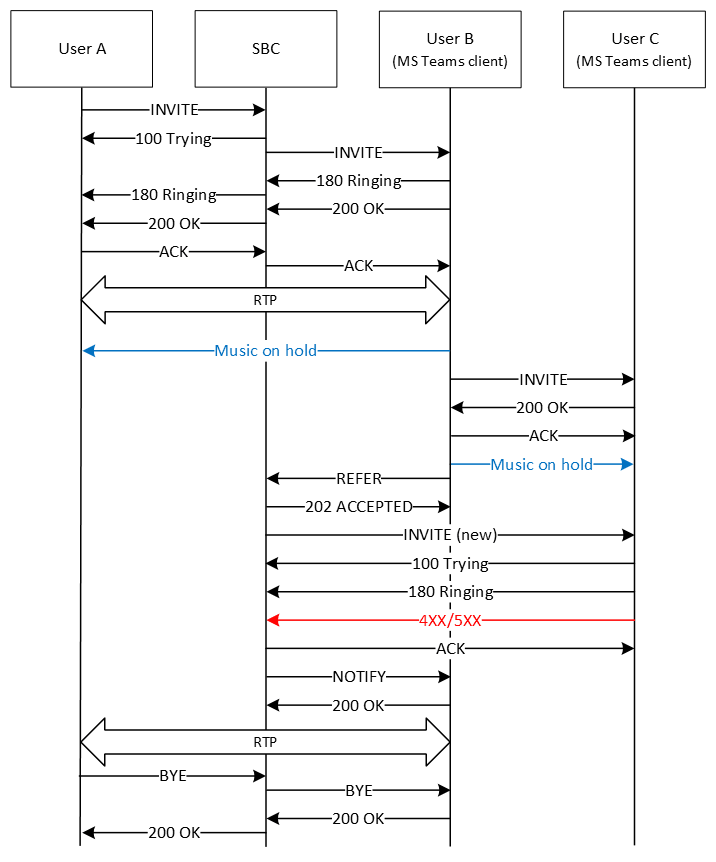

The following image shows the attended referral call flow, when refer-fail-resume is enabled, and the Enterprise SBC issues a new INVITE to begin the referral.
In this flow, a call between User A and User B is established, then User B makes an attended referral to User C, sending an INVITE and reINVITE for the hold directly to User C. These succeed, and User B sends the REFER to the Enterprise SBC. The Enterprise SBC issues a new INVITE (rather than a reINVITE) to User C to establish the referral, and this fails with a 4XX or 5XX response. The Enterprise SBC notifies User B, and the original call between User A and User B resumes.
The image shows the attended call flow with refer-fail-resume enabled.
If refer-fail-resume were disabled in the previous flow, the Enterprise SBC would end the call after 32 seconds.
In scenarios where the Enterprise SBC instead issues a reINVITE to establish the referral, and that fails, the Enterprise SBC does not end the call, regardless of the refer-fail-resume setting.

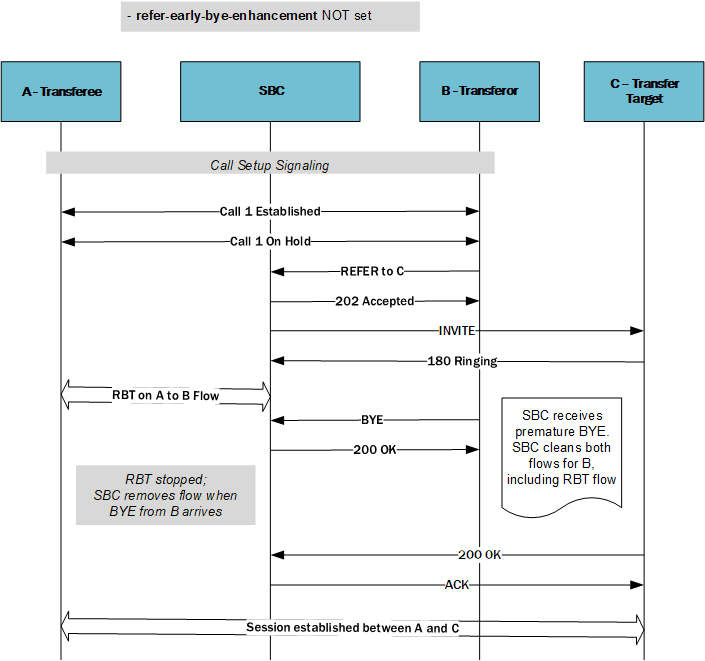

The following call flows depict the Enterprise SBC attempting to handle RBT during refer scenarios. These images include two scenarios wherein the system does not support, and then does support RBT through the refer processing.
This first scenario is a simple transfer scenarios. Upon receiving a BYE from user agent, the Enterprise SBC performs its default behavior, which includes the system stopping the RBT and clearing the flow on both sides. This drops the flow from the Enterprise SBC to A even though it is busy supporting an RBT media flow.
This image depicts the system dropping the RBT flow after receiving a BYE from the transferor.

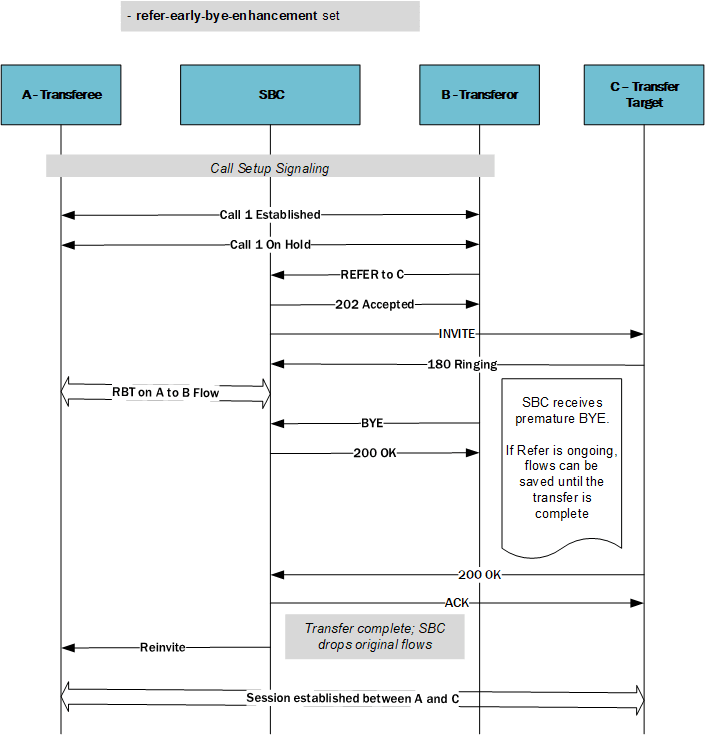

When you set the refer-early-bye-enhancement option, the Enterprise SBC does not tear down the flow during this blind/attended (Invite) transfer because it detects a pending REFER. Instead, the Enterprise SBC maintains the flow until the transfer is complete or it receives a 200OK from B.
This image depicts the system successfully supporting the RBT flow in this blind attended transfer even though it has received a BYE from the transferor.

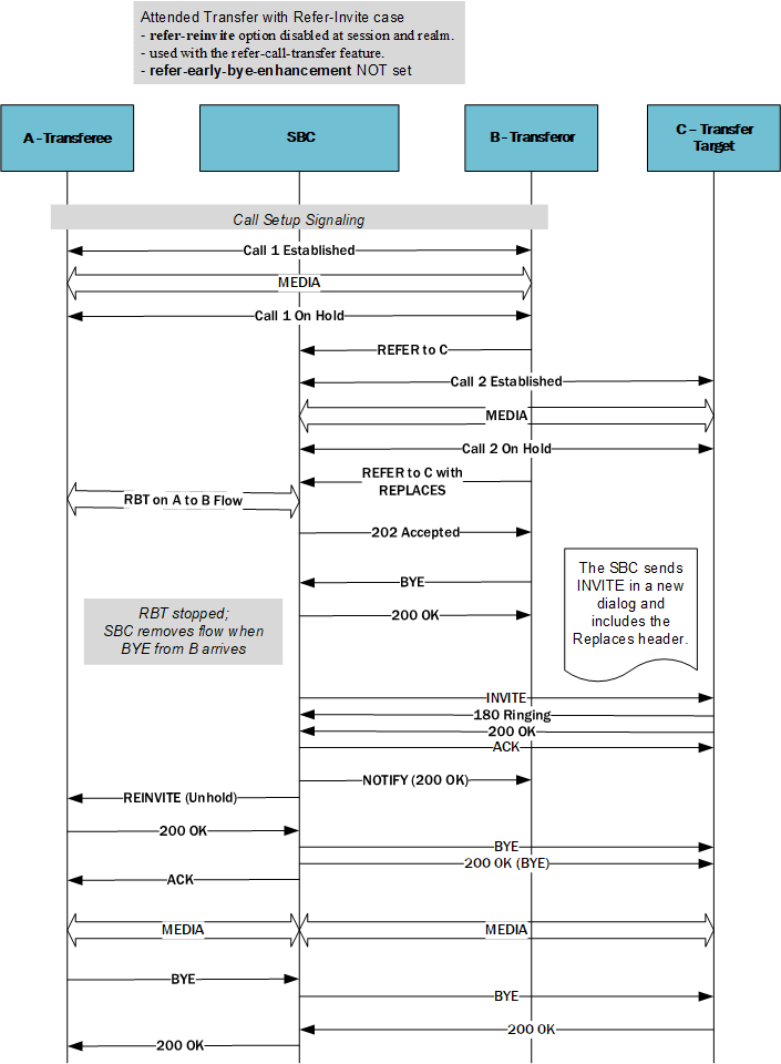

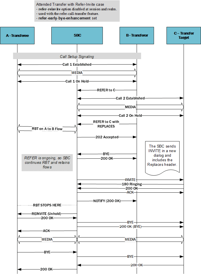

This scenario depicts the Enterprise SBC supporting an attended Transfer with Refer-Invite case. You have left the refer-reinvite option disabled at the session and realm. Here, the Enterprise SBC sends an INVITE in a new dialog and includes the Replaces header. This is used in conjunction with the refer-call-transfer feature
This image depicts the system dropping the RBT flow during this attended Transfer with Refer-Invite case after receiving a BYE from the transferor.
Again, because you have set the refer-early-bye-enhancement option, the Enterprise SBC does not tear down the flow during this attended Transfer with Refer-Invite case because it detects a pending REFER. Instead, the Enterprise SBC maintains the flow until after it sends a NOTIFY (200 OK) to B confirming the transfer is complete.
This image depicts the system successfully supporting the RBT flow in this attended Transfer with Refer-Invite case even though it has received a BYE from the transferor.

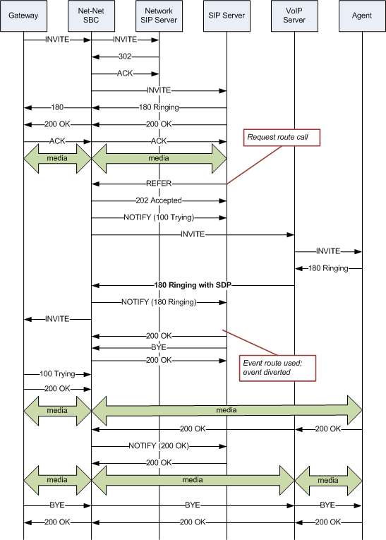

180 & 100 NOTIFY in REFER Call Transfers
The Enterprise SBC can optionally send NOTIFY messages after sending either a 202 Accepted or a 180 Ringing message in REFER call transfer scenarios.
Networks elements that comply with RFC 5589 expect a NOTIFY message after a 202 Accepted and each provisional 180 Ringing. To send these expected messages, set the refer-notify-provisional parameter to initial or all.
When you retain the default setting for this parameter (none), the Enterprise SBC does not send the NOTIFY until it receives the 200 OK response from the agent being called. If the time between the REFER and the NOTIFY exceeds time limits, the NOTIFY from the Enterprise SBC may go undetected by devices compliant with RFC 5589, resulting in failures during the routing process.
The following image shows a sample call flow when refer-notify-provisional is set to none.
The image shows the call flow when refer-notify-provisional is set to none, as described above.
In contrast, the following image shows the call flow when refer-notify-provisional is set to all. In this flow, the Enterprise SBC now sends a NOTIFY in response to the 202 Accepted, and another after the 180 Ringing. This causes the event to be diverted successfully.
The image shows the call flow when refer-notify-provisional is set to all, as described above.

  7. Set refer-fail-resume to determine what the Enterprise SBC does when a blind REFER fails:
    • disabled: (Default) Automatically end the call after 32 seconds.
    • enabled: Ignore the 32 second timer and continue the original call. This is useful for sessions with Advanced Media Termination clients using music on hold.
