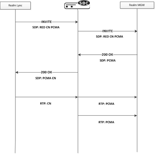

Case 1
The Case 1 CN generation SPL call flow is described below.
  1. SDP offer received from the realm that has comfort-noise-generate enabled. If the SDP offer contains CN, no IWF is required. If it does not contain CN, and at least one of the offered audio codecs is PCMU or PCMA, CN is added in outgoing SDP offer.
  2. If SDP Answer contains the CN codec and topmost audio codec is PCMU or PCMA, E-SBCenables CN IWF.
  3. E-SBC strips CN from outgoing SDP Answer.
Case 2
The Case 2 CN generation SPL call flow is described below.
  1. SDP offer is sent to a realm that has comfort-noise-generate enabled. If CN was not offered, IWF cannot be performed. If CN is in the offer, the E-SBC forwards the offer to the outbound side.
  2. SDP Answer is received from a realm that has comfort-noise-generate enabled. If it contains CN, no IWF is required because both sides support CN. If there is no CN in the Answer, and the topmost audio codec is PCMU or PCMA, the E-SBC enables CN IWF.
  3. If CN IWF is enabled, the E-SBC adds CN to the outgoing SDP Answer.
