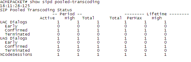

Monitor Dialogs Between the A-SBC and the T-SBC
You can monitor pooled transcoding communications between the Access Session Border Controller (A-SBC) and the Transcoding Session Border Controller (T-SBC) by using the show sipd pooled-transcoding ACLI command. The display shows you information for the client and server User Agents on the A-SBC.
- UAC Dialogs—shows the number of UAC dialogs the A-SBC initiated with the T-SBC. The count is cumulative, and not for any specific session.
 - UAS Dialogs—shows the number of UAS dialogs the A-SBC created upon receipt of an INVITE from the T-SBC. The count is cumulative, and not for any specific session.
 - XCodeSessions—counts the number of transcoded sessions on the A-SBC.
