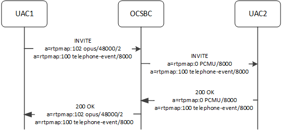

In this first example, you set the allow-diff2833-clock-rate-mode parameter on the ingress interface to use-2833-clock-rate. The diagram below shows the ESBC accepting a different clock rate for the SILK codec and the tel-event from UAC1. This interface is ingress to UAC1. The ESBC presents PCMU, and telephone-event with a clock rate of 8000. The ESBC maintains the original offer and presents the 200OK to UAC1 using the clock rates it offered.

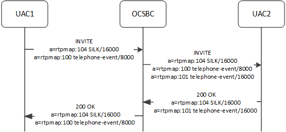

In this next example call flow, the diagram shows the ESBC using the same allow-diff2833-clock-rate-mode configuration as the example above, allowing it to accept a different clock rate for the opus codec and the telephone-event from UAC1. Again, the ESBC presents PCMU, and telephone-event with a clock rate of 8000. The ESBC maintains the original offer and presents the 200OK to UAC1 using the clock rates it offered.

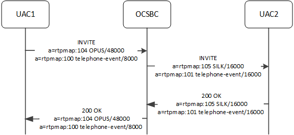

In this next example call flow, the diagram presents the ESBC handling differing telephone-event and codec clock rates without transcoding. Notice that the "top" codec in A0 and O1 are the same. Without enabling features such as dtmf-in-audio detection or RTCP generation, which you could expect would force a transcoded call, the system treats the call as passthrough, even though the telephone-event clock rate differs on ingress and egress. This is because the audio codecs negotiated between ingress and egress are the same. Nevertheless, the ESBC maintains the differing telephone-event clock rates and supports the flow.

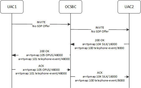

In this next example call flow, you have configured the ESBC with a codec-policy towards UAC2 that accepts SILK and telephone-event; and allow-diff2833-clock-rate-mode is use-2833-clock-rate. In addition, codec-policy towards UAC1 does not accept SILK; and adds OPUS at egress. allow-diff2833-clock-rate-mode is use-2833-clock-rate.
Using this configuration, and receiving an offerless INVITE, ESBC behavior includes:
- UAC1 sends an offerless INVITE. Offer is received from UAC2 in 200-OK. Therefore, UAC2 becomes ingress and UAC1 becomes egress.
 - Ingress codec policy (UAC2’s codec-policy) does not remove anything from the offer since it accepts SILK and telephone-event both.
 - Egress codec policy (UAC1’s codec-policy) removes SILK and a telephone-event mismatching clock rate of audio codec. It adds OPUS and a telephone-event matching clock rate of OPUS.
 - Answer towards UAC2 contains telephone-event of same clock rate as was received in offer.
 - Rfc2833 packets towards ingress and egress will be generated based on telephone event clock rate i.e. 8000 towards UAC2 (ingress) and 48000 towards UAC1 (egress).
