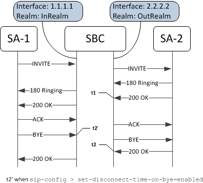

Call Duration Calculation
Call duration is calculated as the time between (t1) when the ESBC receives the 200OK for the INVITE from terminating endpoint, and (t2) the time when ESBC receives the final 200OK for the BYE message from terminating endpoint, regardless of whether media is released. If the set-disconnect-time-on-bye parameter is enabled in the sip-config, then the call termination time (t2') is when the ESBC receives the BYE message originally from the endpoint ending the call.
Figure 4-1 Call Duration Calculation Example - Ladder Diagram
Table 4-1 Call Duration Calculation Example - Results
| Element | Inbound Duration (sec) | Outbound Duration (sec) |
| Session Agent: SA-1 | t2 - t1 | 0 |
| Session Agent: SA-2 | 0 | t2 - t1 |
| Realm: InRealm | t2 - t1 | 0 |
| Ream: OutRealm | 0 | t2 - t1 |
| Interface: 1.1.1.1 | t2 - t1 | 0 |
| Interface: 2.2.2.2 | 0 | t2 - t1 |
The global system call duration for the previous example is t2' - t1 seconds if the set-disconnect-time-on-bye parameter is enabled.
