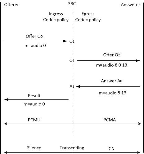

Comfort Noise Transcoded Scenario
In a typical scenario with CN transcoding enabled, the ESBC transcodes the ingress audio codec for the media stream to PCMA. The DSP detects silence in the media stream from the Offerer, translates the silence into a CN packet, and sends the packet to the Answerer. The Answerer sends a CN packet to the DSP, which translates the packet into silence in the media stream and sends the packet to the Offerer. The result is silence on egress.
Ingress codec policy Setting Egress codec policy Setting
allow codecs * allow codecs *
add codecs on egress N/A add codecs on egress PCMA CN
order codecs N/A order codecs N/A
The comfort noise transcoded call flow is described below.
The side of the call that does not support CN, must use an audio codec that the ESBC supports as transcodable, represented by "x" in the call flow.
The side of the call that supports CN, must use an audio codec that the ESBC supports as interoperable with CN, represented by PCMA in the call flow.

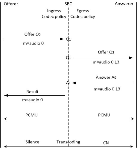

Audio Codec Not Transcoded - Comfort Noise Codec Transcoded Scenario
In the following scenario, the ingress codec policy and the egress codec policy both allow all offered codecs. The setting for add-codecs-on-egress is CN.
  1. The Offerer sends an offer O° to the ESBC with an SDP m-line for an audio codec PCMU, but with no CN signaling codec
  2. The codec-policy for the ingress realm allows the audio codec, PCMU, and outputs O¹ which contains PCMU.
  3. The ESBC egress codec-policy takes O¹ as input and adds CN after checking that at least one of the audio codecs in O¹ interoperates with CN, resulting in PCMU and CN in output O².
  4. The Answerer responds with the answer in Aº containing the PCMU audio codec and the signaling codec CN, indicating the Answerer supports comfort noise. The egress codec-policy produces answer A¹ with no changes.
  5. The ESBC removes CN from A¹ because it was not offered by the Offerer. The result contains only the audio codec PCMU.
Even with CN transcoding enabled, the ESBC does not transcode the audio codec (PCMU). The ESBC transcodes silence detection and generation, as well as CN packet detection and generation.
add codecs on egress N/A add codecs on egress CN
The Audio Codec not Transcoded call flow is described above.

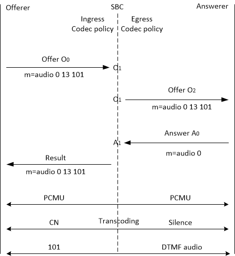

Comfort Noise and Telephone Event Codecs Both Transcoded Scenario
In the following scenario, the ESBC transcodes both Comfort Noise (CN) and telephone event codecs.
  1. The Offerer sends an offer (O°) with an SDP m-line for an audio codec PCMU to the ESBC, and includes both CN and telephone-event signaling codecs.
  2. The codec-policy for the ingress realm allows all codecs and outputs O¹. The ESBC egress codec-policy takes O¹ as input, allows all codecs, and produces output O².
  3. The Answerer responds with the answer in A° containing the PCMU audio codec. The egress codec-policy produces answer A¹ with no changes.
  4. The ESBC applies the add-codecs-on-egress parameter from the ingress codec-policy to add CN and telephone-event to A¹. The result contains the audio codec PCMU and the CN and telephone-event signaling codecs because the ESBC excepts signalling codecs from the rule that the system can apply the add-codecs-on-egress parameter only by the egress codec policy.
Even with CN transcoding enabled, the ESBC does not transcode the audio codec (PCMU). The ESBC transcodes silence detection and generation, as well as CN packet detection and generation. The ESBC transcodes telephone-events to in-band DTMF audio.
Ingress codec policy Settings Egress codec policy Settings
add codecs on egress CN telephone event add codecs on egress N/A
dtmf-in-audio preferred dtmf-in-audio preferred
The Comfort Noise and Telephone Event Transcoded call flow is described above.
