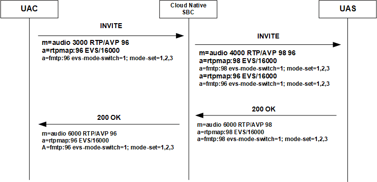

EVS Call Flow Example
The flow depicted below provides an example that uses the audio-payload-type-mapping=yes to enable payload type mapping. In addition, the flow uses add-codecs-on-egress configuration in the egress codec policy configured as EVS::PT98. The offer contains EVS in AMR-WB IO mode and the ESBC adds a separate EVS AMR-WB IO with a different payload type. The answerer selects PT 98 and since audio-payload-type-mapping=yes, so transcoding is not required, and payload type mapping is used. The offer and answer are both octet-aligned and they have intersecting mode-sets, so transcoding is not required and payload type mapping is used.
AMR-WB to EVS AMR-WB IO Transparent Call Example
This example explains how you can configure the ESBC and applicable resources to support calls between EVS and AMR-WB endpoints without requiring transcoding, and therefore not consuming ESBC transcoding resources. This use case, established by logic within the ESBC, can accommodate calls in either direction.
In this call flow a codec policy is set on the egress realm to not allow AMR-WB and to add EVS AMR-WB IO on egress. The offer contains AMR-WB. The ESBC recognizes that the incoming AMR-WB codec matches the EVS codec to be added:
- They have the same octet-align
- EVS codec is in interoperable mode (evs-mode-switch=1)
- You have a media-profile configured that matches the parameters presented in the AMR-WB offer
The ESBC strips AMR-WB and adds EVS with the same payload type as AMR-WB even though EVS is not configured with that payload type.
codec-policy
name Transparent-AMR-WB-IO
allow-codecs * AMR-WB:no
add-codecs-on-egress EVS::WBIO
force-ptime disabled The call proceeds transparently between AMR-WB and EVS.
