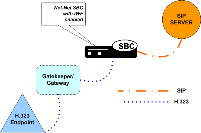

SIP Redirect—H.323 LRQ Management
When it needs to interact with a SIP Redirect server, the Oracle® Enterprise Session Border Controller can interpret the SIP messages and manage them on the H.323 side of the session. For IWF sessions, the Oracle® Enterprise Session Border Controller handles SIP Redirect and H.323 LRQ messages.
![The OCSBC supporting a SIP redirect within H.323 IWF. The OCSBC supporting a SIP redirect within H.323 IWF.](img/iwf_redirect_lrq.gif)

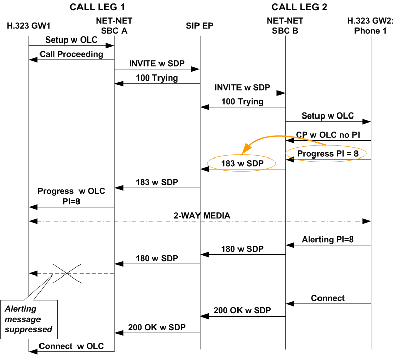

Sample 1 In-band Ringback without Progress Message
This sample flow shows how the Oracle® Enterprise Session Border Controller handles a call that requires the IWF where there is no progress message. In this call flow, there is a progress indicator of eight (8), meaning that ringback is in-band.
In this diagram, you can see that the Oracle® Enterprise Session Border Controller maps the progress indicator included in the Alerting message sent from Phone 1 through H.323 GW2 to a SIP 180 message with SDP. When the Progress message appears, it contains the progress indicator rather than the Alerting message containing it.
![The In-Band Ringback without Progress Message call flow is described above. The In-Band Ringback without Progress Message call flow is described above.](img/iwf_inband-ringback-w_o-progress.gif)

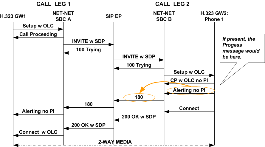

Sample 2 In-band Ringback with Progress Message
This sample flow shows how the Oracle® Enterprise Session Border Controller handles a call that requires the IWF where there is a progress message. In this call flow, there is a progress indicator of eight (8), meaning that ringback is in-band.
For this call flow, you can see again that the Oracle® Enterprise Session Border Controller maps the progress indicator included in the alerting message sent from Phone 1 through H.323 GW2 to a SIP 180 message with SDP. Note that now the Progress message contains the progress indicator.
![The In-Band Ringback with Progress Message call flow is described above. The In-Band Ringback with Progress Message call flow is described above.](img/iwf_inband-ringback-progress.gif)

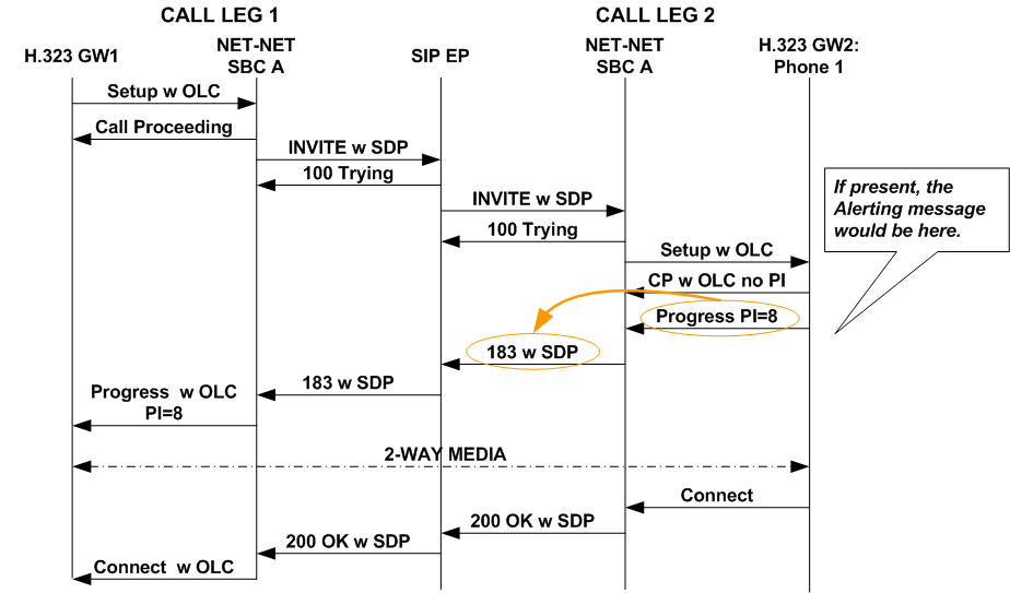

Sample 3 In-band Ringback without Alerting Message
In this diagram, you can see that the Oracle® Enterprise Session Border Controller maps the progress indicator included in the Progress message sent from Phone 1 through H.323 GW2 to a SIP 180 message with SDP. When the Alerting message appears, it contains the progress indicator rather than the Progress message containing it.
![The In-Band Ringback without Alerting Message call flow is described above. The In-Band Ringback without Alerting Message call flow is described above.](img/iwf_inband-ringback_no-_alerting.gif)

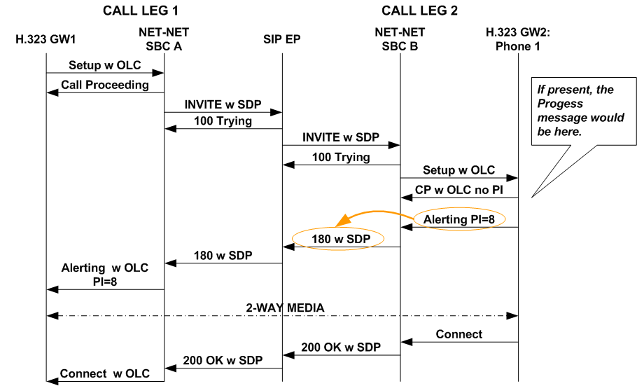

Sample 4 Out-of-band Ringback without Progress Message
When there is no progress indicator included in the Alerting message, then there is out-of-band ringback. The system maps the Alerting message to a SIP 180, but it it does not include SDP in the SIP 180. This call flow shows that there is no Progress message and that media cannot be set up until after H.323 Connect and SIP messages are sent.
![The Out-of-Band Ringback without Progress Message call flow is described above. The Out-of-Band Ringback without Progress Message call flow is described above.](img/iwf_outofband-ringback-no-progress.gif)

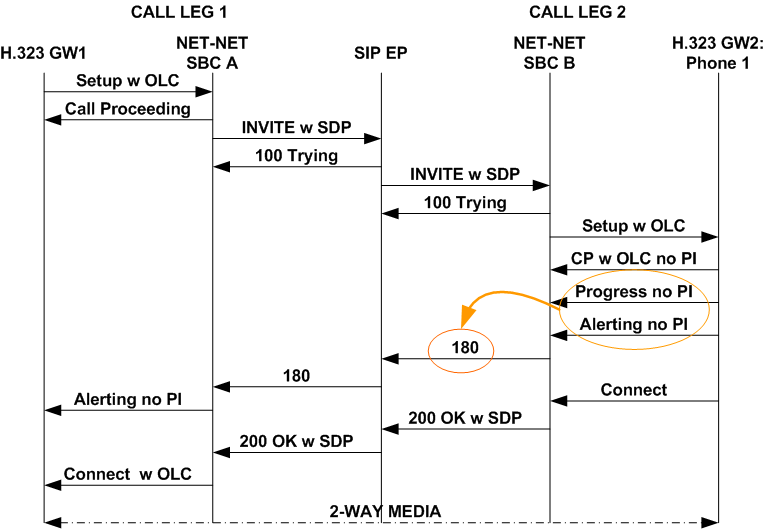

Sample Flow 5 Out-of-band Ringback with Progress Message
When there is no progress indicator included in either the Alerting or Progress messages, then there is out-of-band ringback. The system maps the Alerting message to a SIP 180, but it does not include SDP in the SIP 180. This call flow shows includes the Progress message; still, media cannot be set up until after H.323 Connect and SIP messages are sent.
![The Out-of-Band Ringback with Progress Message call flow is described above. The Out-of-Band Ringback with Progress Message call flow is described above.](img/iwf_outofband-ringback-progress.gif)

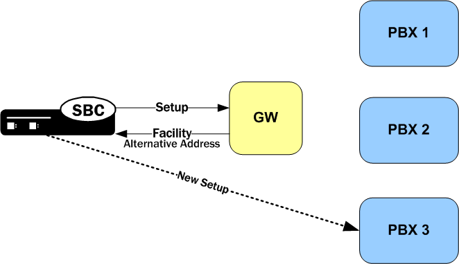

IWF Call Forwarding
This section describes the Oracle® Enterprise Session Border Controller ’s IWF Call Forwarding feature, which is supported for calls initiated in SIP that require interworking to H.323.
Prior to the implementation of this feature, the Oracle® Enterprise Session Border Controller did not forward calls when the remote H.323 endpoint sent a Facility message with Call deflection as the reason and an alternate address for forwarding. Instead, it would either:
- Fail to release the initial call and initiate the forwarded call
- Drop the entire call when the remote endpoint for the call tore down the session
New Behavior
In the diagram below, you can see that the Oracle® Enterprise Session Border Controller sends the initial Setup message to the gateway, and the gateway returns the Facility message with an alternate address for forwarding. Rather than engaging in its former behavior, the Oracle® Enterprise Session Border Controller now releases the call with the gateway and sends a new Setup to the alternate address from the Facility message.
This new Setup up has no effect on the first call leg, which remains connected.
![The IWF Call Forwarding diagram is described above. The IWF Call Forwarding diagram is described above.](img/h323-call-fwd.gif)
When it receives a Facility message with the reason CallForwarded, the Oracle® Enterprise Session Border Controller looks for an alternate transport address in the Facility’s alternativeAddress or alternativeAliasAddress element. The Oracle® Enterprise Session Border Controller releases the egress call with the reason facilityCallDeflection. Then it takes one of two courses of action:
- If it does not find an alternative address, the Oracle® Enterprise Session Border Controller releases the ingress call (with 486 BUSY HERE for a call being interworked from SIP to H.323).
If it finds an alternative address and the egress call has not been alerted or answered, the Oracle® Enterprise Session Border Controller at this point tries to initiate a new egress call. The Oracle® Enterprise Session Border Controller uses the alternative alias address to populate the calledPartyNumber information element (IE) and the destination address of the new Setup.
