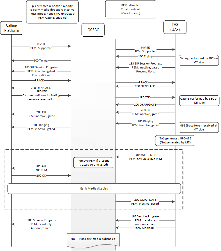

The call flow below presents an example of the issues this feature resolves. In this flow, the ESBC closes the gate on early media when it receives the 200 OK to the UPDATE from the mobile originating (MO) side, depicted within the dashed box. This is default ESBC behavior, resulting in PEM being inactive on the access side, and, in this call flow, prevents the presentation of early media on the MO leg.
This image depicts an example of early media being gated without the pass-pem-in-update option enabled.
An example of a problem case solved by this features includes the ESBC receiving an UPDATE with a PEM header arriving from the trusted mobile terminating (MT) leg/core side. Without this feature, the ESBC follows its default behavior, which includes not forwarding the PEM header towards the untrusted access side:
  • If you set the p-early-media-header access sip-interface to modify and the p-early-media-direction is inactive, the 200 OK response to the update from the MO effectively closes the gate.
  • The ESBC closes the gate when receiving the 200 OK to the UPDATE from the MO side, which is by design (PEM inactive on access), thereby gating early media on the MO leg. In this case, the access is always untrusted, and the core is always trusted.

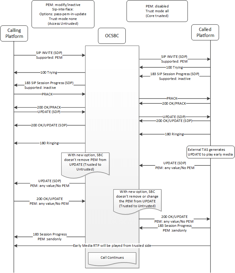

When you configure the pass-pem-in-update option, the ESBC forwards the PEM header as received, ignoring other PEM header configuration. The applicable messages that can trigger this feature include the ESBC:
  • Receiving an UPDATE request from the trusted side and forwarding it towards the untrusted side.
  • Receiving a 200 OK/UPDATE from the untrusted side and forwarding it towards the trusted side.
ORACLE(sip-interface)# +options pass-pem-in-update
The image below depicts the ESBC supporting PEM across trusted and untrusted networks in both directions. You have configured the trust-mode to none, the p-early-media-header to modify, and the p-early-media-header to inactive on the access sip-interface. You have also set the p-early-media-header to disabled and the trust-mode to all on the egress sip-interface. Both of these configurations prevent early media across those interfaces.
But you have also enabled the pass-pem-in-update option on the ingress sip-interface, which would be applied to the UPDATE coming from the core (access interface egress), based on the egress sip-interface configuration. This configuration supersedes the other configurations, allowing the ESBC to accept early media, effectively bypassing what would be the standard ESBC behavior of rejecting it.
This image displays the SBC allowing early media across the untrusted side having been requested by the trusted side.

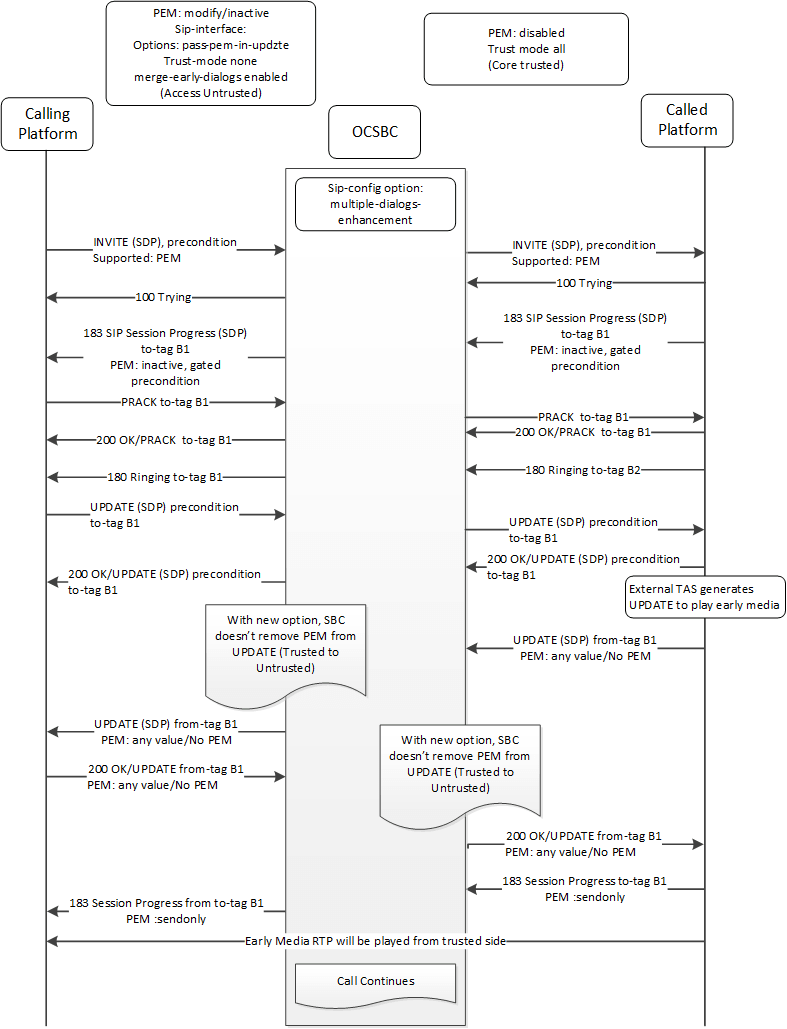

This feature is compatible with the multiple early dialogs feature within the context of dialog merging, and many-to-many dialogs. You establish these configurations with the merge-early-dialogs configuration and the multiple-dialogs-enhancement option respectively. Applicable cases wherein the ESBC receives an UPDATE from the trusted side allows early media include:
  • multiple-early-dialogs in many-to-many mode cases:
    • UN-TRUSTED (ingress side ) to TRUSTED (egress side )
    • UN-TRUSTED (egress side ) to TRUSTED (ingress side )
  • multiple-early-dialogs in merge mode cases, with the ingress configured as the merge realm:
    • TRUSTED (ingress side ) to UN-TRUSTED (egress side )
    This is supported in E2E precondition cases because the ESBC responds to an UPDATE message from the calling party locally in the context of the merge.
This image displays the SBC allowing early media across the untrusted side having been requested by the trusted side, within the context of multiple early dialog merging.
