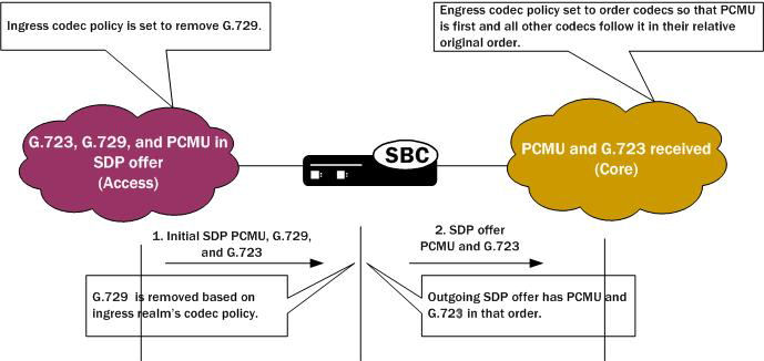

The Enterprise SBC applies codec policies during the offer phase of media format negotiation. If codec manipulation is enabled, then the Enterprise SBC performs the modification according to the specific policy and forwards on the traffic.
For example, when the Enterprise SBC receives a SIP INVITE with SDP, it refers to the realm through which the INVITE arrived and performs any manipulations specified by an ingress codec policy that may have been assigned to the ingress realm. With the media description possibly changed according to the ingress codec policy, the Enterprise SBC passes the SDP offer to the outgoing realm so that the an egress codec policy can be applied. Note that the SDP to be evaluated by the egress codec policy may match the original SDP, or it may have been changed during transit through the ingress realm. After applying the egress coded policy, the Enterprise SBC forwards the INVITE.
This image displays the Enterprise SBC managing codec advertisement via configured codec policy.
Since the offer-answer exchange can occur at different stages of SIP messaging, the assigned ingress and egress roles follow the media direction rather than the signaling direction. It might be, for example, that the offer is in an OK that the Enterprise SBC modifies.
