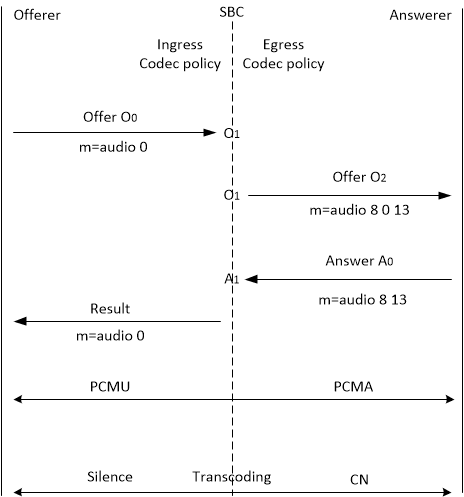

Comfort Noise Transcoded Scenario
In a typical scenario with CN transcoding enabled, the Enterprise SBC transcodes the ingress audio codec for the media stream to PCMA. The DSP detects silence in the media stream from the Offerer, translates the silence into a CN packet, and sends the packet to the Answerer. The Answerer sends a CN packet to the DSP, which translates the packet into silence in the media stream and sends the packet to the Offerer. The result is silence on egress.
Ingress codec policy Setting Egress codec policy Setting
allow codecs * allow codecs *
add codecs on egress N/A add codecs on egress PCMA CN
order codecs N/A order codecs N/A
The comfort noise transcoded call flow is described below.
The side of the call that does not support CN, must use an audio codec that the Enterprise SBC supports as transcodable, represented by "x" in the call flow.
The side of the call that supports CN, must use an audio codec that the Enterprise SBC supports as interoperable with CN, represented by PCMA in the call flow.
