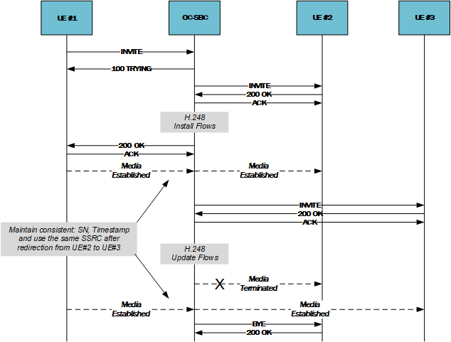

A common cause for SSRC changes is call transfer. The diagram below depicts a transfer from UE #2 to US #3. The call transfer creates an SSRC change that the administrator has determined may not be accepted by UE #3. By configuring HMU on the egress realm, the administrator prevents these changes from causing the call to fail.
This figure shows the Enterprise SBC managing call termination changes with HMU

Although the feature is RTC, the system only performs HMU on new calls after configuration. In addition, HMU supports HA. The Enterprise SBC maintains all established calls across a failover. Failover may cause sessions that have HMU active to have a jump in SSRC, timestamps and sequence number. This may trigger the HMU logic and generate RTP data rewrites for flows.
The Enterprise SBC maintains HMU status messages whenever received RTP packets trigger the HMU logic. You can verify how many HMU transitions have occurred on interfaces using the show media host stats command, and the HMU index per media flow using the show nat by-index command.
HMU is not supported for RTCP or SRTCP packets. Regardless of HMU configuration, the Enterprise SBC supports only up to 7 SSRC changes per SRTP session. Also, if HMU is disabled, the Enterprise SBC supports only up to 7 SSRC changes per SRTP session for RTP and RTCP packets.
