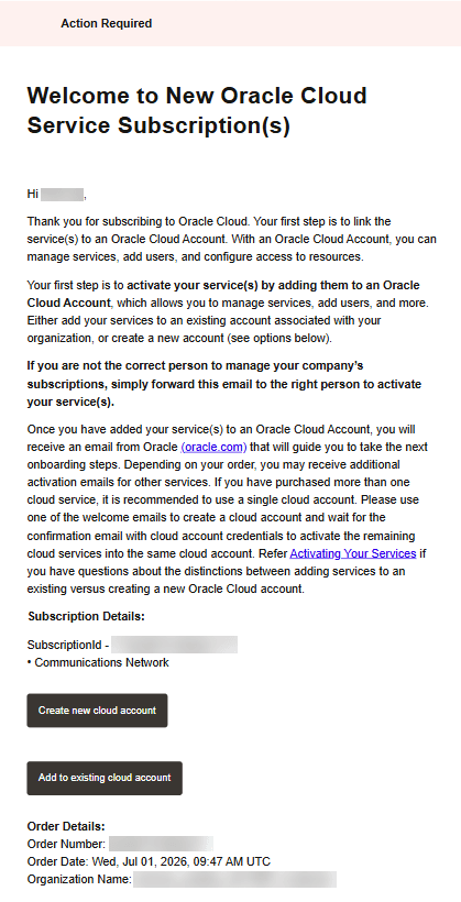

The activation email (see figure below) contains information about the subscription that needs activation. When you receive this email, you will need to decide if you want to create a new cloud account for this subscription or activate it into an existing account. You will see different links for each option that will redirect you to different web pages.
Figure 2-2 Activation Email Sample
Sample activation email
Selecting New or Existing Account

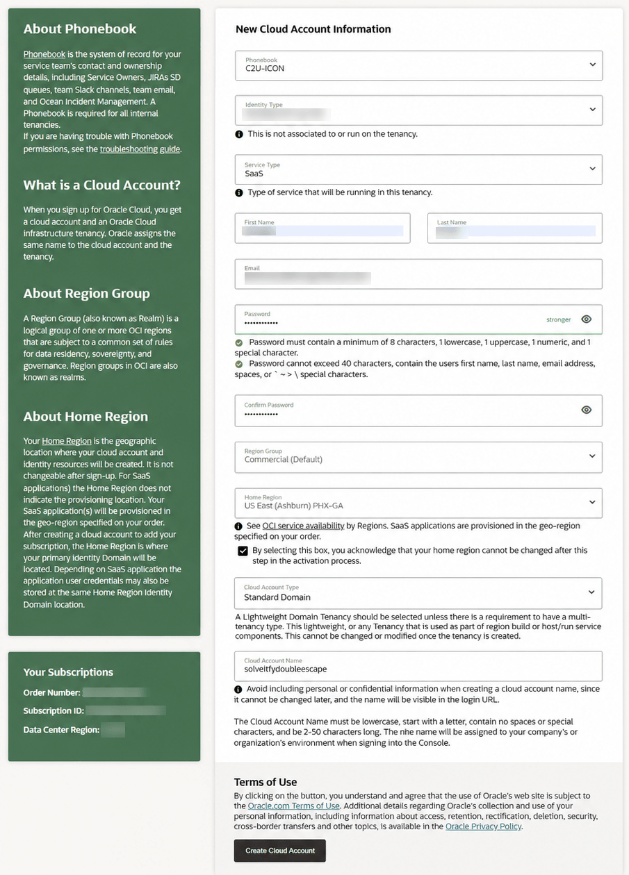

If you decide to create a new cloud account for your new subscription, you will need to enter certain details in the activation page about your new cloud account (see figure below).
You will also have to determine who will be the initial administrator. After providing these details and confirming the activation, the system will process your information and
start the process of creating the services you subscribed to. This process is called Provisioning.
The provisioning process can take a few days and at the end of it you will get one or more email notifications that your services are ready. At that point you will be able to login into your services and start using them.
