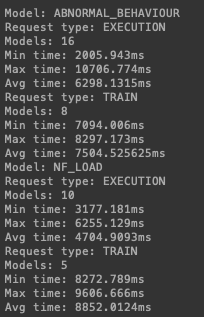

      $ python3 integration_script.py -h http://cap4c-model-controller.ocnwdaf-ns:8080 -p /app/performance/integration/data/ -t CSV -n 10
      Sample output:
      Figure 4-1 Sample Output
      Sample Output
    • Script to extract Jaeger Metrics and to subsequently delete synthetic data from Database: This script extracts the metrics and then deletes the dummy data from the DB. Run the script:
      $  python3 performance/report_script.py -h <host> -p <port> -m <options> -u <prefix> -y <types>
      Table 4-3 Parameters
      Parameter Description Default Value
      -h Jaeger host name or address localhost
      -p Jaeger UI port 16686
      -m Available options: ABNORMAL_BEHAVIOUR, NF_LOAD, and so on. all
      -u Set a URL prefix if needed, such as '/blurr7/jaeger NA
      -y Type of execution: TRAIN, EXECUTION, all. all
      If the parameters are not set, the script uses the default values.
      For example:
      $ python report_script.py -t occne-tracer-jaeger-query.occne-infra -p 80 -u /blurr7/jaeger
      Sample output:
      Figure 4-2 Sample Output
      Sample Output
      Figure 4-3 Sample Output
      Sample Output
