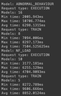

$ python3 integration_script.py -h http://cap4c-model-controller.ocnwdaf-ns:8080 -p /app/performance/integration/data/ -t CSV -n 10Sample output:
Figure 4-1 Sample Output
Script to extract Jaeger Metrics and to subsequently delete synthetic data from Database: This script extracts the metrics and then deletes the dummy data from the DB. Run the script:
