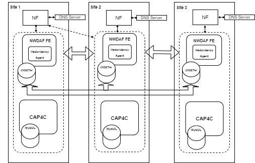

3.8 Georedundancy
Overview
A network includes multiple sites, and each site can be located at different data centers and spread across geographic locations. A network failure can occur due to reasons such as outages, software defects, hardware issues, and so on. These failures impact the continuity of network services. Georedundancy is used to mitigate such network failures and ensure service continuity. In a georedundant deployment, when a failure occurs at one site, an alternate site takes ownership of all the subscriptions and activities of the failed site. The alternate site ensures consistent data flow, service continuity, and minimal performance loss. Georedundancy includes implementing data replication of one site across multiple sites to efficiently handle failure scenarios and ensure High Availability (HA). OCNWDAF along with data replication supports Machine Learning (ML) Model replication.
Georedundant Deployment Architecture
The OCNWDAF supports both 2-site and 3-site georedundant deployments. The following diagram depicts a 3-site georedundant deployment.
Figure 3-3 Georedundant Architecture

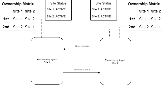

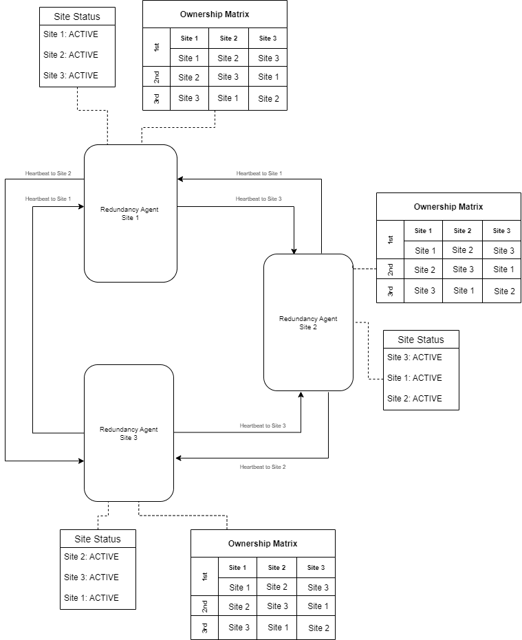

Redundancy Agent
Redundancy Agent is the microservice introduced to maintain communication and enable site transfer between the mated sites. It uses a heartbeat mechanism to broadcast the liveness of a site and receives liveness updates from mated sites.
Site transfer is based on the configured priority of the mated sites. The Redundancy Agent of every site maintains a priority list of the mated sites. The priority list is configured using the Helm chart. A site can access the priority list of other sites using the database and build the ownership matrix. When a site failure occurs at the primary site, the ownership is transferred to the secondary site. If the secondary site fails, the ownership is transferred to the tertiary site and so on. Identifying and recognizing a failed site is based on a quorum, where a majority of active sites agree on the failed status of the site.
An NF sends a subscription request to the Analytics Subscription Service. The subscription service verifies if the subscription exists and if it is a new subscription, it stores the subscription data and the site ID. The Redundancy Agent accordingly responds with a status to the subscription service. If the status is ACTIVE, the Analytics Subscription Service continues with the subscription request. If the Analytics Subscription Service receives any other status, it responds to the subscription request with an HTTP 5XX response. The subscription service updates and maintains site status based on the response received by the Redundancy Agent. If a subscription request is received from a NF when the site is down, the transfer of responsibility to mated site is the addressed by the Redundancy Agents, the request is forwarded to the site that is currently handling all the subscription requests of the site that is down. If a core component failure occurs, the Redundancy Agent intimates the Subscription Service, the Subscription Service caches the data sent by Redundancy Agent, and further this data is referred by Subscription Service while accepting fresh subscriptions. The Analytics Information Service also operates like the Analytics Subscription Service. The Redundancy Agent provides the site liveness data to the Data Collection Service when there is a change in the core component status. The Data Collection Service caches the data sent by Redundancy Agent, and refers to this data while accepting fresh data collection requests.

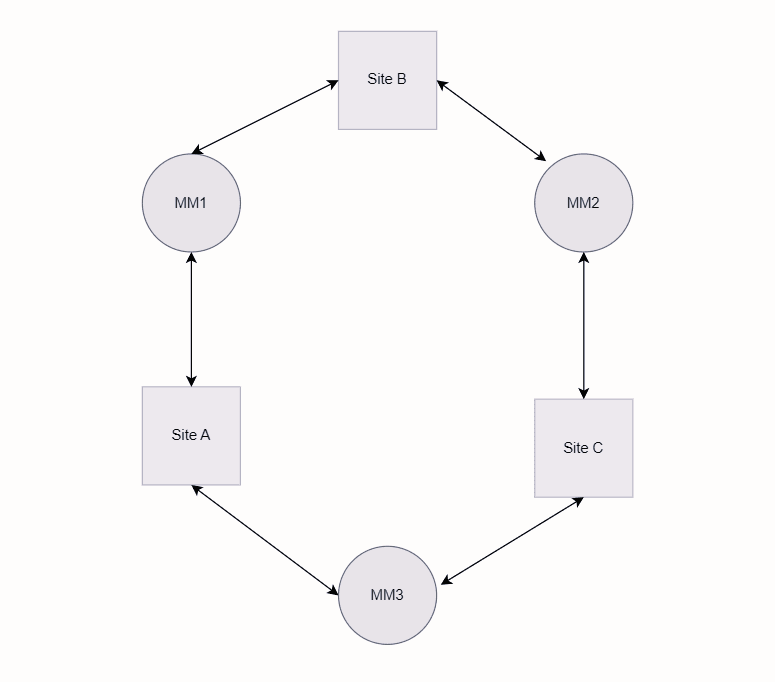

Figure 3-4 Circular Topology
Circular Topology
In the above diagram:
  • The Mirror Maker “MM1” of Site A handles the replication for both Sites A and B.
  • The Mirror Maker “MM2” of Site B handles the replication for both Sites B and C.
  • The Mirror Maker “MM3” of Site C handles replication for Sites C and A.

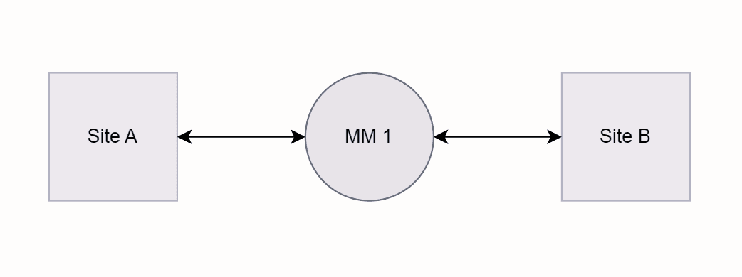

A two-site georedundant deployment requires only one MM2 connecting the sites. The MM2 can be in either of the site's environments. The diagram below depicts the recommended topology for a two-site georedundant deployment:
Figure 3-5 Two-Site Deployment
Two-Site Deployment

Two-Site Georedundancy
The following diagram depicts a two-site georedundant deployment:
Figure 3-7 Two-Site Georedundancy
The ownership matrix determines the transfer of ownership when a site failure occurs. The site failure is determined by the site status. The site status can be ACTIVE, INACTIVE, SUSPENDED, DISCOVERY and UNAVAILABLE. The ownership transfer occurs as per the ownership matrix when the site is INACTIVE, SUSPENDED or UNAVAILABLE.
For example, when Site 2 is INACTIVE, based on the ownership matrix Site 1 becomes the owner of all subscriptions owned by Site 2.
Three-Site Georedundancy
The following diagram depicts a three-site georedundant deployment:
Figure 3-8 Three-Site Georedundancy
For example, when Site 1 is down, Site 2 takes ownership of the subscriptions at Site 1. If Site 2 is also down Site 3, assumes ownership of subscriptions at Site 1. The transfer of ownership is based on the priority configured in the Ownership Matrix.

Listed below are the Mirror Maker configuration parameters:
Table 3-5 Mirror Maker Parameters
Parameter Description
clusters The clusters name.
clusterX.bootstrap.servers This parameter refers to the brokers that belong to the cluster, host, and port. Multiple brokers can be separated by a comma, and clusterX is replaced by each cluster name.
clusterX.config.storage.replication.factor The replication factor is used when Kafka Connect creates a topic to store the connector and task configuration data. This value should always be a minimum of “3” for a production system. It cannot exceed the number of Kafka brokers in the cluster. Set the value of this parameter to “1” to use the Kafka broker's default replication factor.
clusterX.offset.storage.replication.factor The replication factor is used when Kafka Connect creates a topic to store the connector offsets. This value should always be a minimum of “3” for a production system. It cannot exceed the number of Kafka brokers in the cluster. Set the value of this parameter to “1” to use the Kafka broker's default replication factor.
clusterX.status.storage.replication.factor The replication factor is used when Kafka Connect creates a topic to store the connector and task status updates. This value should always be a minimum of “3” for a production system. It cannot exceed the number of Kafka brokers in the cluster. Set the value of this parameter to “1” to use the Kafka broker's default replication factor.
replication.factor Indicates the number of brokers available.
nwdafDataReplication.config.serviceN.kafkaService The Kafka service name to build Kafka service's FQDN.
nwdafDataReplication.config.serviceN.namespace The namespace to build Kafka service's FQDN.
nwdafDataReplication.config.serviceN.cluster The cluster to build Kafka service's FQDN.
