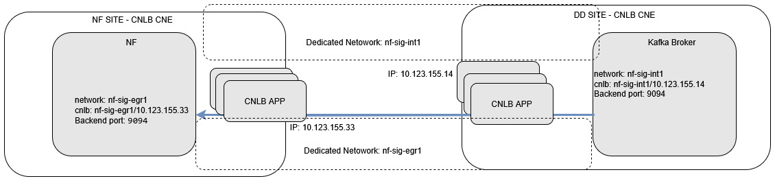

11.1.3 Enabling Ingress Traffic Segregation for the Ingress Adapter
Non-Oracle NFs (Network Functions) forward traffic to the Data Director via the Ingress Adapter. If non-Oracle NFs are deployed in the same cluster as OCNADD, there is no need to enable the CNLB configuration for the Ingress Adapter, as the service name or FQDN can be used.
When non-Oracle NFs are in a separate cluster, ingress traffic segregation can be achieved by enabling CNLB support for the Ingress Adapter in the Data Director.
  • In current release, a single segregation network will be attached to each Ingress Adapter configuration. If more than one non-Oracle NF wants to connect to the same Ingress Adapter Feed, ingress traffic segregation will not be possible.
  • To achieve ingress traffic segregation for all non-Oracle NFs ingesting data to the Data Director, a separate Ingress Adapter Feed configuration needs to be created for each non-Oracle NF.
In this configuration, all non-Oracle NFs must share the same dedicated network to forward traffic to the Data Director. Communication between non-Oracle NFs and the Data Director will occur over a single dedicated network, using the external IP of the Ingress Adapter.

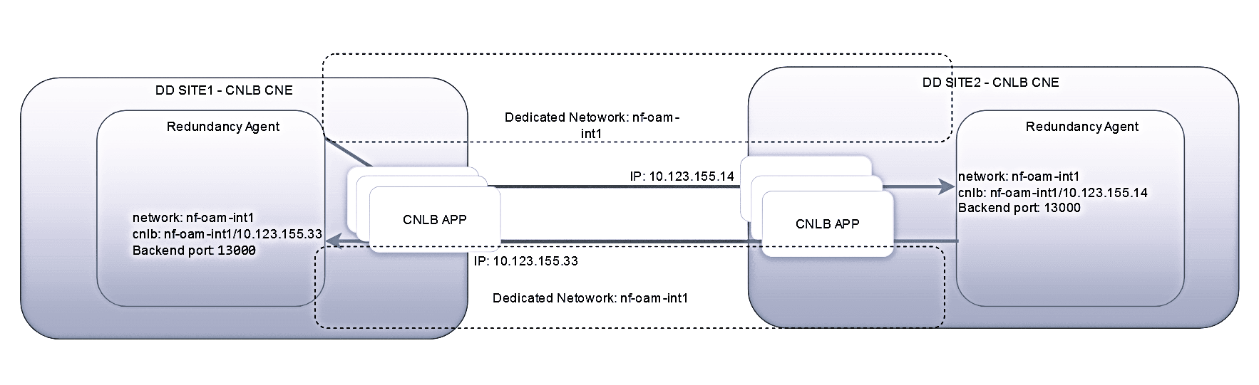

a) Both sites are deployed in the CNLB-enabled cluster
Both the sites in the CNLB enabled cluster
Follow the procedure to enable CNLB in the Redundancy Agent on both sites.
The following points should be considered:
The two sites should have the same name for the egress NAD definitions, else the consumer adapter may stop processing the data if the NAD name is not present in the site.

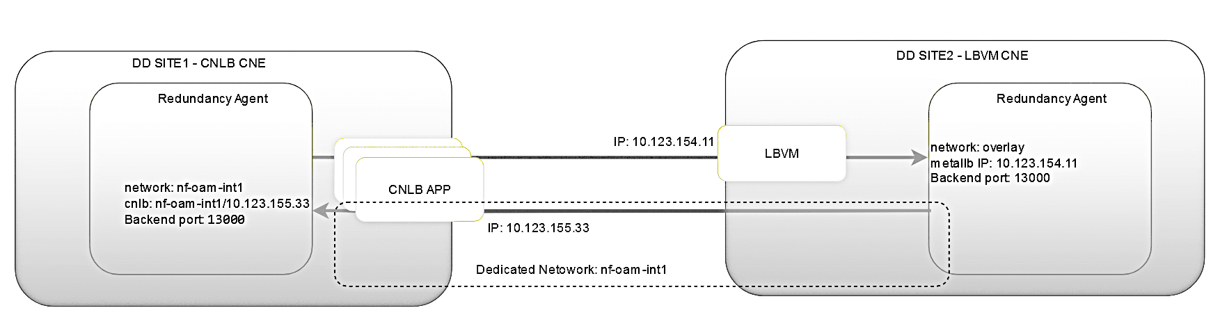

b) One site is deployed in the CNLB-enabled cluster, and the other in an LBVM-based CNE cluster
Only one site in the CNLB enabled cluster
Follow the procedure to enable CNLB in the Redundancy Agent.
  • The bi-directional configuration sync will not work if the primary site is CNLB enabled and secondary site is not CNLB enabled. In this case on the primary site, the consumer adapter feed configuration should be modified to include the NAD name in the feed.
  • Discrepancy alarm is expected when the configuration sync is unidirectional and Primary site is CNLB enabled and Secondary site is non CNLB.

In the Secondary Site (Site 2):
If the Redundancy Agent (RA) in the Data Director is deployed in an LBVM CNE environment, skip the steps below and follow the Enable Two-Site Redundancy Support section to continue with enabling the two-site redundancy feature.
If the Redundancy Agent (RA) in the Data Director is deployed within a CNLB CNE environment, follow the steps below:
Step 1: Extract the Network and NAD Information for the Ingress-Egress NAD
Caution:
The same script /var/occne/cluster/$OCCNE_CLUSTER/artifacts/cnlbGenAnnotations.py can be run by a user with admin privileges or the root user.
  1. Either obtain admin privileges from the cluster administrator before running the script.
  2. Or have the command executed by an admin user and note down the output for use in Step 2.
Extract NADs:
  1. Run the script /var/occne/cluster/$OCCNE_CLUSTER/artifacts/cnlbGenAnnotations.py in CNE to fetch the available ingress-egress network information (similar inputs as in the primary site).
    # python3 /var/occne/cluster/$OCCNE_CLUSTER/artifacts/cnlbGenAnnotations.py
    Network Names that application will use? Valid Choice example - oam OR comma separated values - oam,sig,sig1 = oam
    Application pod external communication ? Valid choice - IE(Ingress/Egress) , EGR(Egress Only), INT(Ingress Only) = INT
    Pod ingress network type ? Valid choice - SI(Single Instance -DB tier only) , MN(Multi network ingress / egress) , SN(Single Network) = SN
    Provide container ingress port name for backend from pod spec  , external ingress load balancing port? Valid choice - Example (http,80) = http,9188
    Pod network attachment annotation, add to application pod spec
    k8s.v1.cni.cncf.io/networks: default/nf-oam-int7@nnf-oam-int7
    oracle.com.cnc/cnlb: '[{"backendPortName": "http", "cnlbIp": "10.121.44.138","cnlbPort": "9188"}]'
Step 2: Update the ocnadd-custom-values.yaml
  1. Copy the cnlbIp and networks values from the script output and update the ocnadd-custom-values.yaml file as shown below:
    cnlb.redundancyagent.enabled: true
    cnlb.redundancyagent.network: "default/nf-oam-int7@nf-oam-int7"
    cnlb.redundancyagent.externalIPs: "10.123.155.34"
    global.deployment.primary_agent_ip: 10.10.10.10         ====> should be updated with ip 10.123.155.33 as extracted from CNLB on the primary site
Step 3: Follow the procedure in the section Enable Two-Site Redundancy Support to continue enabling the two-site redundancy feature in the Data Director.
11.1.5 Enabling CNLB External IPs in The Kafka Cluster
On CNLB-enabled OCCNE K8s cluster, when Kafka is deployed with external access, then Kafka brokers shall become externally accessible via external IPs exposed using ingress NADs. In this case, network and CNLB annotations should be configured in the Kafka brokers.
The section describes the procedure to extract the external IPs and ingress NADs from the configured and available CNLB network definitions and update the CNLB annotations in the Kafka brokers. This procedure is applicable to all the deployed worker groups.
OCNADD and NF sites are deployed in the CNLB-enabled clusters.
KafkaExtAccess_CNLB
The NF can also be deployed in a non-CNLB-enabled cluster; however, the procedure remains the same on the Data Director.
Follow the procedure to enable Kafka external access on the CNLB-enabled Data Director OCCNE K8s cluster.
