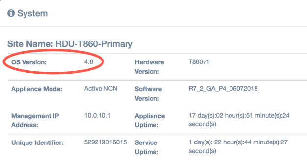

To see which OS image is currently running on your Oracle SD-WAN Appliance, log into the appliance web console and look at the OS Partition Version displayed on the home screen.

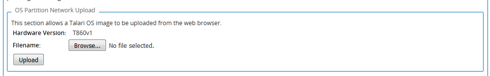

If your workstation is not on the same local network as the Oracle Talari Appliance, we recommend copying the image to a local host before uploading it to the Oracle Talari Appliance to avoid upload timeout. - Log into the appliance web
console and locate the OS Partition Network Upload section under
Manage
SD-Wan Edge → OS Partition.

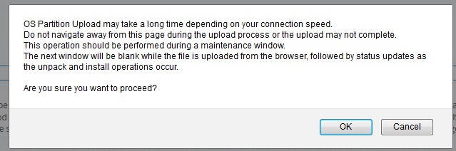

- Click
Browse... and locate
the new OS Partition Image on your workstation or the local host on which you
downloaded it, then click
Upload to upload the
image to the Oracle SD-WAN Appliance. When asked to confirm, click
OK.

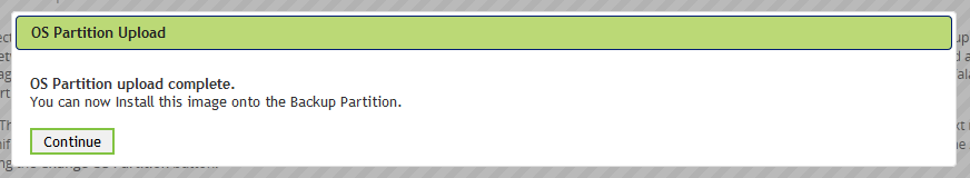

- Wait for the upload to
complete. Do not leave the upload status page until the
Continue button
becomes active. Click
Continue to return
to
Manage
SD-WAN Edge → OS Partition.
Upload progress can be monitored via the CLI. Please refer to Appendix A - Monitor OS Upload via CLI for more details.

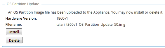

- The OS Partition Upload
section of the screen now displays an
Install option.

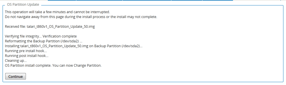

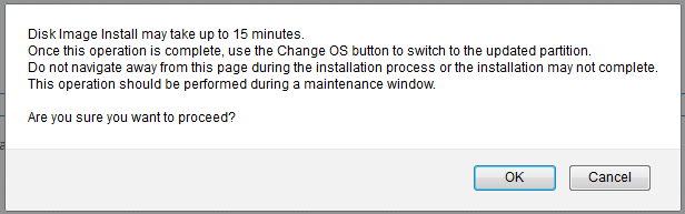

Click
Install to install
the image to the backup OS partition and click
OK on the
confirmation dialog box.
- Wait for installation to
complete. Do not leave the install status page until the
Continue button is
active. Click
Continue to return
to
Manage

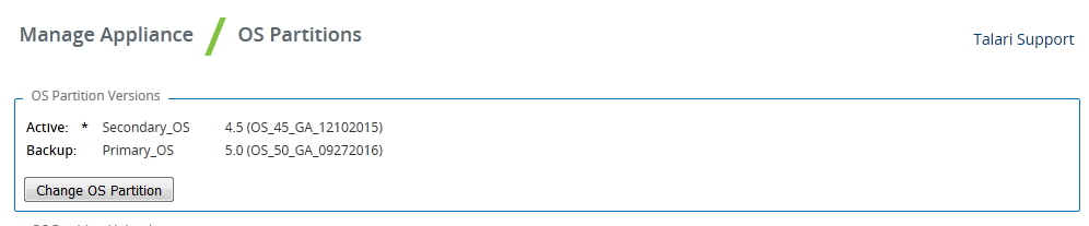

- The OS Partition Versions
section will display the newly installed OS image on the backup partition.

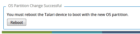

Click
Change OS
Partition to swap the backup partition with the active partition.
An appliance reboot is required. Click
OK to confirm.
Activating a new OS image requires an appliance reboot and should be scheduled during a maintenance window.

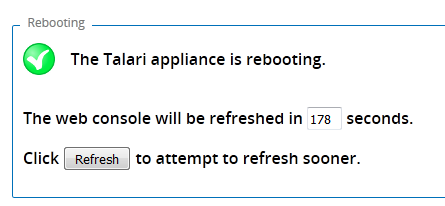

- When prompted, reboot the
appliance and click
OK to confirm.
- Wait for the reboot to
complete. This may take several minutes, during which time the appliance will
be inaccessible.

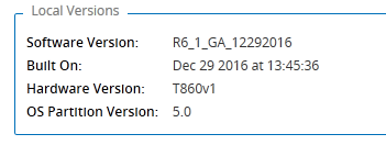

Following the reboot, the old OS image will still be available on the backup OS partition should you need to revert. Please contact Support before attempting to revert to the previous OS image. - When reboot is complete,
log into the appliance web console and verify that the
Software
Version and
OS
Version are correct, and that any previously established Conduits
have been brought back up.

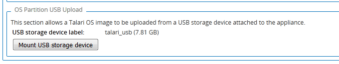

The screen shots in this chapter were taken from an T860 Appliance.- Connect the USB flash
drive to the Oracle SD-WAN Appliance and refresh the
Manage

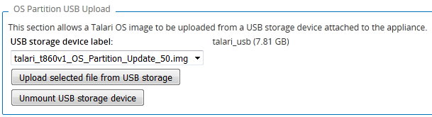

SD-WAN Edge → OS Partition screen. Locate the OS Partition USB
Upload section and click
Mount USB
storage device.
- Select the new OS
Partition Image from the drop-down menu and click
Upload
Selected File from USB Storage.

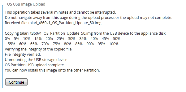

- Wait for upload to
Continue button
Continue to return
to
Manage

Click
Install to install
the image to the backup OS partition and click OK to confirm.
- Wait for install to complete. Do not leave the install status page until the Continue button becomes active. Click Continue to return to Manage SD-WAN Edge → OS Partition.

Removal of the USB flash drive does not require un-mounting or ejecting it. The drive can simply be removed. - The OS Partition Versions
Click
Change OS
An Appliance reboot is required. Click
OK to confirm.

Following the reboot, the old OS image will still be available on the backup OS partition, should you need to revert. Please contact Support before attempting to revert to the previous OS image. - When reboot is complete, log into the appliance web console and verify that the Edge Software version and OS image version are correct, and that any previously established Conduits have been brought back up.
