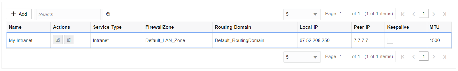

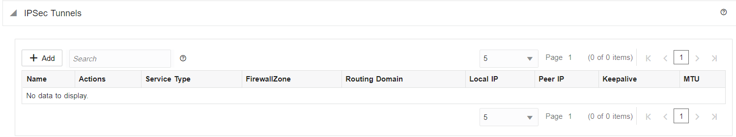

Access the IPSec configuration elements by selecting Advanced and then Connections. Use the plus symbol to add a new element and use the pencil marker symbol to edit an existing record.
- Intranet
- LAN
- Palso Alto
- Zscalar
The default value is Intranet.
Select a value for the Service Type parameter.
- Intranet
- LAN
- Palo Alto
- Zscalar
- Name
- If the service type is Intranet, select the auto-generated name appended with "Intranet_Service".
- If the service type is LAN, type in the text in the name box.
- Firewall Zone—Select an entry from drop down list.
- Local IP—Dropdown list of Virtual IPs
- Peer IP—The other end of the component for which IP Sec tunnel needs to be established.
- MTU—The default value is 1500 bytes
- Keepalive—Is a check box, if enabled the appliance will trigger IKE and IPSec rekey

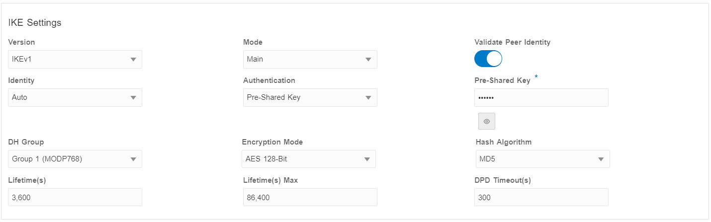

IKE Settings
- Version
- The IKE version used to initiate the ISAKMP. Values:
- IKEv1
- IKEv2 (recommended)
- Mode
- Phase 1 parameter exchange in Main mode or Aggressive mode.
Values:
- Main (default)
- Aggressive
- Identity
- Identity of the IKE interface. Values:
- Auto (default)—IP address for PSK authentication, Certificate DN for certificate authentication
- IP Address— IP address of the appliance from which IKE interacts.
- Authentication
- The mode in which peer can authenticate the appliance. Values:
- pre-shared key (default)
- certificate
- Pre-shared Key
- This field appears only if the authentication method is pre-shared key, this field is for secret key of the peer.
- Certificate
- This field appears only if the authentication method is certificate, an entry should be selected from any of the the pre-configured certificate name which appears in the drop down list. Values: select an entry from the drop down list menu.
- Validate Peer Identity
- Validate the identity of the peer, which can come in the form of IP or FQDN. Values: Check box not ticked (default).
- DH Group
- Supported DH groups in the appliance MUST select one from the
- Group 1 – (Modp768)
- Group 2 – (Modp1024)
- Group 5 – (Modp1536)
- Group 19 – (ECP256) (recommended)
- Hash Algorithms
- Supported hashing algorithms in the appliance MUST select one
from the drop down list. Values:
- SHA1
- MD5
- SHA256 (recommended)
- Encryption Mode
- Encryption algorithms used for encryption in phase2 of ISAMKP.
Values:
- AES 128-bit
- AES 192-bit
- AES 256-bit
- GCM AES 256-bit
- Integrity Algorithm
- This field is specific to IKEv2 version. Values:
- SHA1
- MD5
- Lifetime
- Proposed IKE SA lifetime value in seconds for the IKE SA
established during IKE phase 1 negotiation. Values:
- Min: 0
- Max: 86400
- Default: 3600
- Lifetime Max
- Maximum IKE SA lifetime accepted for IKE SA lifetime during IKE
- Min: 0
- Max: 86400
- Default: 3600
- DPD Timeout
- Timer value in seconds when to send DPD message to peer. Values:
- Min: 0
- Max: 86400
- Default: 300

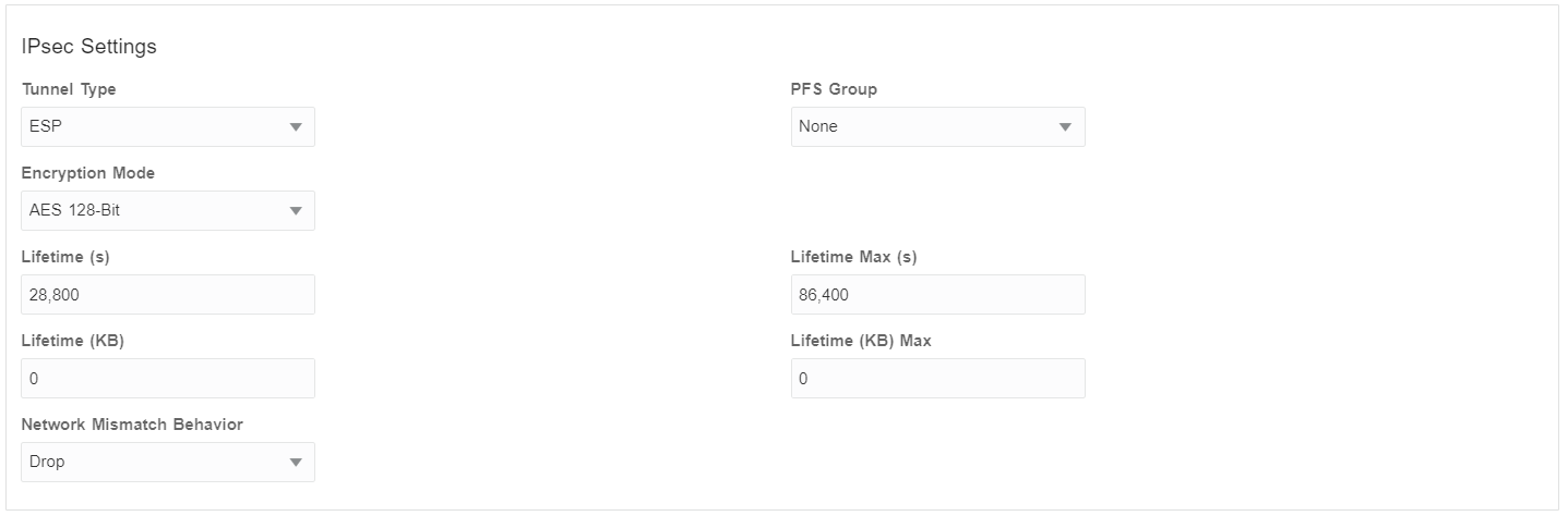

IPSec Settings
- Tunnel Type
- Type of IPsec child SAs that can be established in phase 2.
Values:
- ESP (Encapsulating Security Payload) (default)
- ESP + Auth
- AH (Authentication Header)
- ESP - NULL
- PFS Group
- DH group exchange used for Perfect Forward Secrecy. Values:
- <None> (default)
- Group 1 (MODP768)
- Group 2 (MODP1024)
- Group 5 (MODP1536)
- Group 19 (ECP256)
- Encryption Mode
- Encryption algorithms used in IPSec SAs. Values:
- AES 128-bit
- AES 192-bit
- AES 256-bit
- GCM AES 256-bit
- Lifetime
- Proposed IPSec SA lifetime value in seconds for the IPSec SA
established during IKE phase 2 negotiation. Values:
- Min: 0
- Max: 86400
- Default: 28800
- Lifetime Max
- Maximum IPSec SA lifetime accepted for IPSec SA lifetime during
- Min: 0
- Max: 86400
- Default: 3600
- Lifetime (KB)
- Amount of data , in kilo bytes for an IPSec SA to exist.
Values:
- Min: 0
- Max: 4194303
- Default: 0
- Network Mismatch Behavior
- Choose an action to take if a packet does not match the IP Sec
tunnel’s protected network. Values:
- Drop (default)
- Send unencrypted
- Use Non-IPSec Route
- IPsec Protected Networks
- The allowable set of IP addresses to use IPSec tunnels.
- Source IP/Prefix
- The source IP address which is allowed to use IPSec tunnels
- Destination IP/Prefix
- The destination IP address which is allowed to use IPSec tunnels

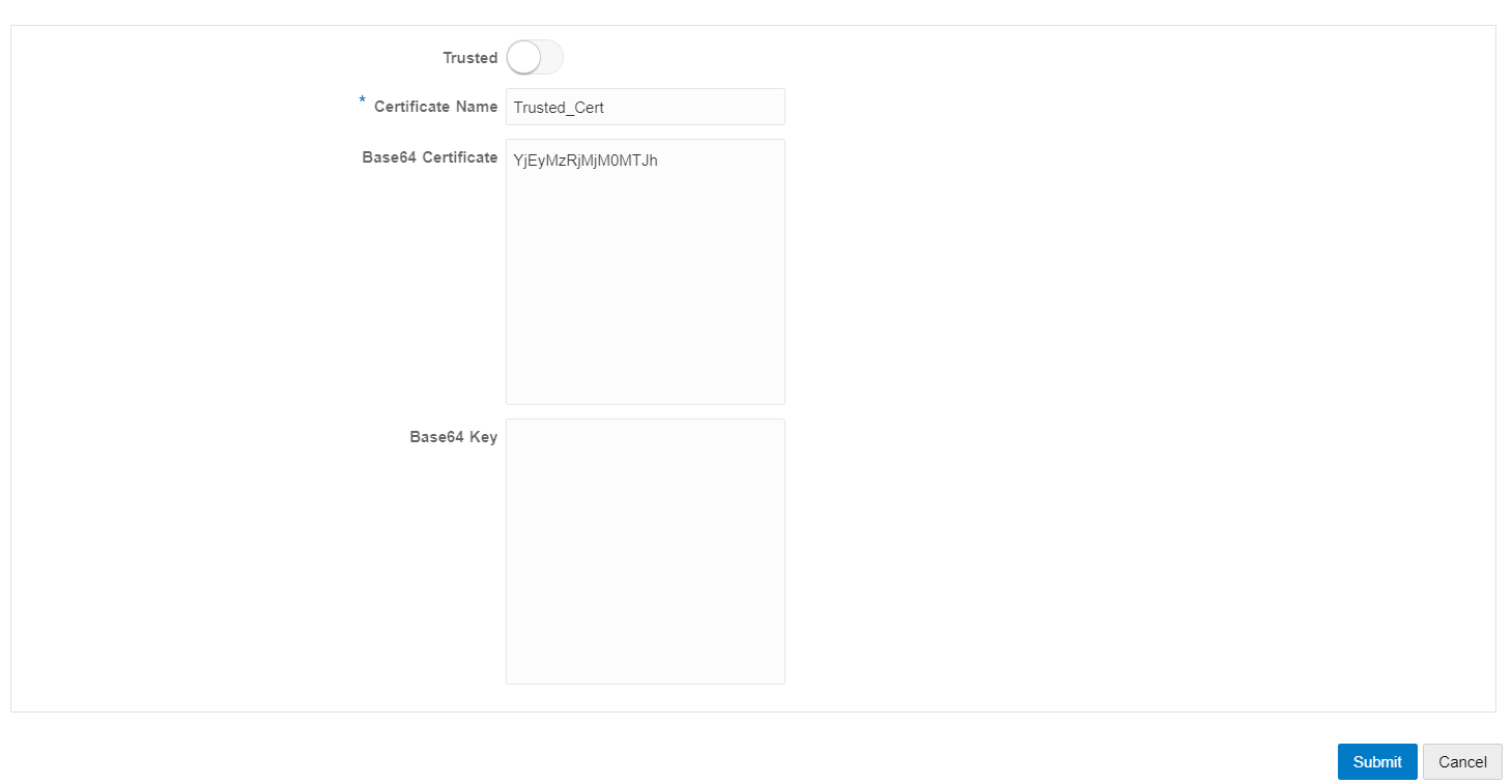

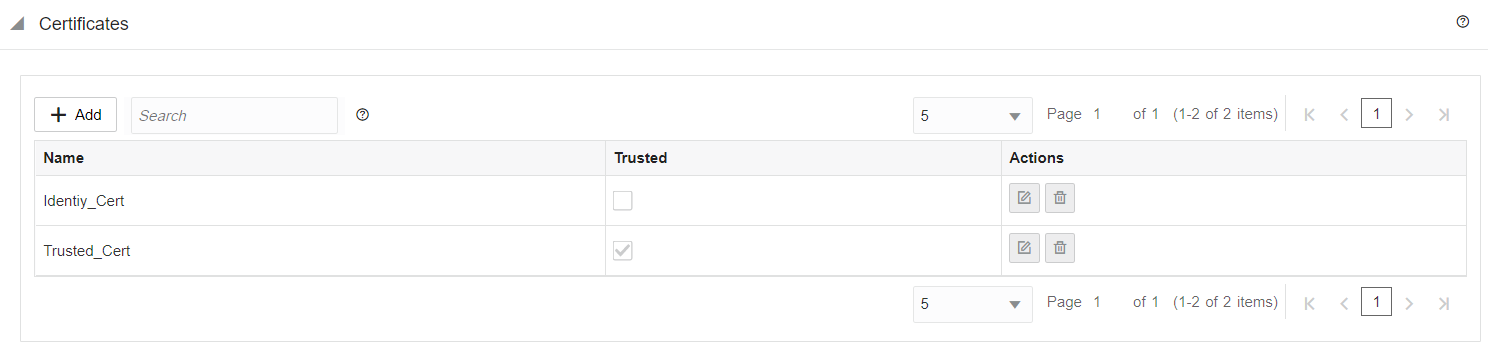

Certificate Configuration
In order to support IKE certificate authentication, an ability to define Identity and Trusted certificates will be created in the configuration editor. To add certificates, click Sites, select a site,then Advanced, and then Certificates. Use the plus symbol to add a new element and use the pencil marker symbol to edit the existing records.
To create a new entry click on the plus symbol, enter a certificate name, and paste the public and private keys.
Trusted
Toggle between Identify and Trusted type of certificate
Base64 Certificate
The base certificate should be entered or pasted here. It is needed for both types of certificates.
Base64 Key
Public key if the certificate type is Identity.

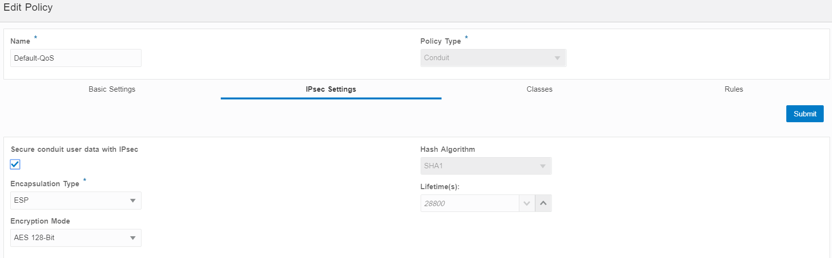

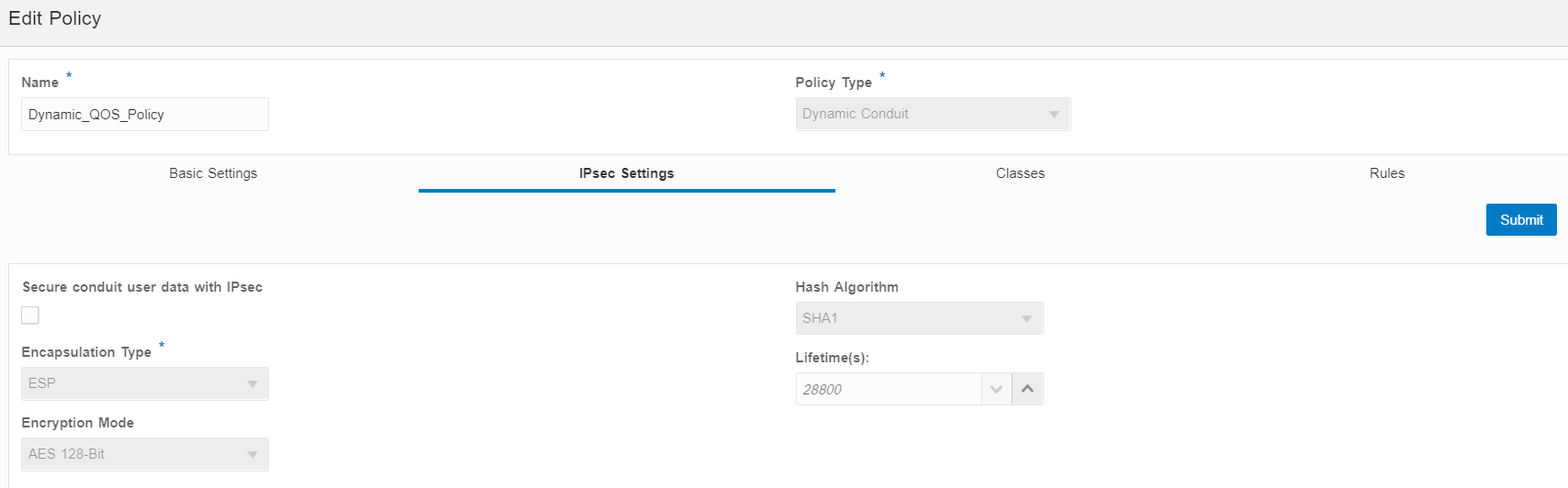

IPSec protected Conduits
For conduit scenario the IPSec SAs can be statically configured between two appliances, again for the establishment of IPSec tunnels IKE protocol is used. This section will allow users to configure the following information required for tunnel creation.
On selecting the check box for secure conduit user data with IPSec, there will be an option to select encapsulation type, encryption mode and the IPSec SA lifetime.
- Tunnel Mode
- Type of IPSec child SAs that can be established in phase 2.
Values:
- ESP (default)
- ESP + Auth
- AH
- Encryption Mode
- AES 128-bit
- AES 256-bit
- Lifetime
- Proposed IPSec SA life time in seconds for and IPSec SA during
- Min: 0
- Max: 86400
- Default: 28800

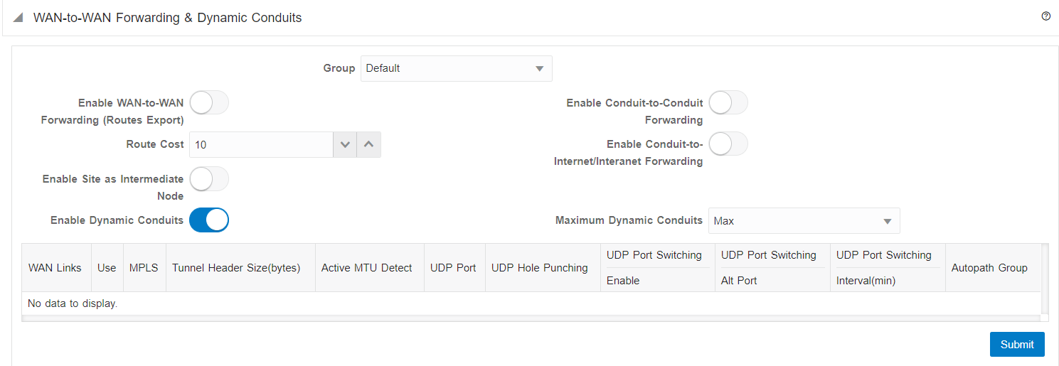

Dynamic Conduit IPSec

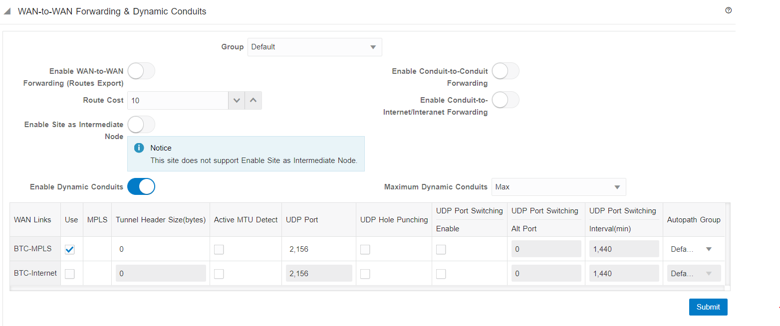

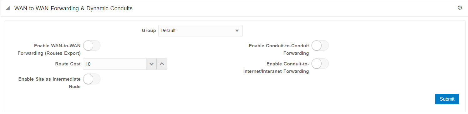

If there is no conduit configured between two sites CL1-E50 and CL2-E50 as shown in the below diagram, the data can be transferred between these two sites via WAN-to-WAN forwarding. The intermediate site (NCN-E100) must have WAN-to-WAN forwarding enabled. Traffic has to go through two hops to get to the destination site. This puts lots of burden on the intermediate site and there might be delay if the sites are in different geographical locations. The dynamic conduit feature can solve these problems as the dynamic conduits can be created on the fly when it is needed, and removed when it's no longer needed. There is a limitation on the maximum conduits can be configured per site based on the hardware type.
On NCN side, the check box enable WAN-to-WAN Forwarding should be enabled and also the Enable Site as Intermediate Node should be enabled.
The Dynamic IPSec has to be configured, it is under Global->Default Sets->Dynamic Conduit Default Sets.
The field Enable Dynamic Conduits under connections table should be enabled for each of the client nodes (APNAs) between whom dynamic conduits needs to be setup.
There shouldn’t be any static conduits configured between the client nodes for which dynamic conduits
Set the “Autopath Group” to “default_group"
