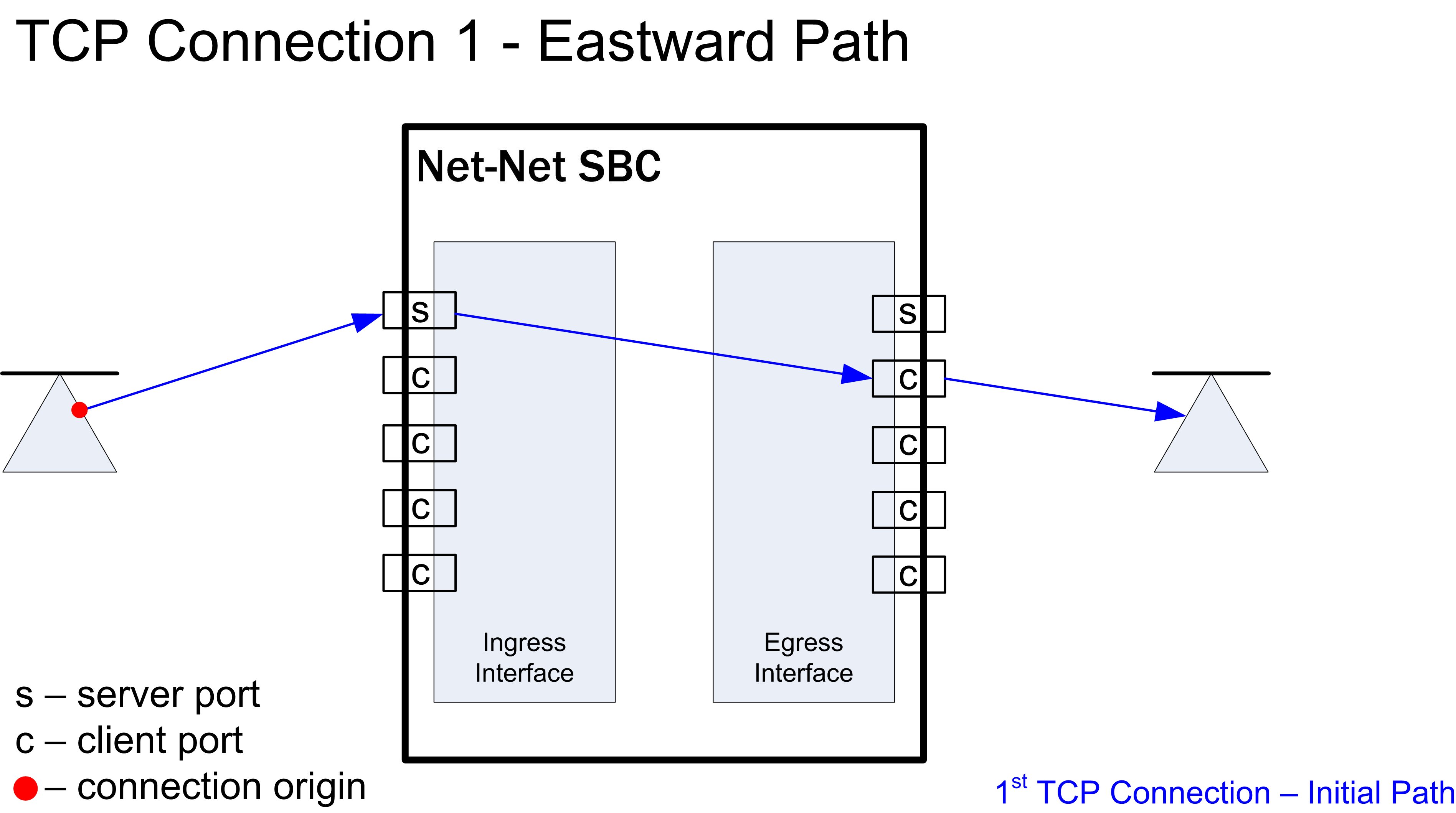

When a call is first set up, the Oracle Communications Session Border Controller inspects the SDP message's m-line to see if any media will be transported via TCP. If the SDP message indicates that some content will use TCP, the Oracle Communications Session Border Controller allocates a configured number of steering ports for the media-over-TCP traffic. These TCP media ports are taken from the each realm’s steering pool.
Each endpoint can initiate up to four end-to-end TCP flows between itself and the other endpoint. The Oracle Communications Session Border Controller assigns one port to receive the initial TCP packet (server port), and one to four ports assigned to send TCP traffic (client ports) to the receiving side of the TCP flow. The number of TCP flows for each call is configured globally.
In order to configure the Oracle Communications Session Border Controller to facilitate and support this process, you need to specify the number of ports per side of the call that can transport discrete TCP flows. You can configure one to four ports/flows. For configuration purposes, the Oracle Communications Session Border Controller counts this number as inclusive of the server port. Therefore if you want the Oracle Communications Session Border Controller to provide a maximum of one end-to-end TCP flow, you have to configure two TCP ports; one to receive, and one to send. The receiving port (server) is reused to set up every flow, but the sending port (client) is discrete per flow. For example: for 2 flows in each direction, set the configuration to 3 TCP ports per flow; for 3 flows in each direction, set the configuration to 4 TCP ports per flow, etc.
The server port is used for initiating a new TCP connection. An endpoint sends the first packet to a server port on the ingress interface. The packet is forwarded out of the Oracle Communications Session Border Controller through a client port on the egress interface toward an endpoint:

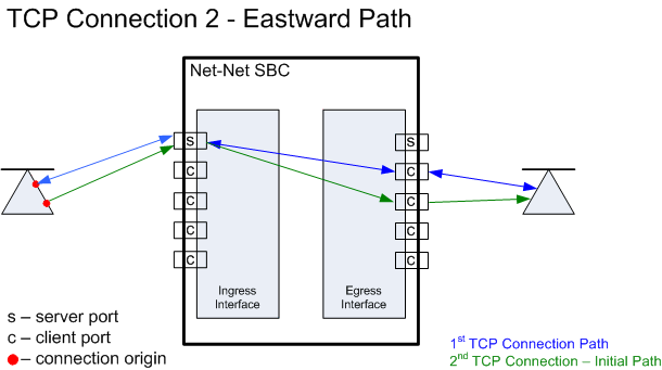

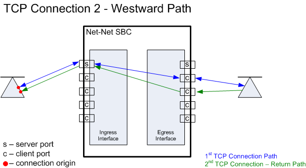

When the second TCP connection is set up in the same direction as in the first example, the first packet is still received on the server port of the ingress interface. The next unused client port is chosen for the packet to exit the Oracle Communications Session Border Controller:
The response takes the same path back to the caller. The remainder of the second TCP connection uses this established path:

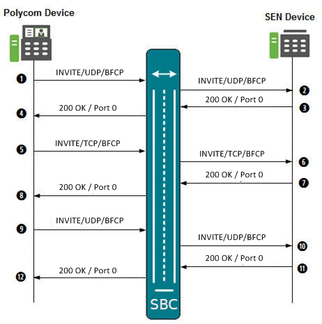

The SBC does not support using both BFCP and a codec policy. When a codec policy is applied, the SBC sets the BFCP and ixmedia ports to zero.The SBC supports BFCP for interworking between Polycom video devices and Siemens Enterprise Communications (SEN) endpoints. When a SIP INVITE request containing a Session Description Protocol (SDP) from a Polycom device is sent to a SEN device, the SBC passes the INVITE request between the two devices regardless of the transfer protocol being used by the devices (UDP or TCP). It also passes the INVITE whether or not it is accepted or rejected by the destination device. The transfer protocol changes between UDP and TCP during the dialog between both endpoints on either side of the SBC.
If both endpoints on either side of the SBC support BFCP, the BFCP is answered with the first SDP offer/answer cycle.The following illustrates the call flow between a Polycom device and a SEN device when an INVITE is sent from the Polycom device.
- Polycom device initiates a call to the SEN device by sending a SIP INVITE to the SBC with SDP, using UDP and BFCP.
- SBC forwards the SIP INVITE to the SEN device.
- SEN device does not support BFCP, and therefore, rejects the INVITE and sends a 200 OK with port '0' from the SEN side to the SBC.
- SBC forwards the 200 OK response to the Polycom device.
- Polycom device looks at port ‘0’ and changes the media transport type from UDP to TCP. It then sends a re-INVITE to the SBC.
- SBC forwards the re-INVITE to the SEN device.
- SEN device does not support BFCP, and therefore, rejects the re-INVITE, and sends a 200 OK with port ‘0’ from the SEN side to the SBC.
- Polycom device looks at port ‘0’ and changes the media transport type from TCP to UDP. It then sends a re-INVITE to the SBC.
- Process repeats Steps 5 through 12 until the call is accepted by the SEN device.
