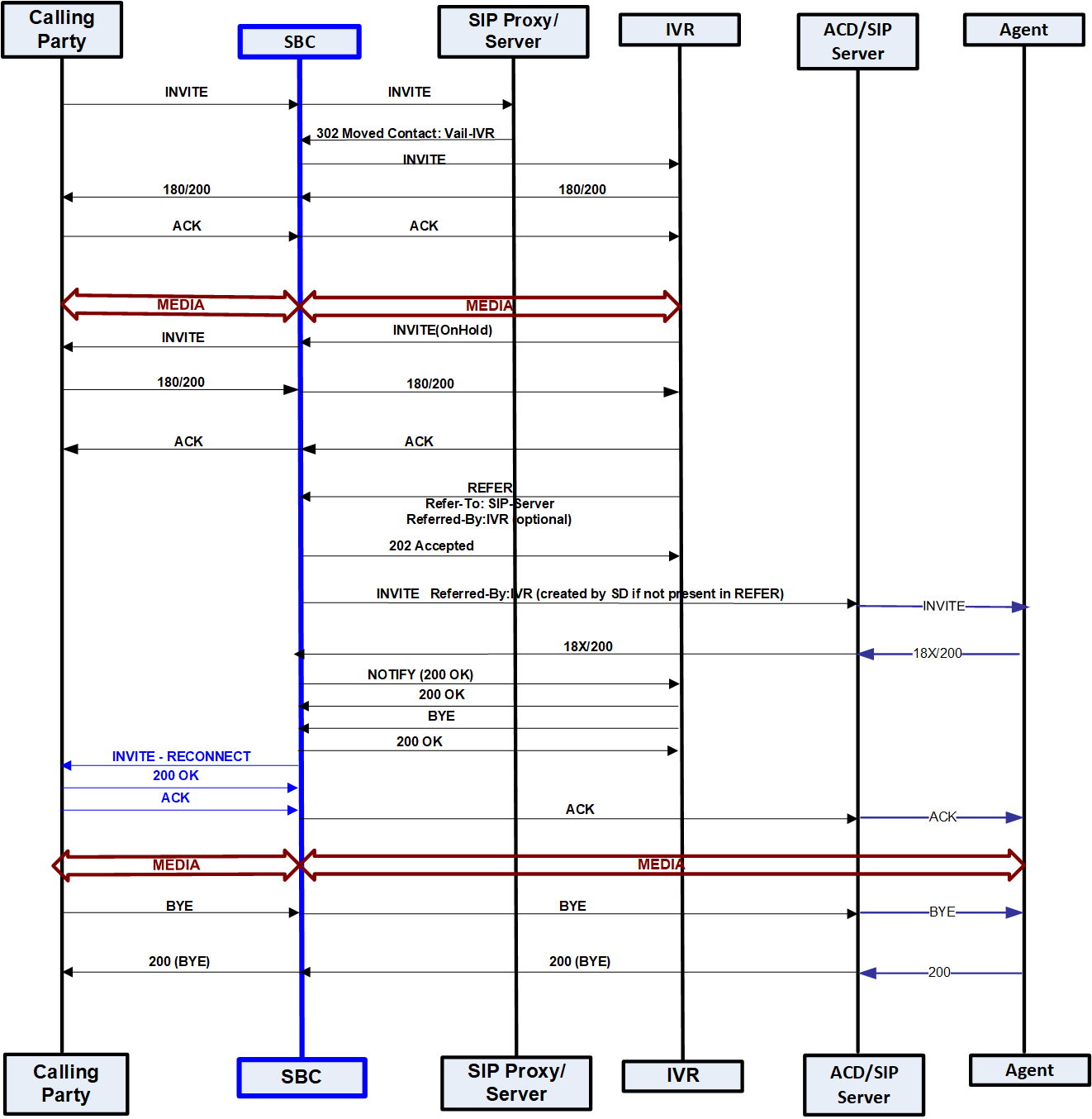

The following is an example call flow for an unattended call transfer:
An example of a call flow for an unattended call transfer.

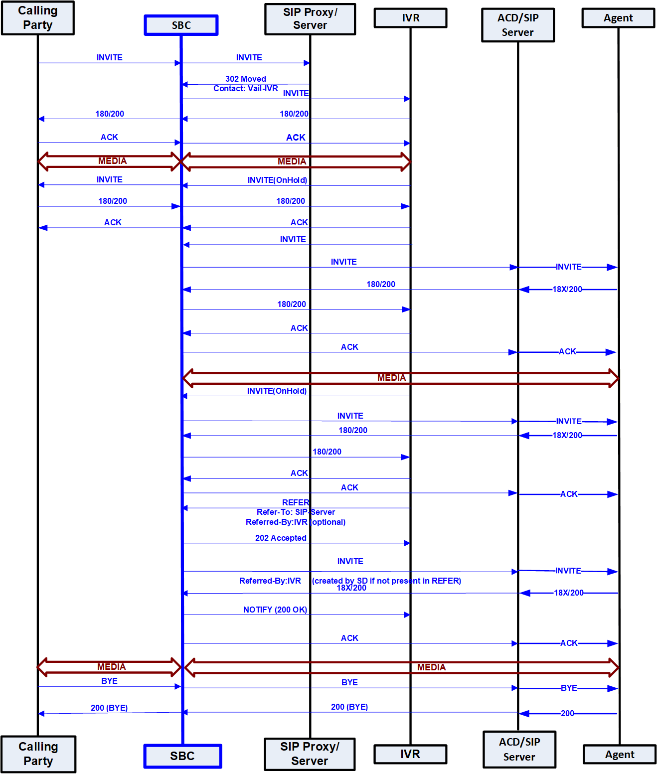

The following is an example call flow of an attended call transfer:
An example of a call flow for an attended call transfer.

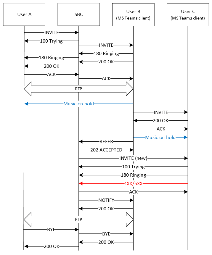

Continuing Calls in Failed REFER Call Transfers
When a REFER call transfer fails, you can configure whether the SBC ends the original call automatically, or lets it continue.
By default, when a REFER call transfer fails for unattended transfers or attended transfers where SBC issues a new INVITE rather than a reINVITE, the SBC waits 32 seconds, and then ends the original call.
However, some Advanced Media Termination clients, such as Microsoft Teams, play music on hold (MoH) while transferring calls, during which no signaling updates are sent to the recipient or the SBC (this is music sent directly from the client, different from the local media playback configuration for REFER on the SBC). If the transfer fails, and the original caller resumes the call with the original recipient, the SBC is not aware of any signaling updates or that the original call has resumed, and ends the call after 32 seconds.
To ignore the 32 second timer after a failed transfer and continue the original call, you can enable the refer-fail-resume parameter on the realm-config. Instead of automatically ending the original call after 32 seconds, the SBC allows the call to continue and it ends as normal: when either side sends a BYE, when the session-timer for the original call elapses, or when the subsq-guard-timer for RTP configured for the realm elapses, whichever happens first.
Call Flows

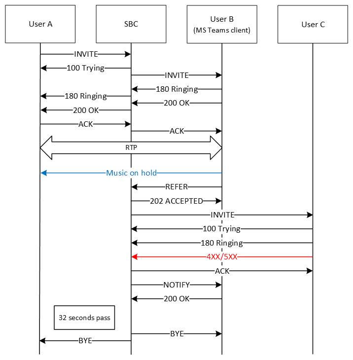

The following image shows the default unattended referral call flow, when refer-fail-resume is disabled, and the referring user is an Advanced Media Termination client. In this flow, a call between User A and User B is established, then User B plays music on hold for User A while referring the call to User C. The referral fails with a 4XX or 5XX response, and the SBC notifies User B. Because the SBC does not see any further signaling updates in 32 seconds, it ends the call.
The image shows the default flow, with the call dropped after 32 seconds.

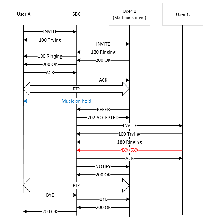

The following image shows the same call flow as above, but with refer-fail-resume enabled. In this flow, after notifying User B of the failed referral, the SBC does not end the original call between User A and User B.
The image shows the unattended call flow with refer-fail-resume enabled.
A similar flow applies when refer-fail-resume is enabled in the following unattended referral situations:

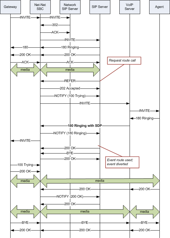

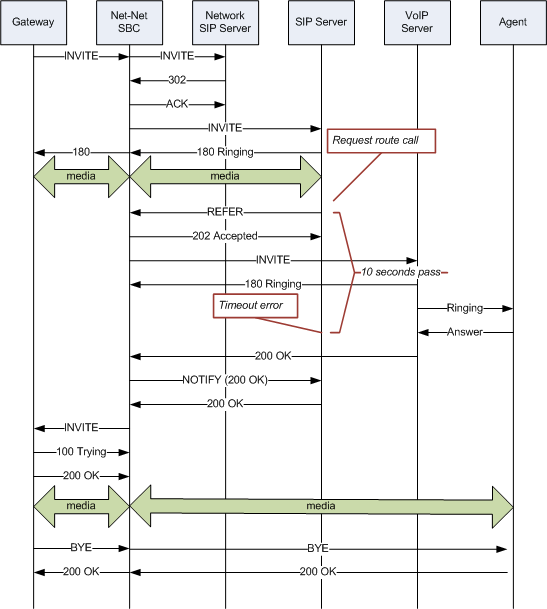

The SBC can optionally send NOTIFY messages after sending either a 202 Accepted or a 180 Ringing message in REFER call transfer scenarios.
Networks elements that comply with RFC 5589 expect a NOTIFY message after a 202 Accepted and each provisional 180 Ringing. To send these expected messages, set the refer-notify-provisional parameter to initial or all.
When you retain the default setting for this parameter (none), the SBC does not send the NOTIFY until it receives the 200 OK response from the agent being called. If the time between the REFER and the NOTIFY exceeds time limits, the NOTIFY from the SBC may go undetected by devices compliant with RFC 5589, resulting in failures during the routing process.
The following image shows a sample call flow when refer-notify-provisional is set to none.
The image shows the call flow when refer-notify-provisional is set to none, as described above.
In contrast, the following image shows the call flow when refer-notify-provisional is set to all. In this flow, the SBC now sends a NOTIFY in response to the 202 Accepted, and another after the 180 Ringing. This causes the event to be diverted successfully.
The image shows the call flow when refer-notify-provisional is set to all, as described above.

  7. Set refer-fail-resume to determine what the SBC does when a blind REFER fails:
    • disabled: (Default) Automatically end the call after 32 seconds.
    • enabled: Ignore the 32 second timer and continue the original call. This is useful for sessions with Advanced Media Termination clients using music on hold.
