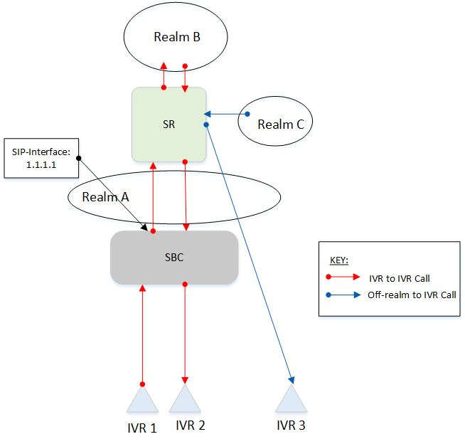

Session-Agent Identification Example
In the example below, the SBC has a session-agent configured for the SBC, which forwards traffic from three IVRs. IVR to IVR calls flow in the fashion depicted. The Session Router also has session-agents configured which identify the IVRs using DNS lookups. These agents are used when processing off-realm to IVR calls where the Session Router will send messages to the IVR directly. With this feature, the Session Router in the IVR to IVR call (shown in red) can apply IVR1's CAC despite SA-SBC being matched by IP address.
The Session Agent Identification example diagram is described above.
Configured Session-Agents on the Session Router
Hostname: SA-SBC
ip: 1.1.1.1
match-identifier: <blank>
associated-agents:
	IVR1.oracle.com
	IVR2.oracle.com
	IVR3.oracle.com
Hostname: IVR1.oracle.com
match-identifier:
	identifier-rule: SA-SBC-Rule
	match-value: ABC1
match-identifier:
	identifier-rule: SA-SBC-Rule2
	match-value: ABC1
associated-agents:
	<blank>
Hostname: IVR2.oracle.com
match-identifier:
	match-value: ABC2
match-identifier:
	match-value: ABC2
associated-agents:
	<blank>
Hostname: IVR3.oracle.com
match-identifier:
	match-value: ABC3
match-identifier:
	match-value: ABC3
associated-agents:
	<blank>

Session Agents
The Session Agent is configured with the session-agent-id-rules. You can add multiple match-identifiers. The following configuration contains sample settings for the purpose of providing an example. Your configuration may require different values.
<<Example associate-agent>>
hostname                              IVR1.oracle.com
ip-address
port                                  0
state                                 enabled
app-protocol                          SIP
app-type
transport-method                      StaticTCP
match-identifier
              identifier-rules        SA-SBC-Rule1
              match-value             1234
match-identifier
              identifier-rules        SA-SBC-Rule2
              match-value             Abc
associated-agents                     <blank>
constraints                           enabled
<<Example master-agent>>
hostname                               SA-SBC
ip-address                             1.1.1.1
port                                   5060
state                                  enabled
app-protocol                           SIP
app-type
match-identifier                       <blank>
<<This field will not appear if not configured>>
associated-agents                      IVR1.oracle.com
                                       IVR2.oracle.com
                                       IVR3.oracle.com
constraints                            enabled
In the above example, the sip-invite/registration is offered by session-agent SA-SBC. To perform CAC, SA-SBC's associated-agents list is looked up for a match between the match-identifiers and the incoming request. Once a match is found for a particular associated-agent, the existing CAC constraint is applied.
