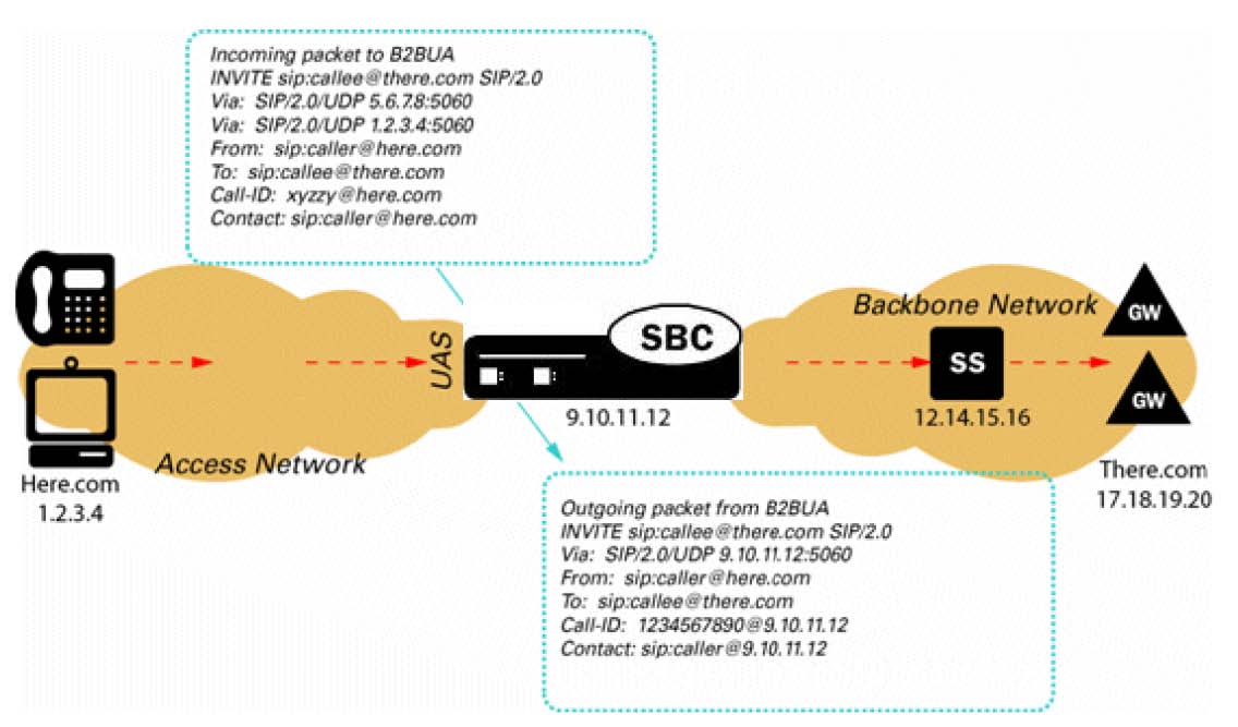

Session Border Controller
- Peering - In a peering model the
SBC is contacted by a SIP server to relay endpoint signaling information.
The SIP server may be a PBX, registrar, proxy, SBC, or other device. The IP
of the device is usually trusted and pre-provisioned in the SBC as an
endpoint (session agent) that will be relaying calls. Since the remote
endpoint is already known, Access Control Lists (ACL) and Call Admission
Controls (CAC) can be pre-provisioned for the appropriate level of
protection or service level assurance.
- Access - In an access model the SBC
is contacted by a SIP endpoint to relay endpoint signaling information. The
IP address of the endpoint is usually not known, so trust should be
established through behavior such as establishment of a successful
registration. Once the endpoint becomes trusted, dynamic Access Control
Lists (ACL) and Call Admission Controls (CAC) can be applied. Monitoring of
potentially abusive behaviors provides a mechanism to “demote” or place
endpoints on a blocklist.

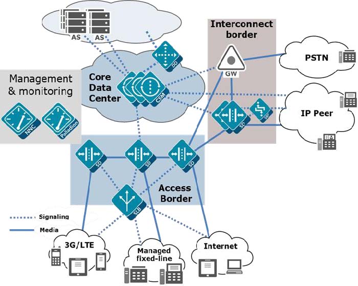

- Hybrid - A hybrid model combines both Peering and Access topologies into a single configuration. This is a fairly common model, where remote users use a registrar server in the core network, but their calls are forwarded to a service provider on one of the peer connections.
Core Session Manager
The Core Session Manager, which should never be positioned at a network edge, is used as a core session controller between multiple network types. It supports SIP in IMS and non-IMS environments, application servers, media servers, gateways, etc. It can be deployed in a distributed, virtualized model on COTS server hardware. The CSM can be used for session routing, interoperability assurance, CAC, and subscriber database integration through HSS, ENUM, or local subscriber table databases.

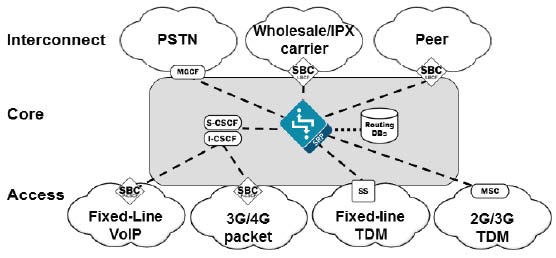

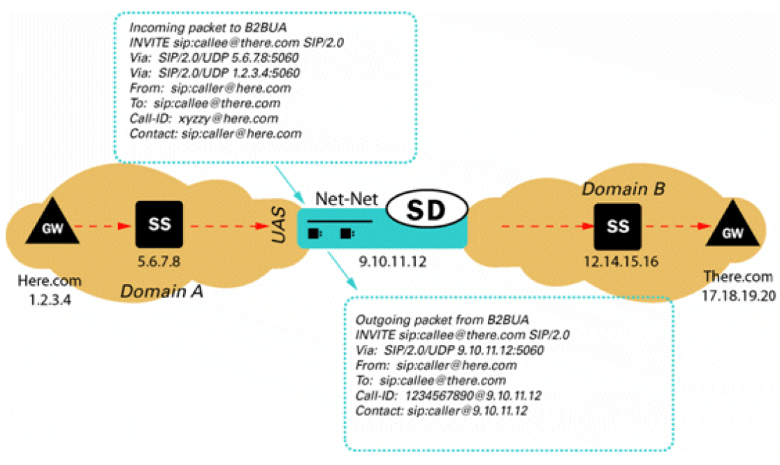

Session Router
The Session Router is a “pure” SIP session router that can be positioned in either a core network or at network borders. When installed at a border, the same SBC protections used in peering and access models can apply. In the network core, the emphasis is on routing and interoperability.

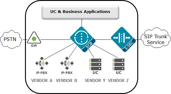

Enterprise Communications Broker
The Enterprise Communications Broker (ECB) should only be deployed within an enterprise core network, and not on the edge. Instead of perimeter security, the ECB is oriented towards functions such as dial plan management, centralized session, routing, CAC, load balancing, and interworking.
