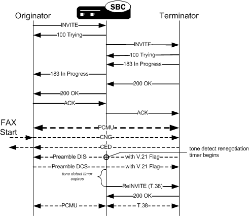

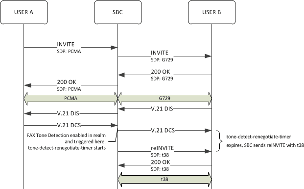

Fax Tone Detection Renegotiation Timer
Upon detection of the DIS Preamble V.21 flag or CNG tone, the SBC starts a configurable tone Detect Renegotiate Timer (tone-detect-renegotiate-timer). The tone detect renegotiate timer parameter is configurable per codec policy and defaults to 500ms. If the SBC receives a ReINVITE from the originating or terminating endpoint, the tone Detect Renegotiate Timer will be reset and no ReINVITE will be sent from the SBC toward the terminating endpoint.
If the SBC does not receive a ReINVITE from the called endpoint before this timer expires, it creates and sends an INVITE to the terminating endpoint.

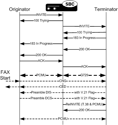

ReINVITE Codecs
There are two codecs that can be inserted into the reINVITE message: T.38 & G711 (defaulting to PCMU). You configure T.38OFD and/or G711OFD in the add codecs on egress parameter in the codec policy configuration element. These codec names are only used for reINVITEs in this feature. Each one is inserted into the reINVITE’s message body on its own m= line. The SBC sends 2 m-lines so the endpoint can pick its preferred codec from the two.
This image depicts the SBC detecting a fax attempt.
Call Completion
In the typical case, the SBC sends a reINVITE toward the terminating endpoint with the specified codecs. The terminating endpoint replies with a 200OK indicating it can use the specified codec. When this call leg is set up, fax media will flow through the SBC and be transcoded between the originator’s codec and the terminator’s codec.
The following call flow shows the typical example:

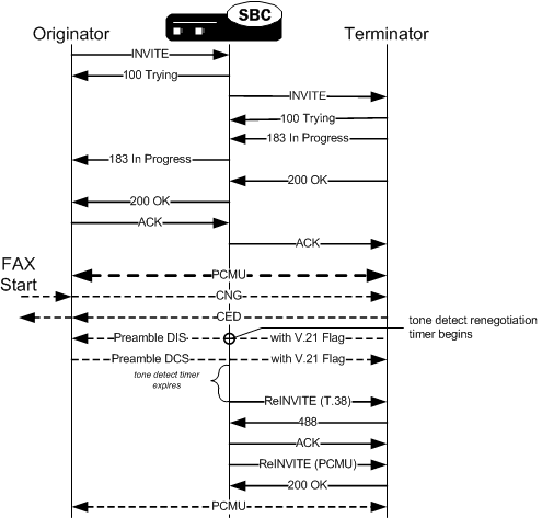

When the terminating endpoint rejects the T.38 reINVITE, and the OFDFB is configured as an add-on-egress codec, the SBC sends a G711 offer toward the call terminator.

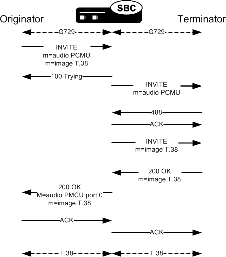

Supporting FAX to UAs that Do Not Support Multiple SDP M-Lines
The Oracle Communications Session Border Controller (SBC) sometimes supports FAX transcoding scenarios using a Re-INVITE that includes two m-lines in the SDP. Some end stations, however, do not support multiple m-lines, causing the FAX setup to fail. You can configure the SBC to resolve this problem on a per realm basis via transcoding policy.
There are two scenarios within which the SBC supports FAX setup by issuing a ReINVITE to a caller (or callee):
  • The caller (or callee) issues a ReINVITE indicating it wants to change the call to FAX.
  • The caller (or callee) embeds FAX tones in the RTP stream.
For both scenarios, the two options for providing the FAX media type include audio or image. In both scenarios, the SBC may send a Re-INVITE that offers both media options in the SDP. This allows the caller (or callee) to negotiate media type with the SBC. In the former scenario, the caller’s ReINVITE either offers a single media option in the SDP m-line, in which case the SBC adds the other, or the caller offers both options. Note that the SBC must forward a final response to the caller (or callee) in this scenario. In the latter scenario, the SBC simply recognizes the attempt to start in-line FAX and issues a ReINVITE to support that setup.
You can configure the SBC to remedy the lack of support for multiple m-lines in some stations by offering one media type at a time using the codec-policy element’s fax-single-m-line parameter. When you configure this parameter, the SBC offers either audio or image media type in the ReINVITE. Should the callee reject the offer, with a 488 - Not Acceptable Here message for example, the SBC sends another ReINVITE with the other media type choice. This negotiation may or may not result in a transcoded media stream. That is, if both end stations negotiate to the same codec, no transcoding is needed.
Example 1 - Offer Image First
This example depicts a transcoding scenario that changes a call to FAX. The initial Re-INVITE arrives offering image as the media type. The SBC issues its Re-INVITE with fax-single-m-line set to image-first. The terminating station declines image media type, so the SBC retries, offering audio media type. The terminating station accepts this media type. Note that the SBC sends its response to the originating station, accepting image media type. Subsequently, the first leg operates with image media type and the second with audio, requiring transcoding.
Figure 20-3 Offer Image First
This image shows the SBC performing FAX detection when the offer presents the image first.

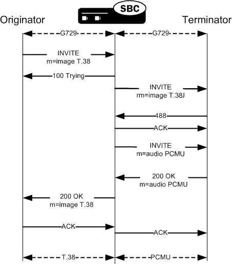

Example 2 - Offer Audio First
This example depicts a transcoding scenario and configuration that changes a call to FAX. The initial Re-INVITE arrives with 2 m-lines. The SBC issues its Re-INVITE with fax-single-m-line set to audio-first. The terminating station declines audio media type, so the SBC retries, offering image media type. The terminating station accepts this media type. Note that the SBC sets its response to the originating station with audio media type set to port 0. Subsequently, both legs operate with image media type, requiring no transcoding.
Figure 20-4 Offer Audio First
This image shows the SBC performing FAX detection when the offer presents the audio first.

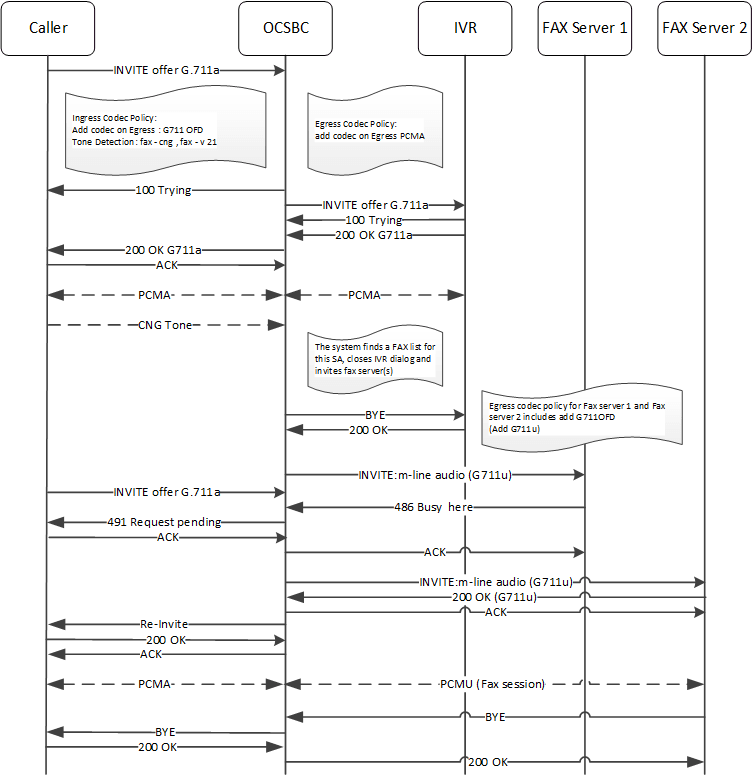

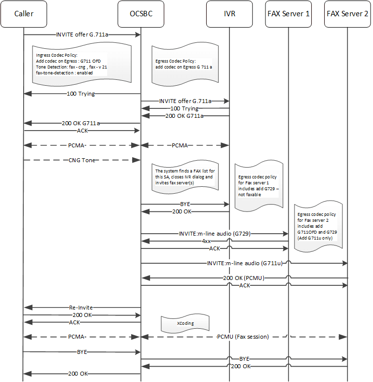

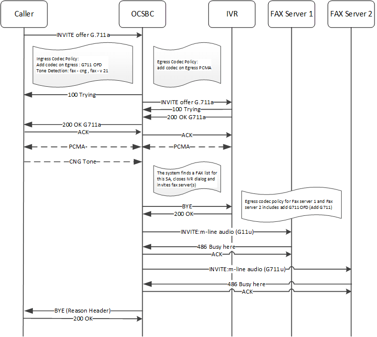

FAX Detection and Redirect
You can configure the SBC to detect fax signaling within a SIP call and redirect those calls directly to a group of one or more fax servers. By default, the SBC sends a reINVITE either to a caller or calling party, based on your setting for the reverse-fax-tone-detection-reinvite parameter, when it detects a fax tone from the media stream. There are some call flows, however, that need redirection to the FAX endpoint without using this reINVITE. You can configure this support by setting the fax-servers parameter with the name of an applicable session-agent-group on the applicable session-agent. When enabled, the Fax Redirect feature takes precedence over the above mentioned legacy fax functionality.
This feature is dependent on specific DSP resources and, therefore, is not available when deployed on platforms that do not support transcoding. Refer to your version's release notes to determine which platforms apply.
Within the context of fax call flows that can use this feature, incoming audio/fax calls are often initially answered by an auto attendant or interactive voice response (IVR) service before going to a target fax server. Without configuring the fax-servers parameter, the SBC cannot send the fax transaction to this new endpoint. Instead, the SBC sends a reINVITE to the calling/caller side based on your reverse-fax-tone-detection-reinvite configuration.
To support fax re-direct, you configure:
  • A session-agent object for each target fax server. Each session-agent should include:
    • A realm-id to ensure proper routing. The SBC does not consult local-policy to route the request, instead using the fax server’s information on the IVR’s session-agent.
    • A codec-policy that includes add-codecs-on-egress configured with G711OFD, T.38OFD or both.
  • A session-group that includes:
    • The dest parameter configured with the names of each target fax server's session-agent.
    • sag-recursion enabled.
    • Your selected strategy.
  • A session-agent for the IVR. This agent needs the name of the applicable session-group configured on the fax-servers parameter.
  • A codec-policy on each realm that sends applicable fax traffic. These should include:
    • add-codecs-on-egress configured with G711OFD, T.38OFD or both.
    • tone-detection configured with CNG/CED.
    Use at least one of G711OFD/T.38OFD codecs in this policy to send an offer with faxable codecs to the fax server.
    If the policy has no fax codecs, this feature still sends egress offers to the fax server, but the faxes fail.
  • A codec-policy on each applicable ingress realm that includes:
If you enable reverse-fax-tone-detection-reinvite on the ingress codec-policy, you must have at least one tone detection codec (G711OFD/T.38OFD) configured on the egress codec-policy associated with the egress peer. If not, the SBC cannot detect fax tone.
For example, if you enable reverse-fax-tone-detection-reinvite on the codec-policy in the caller's realm, you must also configure the IVR session agent's codec-policy to add G711OFD, T.38OFD or both using the add-codecs-on-egress parameter .
Each codec-policy discussed above includes additional configuration that you can use to refine your media management of these flows. Consider additional codec-policy configuration, such as adding or removing specific codecs, to enhance your individual deployments.

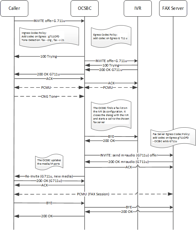

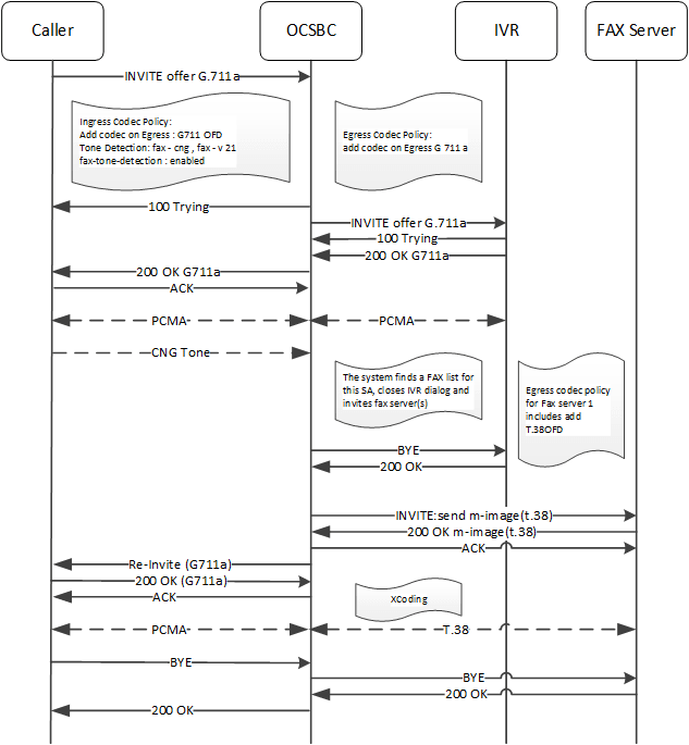

With this feature configured and triggered by fax tone detection, the SBC:
  1. Sends a SIP BYE message to terminate the session established with the IVR and waits for the 200 OK.
  2. When it receives a 200 OK to the BYE, the SBC deletes both the east and west side flows to release the media resources consumed by the audio call. If there is no reply from IVR before the BYE transaction times out, the SBC clears the call resources.
  3. The SBC does not send a BYE to the caller after terminating a call with an IVR.
  4. The SBC selects a fax server from your session-group based on your configured selection criteria.
  5. The SBC sends an INVITE with an SDP offer based on the codec policy configured on the egress realm of selected fax server.
  6. When it receives a 200 OK response for the INVITE request sent to the fax server, the SBC creates a new client dialog. It then adds this client dialog to the call session, modifies media flows, and sends an ACK to the fax server.
  7. The SBC sends a reINVITE towards the caller.
This reINVITE provides the caller with the new media IP/port allocated from the steering pool for the new media flows. Although the SBC uses the SDP originally negotiated with caller side, it updates the media IP/port and session version number in this SDP without consulting the egress codec-policy configured on caller’s realm.
Ensuing SBC behavior is based the response from the caller for the reINVITE. If it receives:
  • A 200 OK, the SBC replies with an ACK and begins fax media processing.
  • No response, the SBC sends two BYEs, towards the fax server and the caller after the reINVITE transaction times out.
  • A reINVITE/UPDATE from the caller while it is creating a session with a fax server, the SBC sends a 491 - Request Pending to the caller.
  • If it receives a failure response (4xx/5xx/6xx), the SBC sends the ACK and then two BYEs, towards the caller and the fax server to clear both the call legs.
Regarding the selection of a target fax server, enabling sag-recursion on your fax group ensures the SBC recurses through your entire session-group. Otherwise, the SBC attempts to reach the first fax server only. When enabled, the SBC:
  • Tries to reach the next fax server in your group if it receives 4xx or 5xx responses from its target.
  • Terminates recursion through your group if it receives a 6xx response from any fax server in your group.
  • Terminates recursion through your group if it receives any response configured in the stop-sag-recurse parameter.
Additional functionality includes:
  • If it receives a 200 OK with a different SDP, the SBC sends an ACK, and then a BYE to the fax server. Furthermore, the SBC does not try any other server, instead sending a BYE to the caller with a reason header containing the message Exhausted fax servers.
  • If it does not receive any response from a target, the SBC waits for the transaction timeout, then tries the next target in your session-group.
  • If it receives a re-direct (3xx) response from the fax server, the SBC sequentially tries to INVITE the new address(es). If it does not receive a success response from any of these targets, the SBC resumes recursion through your session-group.
  • If it receives no response, including no 100 Trying, from a specific fax server, the system retransmits this request. Once the transaction times out, the system sends an INVITE request to the next fax server in the list.
  • If it receives no successful response from any target in your session-group, the SBC clears the transaction by sending a BYE with the reason header Exhausted fax servers to the caller.

Fax Redirect without Transcoding
One of the simplest call flows for this FAX Handling with Redirect feature does not include transcoding of the fax media. The SBC performs the detect and redirect functions of this feature in this flow, with the results unaffected by any codec policy or manipulation.
This image depicts FAX Handling with Redirect and No FAX media Transcoding.
Fax Redirect with Transcoding
The next flow uses codec-policy configurations at several points within the SBC, including an ingress policy on the caller's realm, an egress policy on either the IVR realm or session agent configuration, and an egress policy on the selected fax server's session agent configuration. After the initial signaling and fax detection, the SBC transcodes the fax media using PCMA on the caller side and T.38 on the fax server side.
This image depicts FAX Handling with Redirect with FAX media transcoding.
Fax Redirect with Codec Policy Error and Hunt
This next call flow depicts the SBC recursing through the fax group to find a second target. There can be many reasons to search the server list. Some issues end the call, but the issue in this flow, The session agent for FAX Server 1 has a codec policy that does not add a faxable codec to it, but the agent for FAX server 2 does. In this case, the error interrupts the flow, but the system continues with the call, ultimately succeeding with FAX Server 2.
This image depicts FAX Redirect with a codec policy error and a hunt to an alternate fax server.
