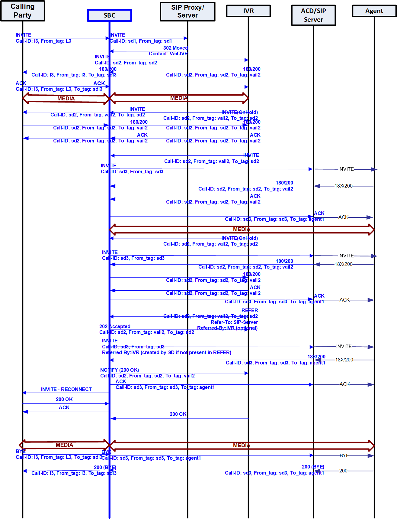

The following is an example call flow for an unattended call transfer:
An example of a call flow for an unattended call transfer.

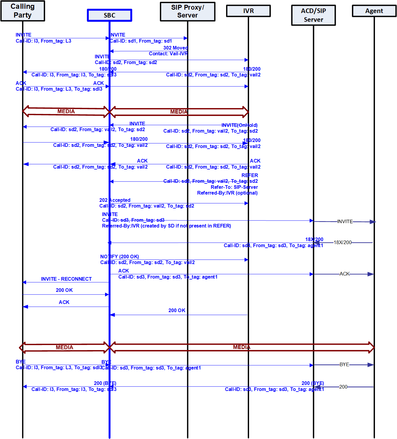

The following is an example call flow of an attended call transfer:
An example of a call flow for an attended call transfer.

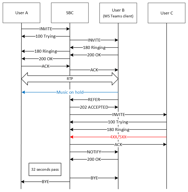

Continuing Calls in Failed REFER Call Transfers
When a REFER call transfer fails, you can configure whether the SBC ends the original call automatically, or lets it continue.
By default, when a REFER call transfer fails for unattended transfers or attended transfers where SBC issues a new INVITE rather than a reINVITE, the SBC waits 32 seconds, and then ends the original call.
However, some Advanced Media Termination clients, such as Microsoft Teams, play music on hold (MoH) while transferring calls, during which no signaling updates are sent to the recipient or the SBC (this is music sent directly from the client, different from the local media playback configuration for REFER on the SBC). If the transfer fails, and the original caller resumes the call with the original recipient, the SBC is not aware of any signaling updates or that the original call has resumed, and ends the call after 32 seconds.
To ignore the 32 second timer after a failed transfer and continue the original call, you can enable the refer-fail-resume parameter on the realm-config. Instead of automatically ending the original call after 32 seconds, the SBC allows the call to continue and it ends as normal: when either side sends a BYE, when the session-timer for the original call elapses, or when the subsq-guard-timer for RTP configured for the realm elapses, whichever happens first.
Call Flows
The following image shows the default unattended referral call flow, when refer-fail-resume is disabled, and the referring user is an Advanced Media Termination client. In this flow, a call between User A and User B is established, then User B plays music on hold for User A while referring the call to User C. The referral fails with a 4XX or 5XX response, and the SBC notifies User B. Because the SBC does not see any further signaling updates in 32 seconds, it ends the call.
The image shows the default flow, with the call dropped after 32 seconds.

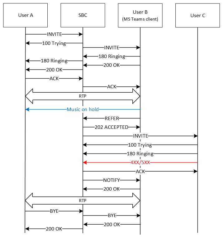

The following image shows the same call flow as above, but with refer-fail-resume enabled. In this flow, after notifying User B of the failed referral, the SBC does not end the original call between User A and User B.
The image shows the unattended call flow with refer-fail-resume enabled.

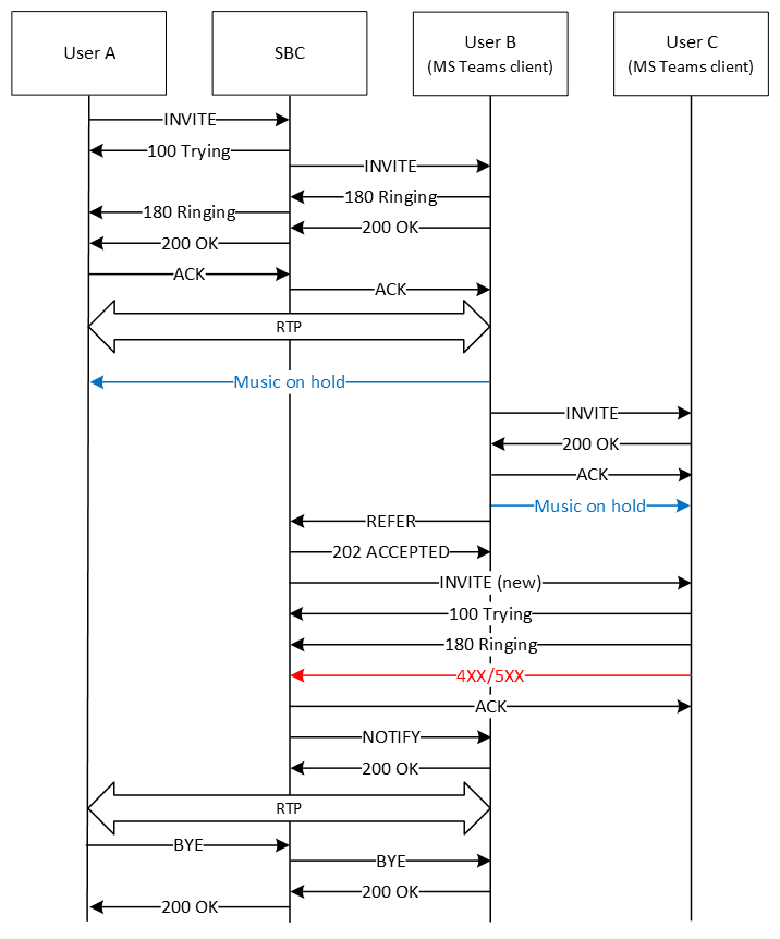

The following image shows the attended referral call flow, when refer-fail-resume is enabled, and the SBC issues a new INVITE to begin the referral.
In this flow, a call between User A and User B is established, then User B makes an attended referral to User C, sending an INVITE and reINVITE for the hold directly to User C. These succeed, and User B sends the REFER to the SBC. The SBC issues a new INVITE (rather than a reINVITE) to User C to establish the referral, and this fails with a 4XX or 5XX response. The SBC notifies User B, and the original call between User A and User B resumes.
The image shows the attended call flow with refer-fail-resume enabled.
If refer-fail-resume were disabled in the previous flow, the SBC would end the call after 32 seconds.

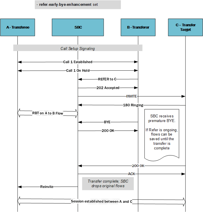

The following call flows depict the SBC attempting to handle RBT during refer scenarios. These images include two scenarios wherein the system does not support, and then does support RBT through the refer processing.
This first scenario is a simple transfer scenarios. Upon receiving a BYE from user agent, the SBC performs its default behavior, which includes the system stopping the RBT and clearing the flow on both sides. This drops the flow from the SBC to A even though it is busy supporting an RBT media flow.
This image depicts the system dropping the RBT flow after receiving a BYE from the transferor.

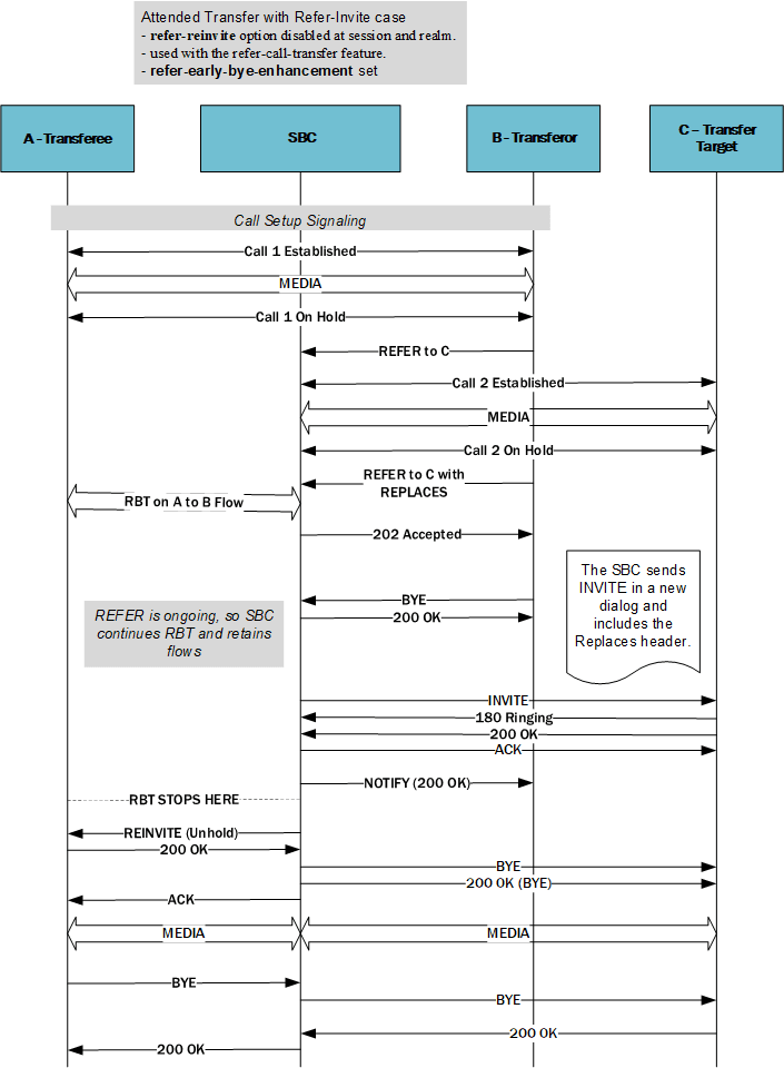

When you set the refer-early-bye-enhancement option, the SBC does not tear down the flow during this blind/attended (Invite) transfer because it detects a pending REFER. Instead, the SBC maintains the flow until the transfer is complete or it receives a 200OK from B.
This image depicts the system successfully supporting the RBT flow in this blind attended transfer even though it has received a BYE from the transferor.

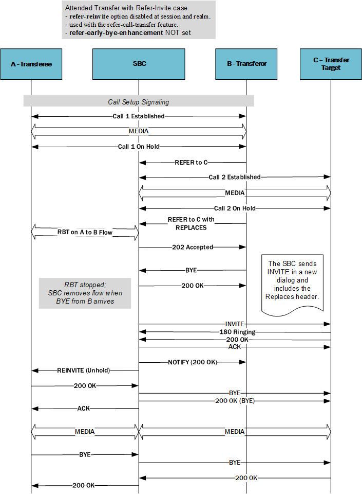

This scenario depicts the SBC supporting an attended Transfer with Refer-Invite case. You have left the refer-reinvite option disabled at the session and realm. Here, the SBC sends an INVITE in a new dialog and includes the Replaces header. This is used in conjunction with the refer-call-transfer feature
This image depicts the system dropping the RBT flow during this attended Transfer with Refer-Invite case after receiving a BYE from the transferor.
Again, because you have set the refer-early-bye-enhancement option, the SBC does not tear down the flow during this attended Transfer with Refer-Invite case because it detects a pending REFER. Instead, the SBC maintains the flow until after it sends a NOTIFY (200 OK) to B confirming the transfer is complete.
This image depicts the system successfully supporting the RBT flow in this attended Transfer with Refer-Invite case even though it has received a BYE from the transferor.
