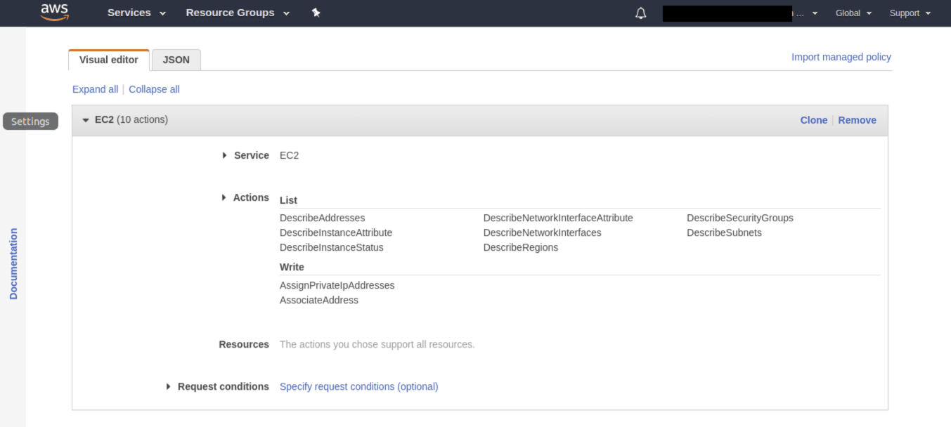

Configure an IAM Role
Create an IAM policy and role for high availability SBC instances. (This is not required for standalone SBCs.)
  1. Create an HA policy.
    1. Navigate to Services, and then IAM, and then Policies, and then Create policy.
    2. Select the JSON tab.
    3. Paste the following JSON into the JSON editor.
          "Statement": [
                  "Action": [
                      "ec2:DescribeAddresses",
                      "ec2:DescribeNetworkInterfaces",
                      "ec2:DescribeNetworkInterfaceAttribute",
                      "ec2:DescribeInstanceAttribute",
                      "ec2:DescribeSubnets",
                      "ec2:AssignPrivateIpAddresses",
                      "ec2:AssociateAddress",
                      "ec2:DescribeSecurityGroups",
                      "ec2:DescribeInstanceStatus"
                  "Effect": "Allow",
                  "Resource": "*",
                  "Sid": "VisualEditor0"
          "Version": "2012-10-17"
    4. Click Review Policy.
      Policy actions
    5. Enter a name and description for this policy.
    6. Click Create policy.

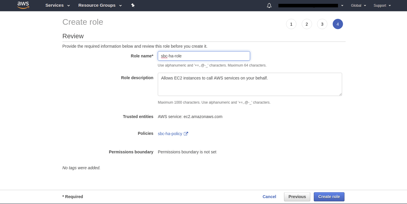

  2. Create an HA role.
    1. Navigate to Services, and then IAM, and then Roles, and then Create role.
    2. Select AWS service, and then EC2, and then Next: Permissions.
    3. Select the previously created policy and click Next: Tags.
    4. Add metadata tags, if desired, and click Next: Review.
    5. Enter a name and click Create role.
      Create role

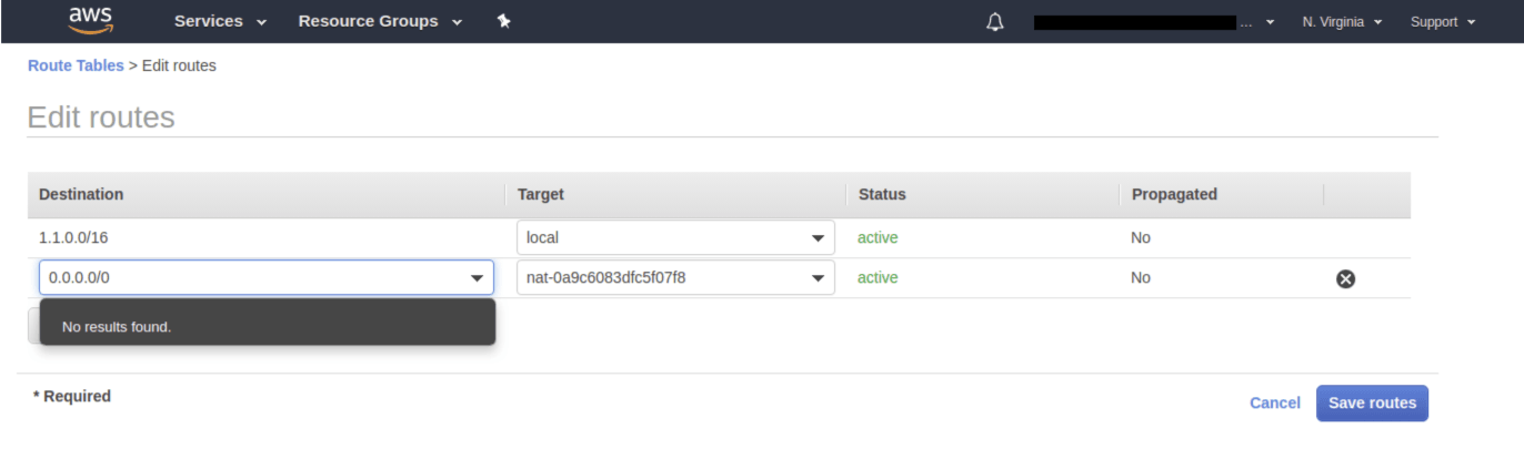

  3. Add the NAT gateway and private wancom0 subnet to the route table.
    1. From the Route Tables page, select your route table.
    2. In the Routes tab, select Edit routes and then Add route.
    3. Add a route for 0.0.0.0/0 to the target route.
      Edit routes
    4. Click Save routes.

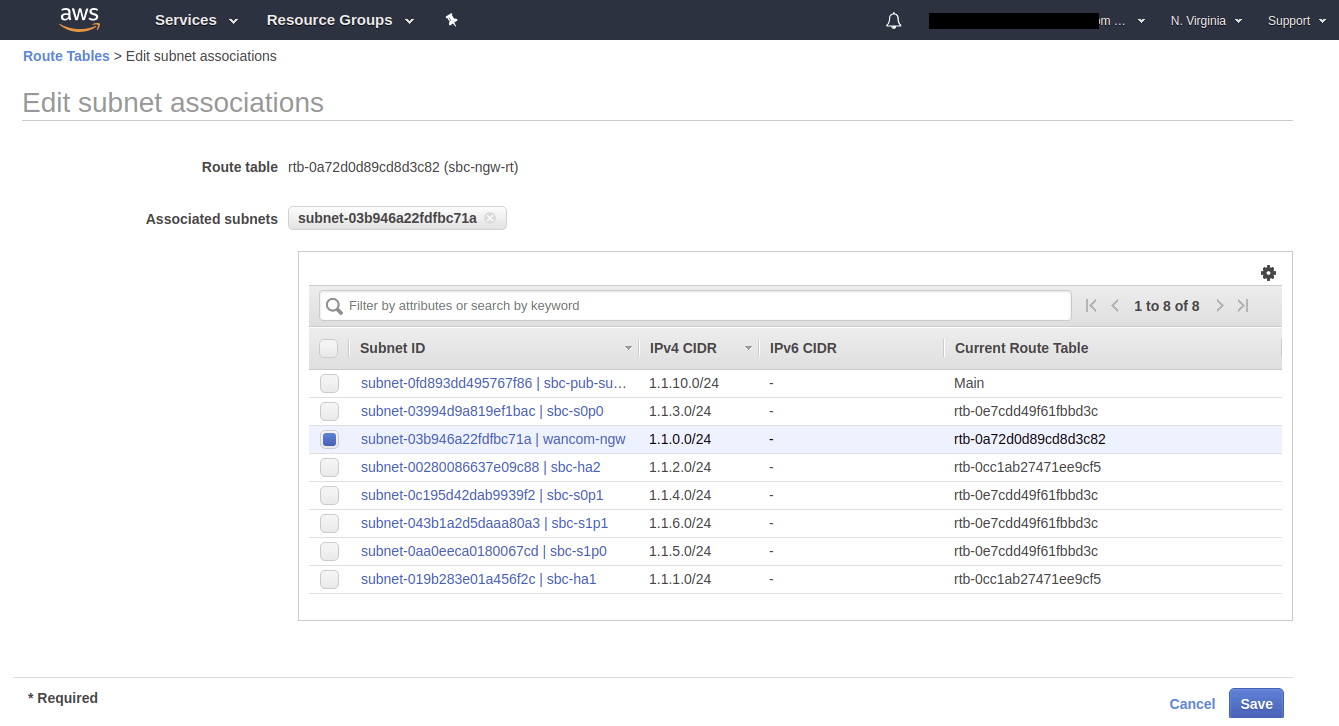

  4. Associate your private wancom0 subnet with the route table.
    2. In the Subnet associations tab, select Subnet associations and then Edit subnet associations.
    3. Select your wancom0 subnet.
    4. Click Save.

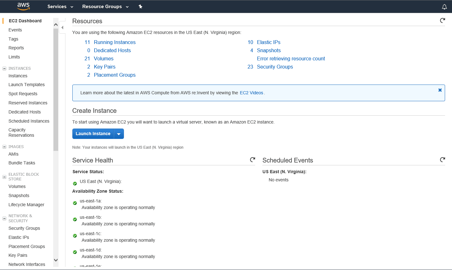

Launch Your Instance
  1. Login to the AWS management console and click the EC2 link to open the EC2 Dashboard.
  2. Review and confirm your deployment's Region and Availability Zone.
  3. On the EC2 Dashboard, click Launch Instance.
