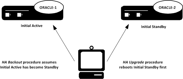

See the diagram below, which addresses how the HA Upgrade procedures' sequence includes rebooting the standby system first to avoid service interruption.
Figure 12-1 Configure and Reboot Standby First for HA Procedures
For Upgrade and Backout, perform procedures on Standby first.
