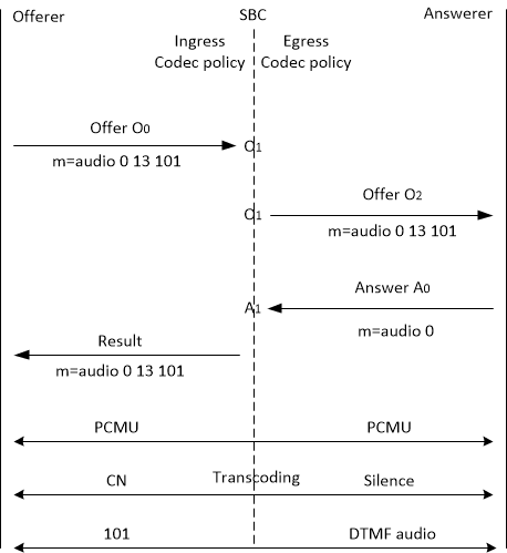

Comfort Noise and Telephone Event Codecs Both Transcoded Scenario
In the following scenario, the SBC transcodes both Comfort Noise (CN) and telephone event codecs.
  1. The Offerer sends an offer (O°) with an SDP m-line for an audio codec PCMU to the SBC, and includes both CN and telephone-event signaling codecs.
  2. The codec-policy for the ingress realm allows all codecs and outputs O¹. The SBC egress codec-policy takes O¹ as input, allows all codecs, and produces output O².
  3. The Answerer responds with the answer in A° containing the PCMU audio codec. The egress codec-policy produces answer A¹ with no changes.
  4. The SBC applies the add-codecs-on-egress parameter from the ingress codec-policy to add CN and telephone-event to A¹. The result contains the audio codec PCMU and the CN and telephone-event signaling codecs because the SBC excepts signalling codecs from the rule that the system can apply the add-codecs-on-egress parameter only by the egress codec policy.
Even with CN transcoding enabled, the SBC does not transcode the audio codec (PCMU). The SBC transcodes silence detection and generation, as well as CN packet detection and generation. The SBC transcodes telephone-events to in-band DTMF audio.
Ingress codec policy Settings Egress codec policy Settings
allow codecs * allow codecs *
add codecs on egress CN telephone event add codecs on egress N/A
order codecs N/A order codecs N/A
dtmf-in-audio preferred dtmf-in-audio preferred
The Comfort Noise and Telephone Event Transcoded call flow is described above.
