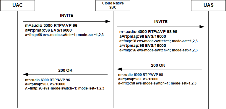

Payload Type Mapping
The user enables EVS AMR-WB IO payload type mapping using the media-manager-config option audio-payload-type-mapping=yes. If the option is not present, EVS AMR-WB IO payload type mapping is disabled.
media-manager
options
Furthermore, the payload-type is not critical as long as the audio-payload-type-mapping=yes option is configured. Normally the PTI used in the network is configured in the payload-type field. But the SBC matches against codec name/string instead of payload-type.

EVS Call Flow Example
The flow depicted below provides an example that uses the audio-payload-type-mapping=yes to enable payload type mapping. In addition, the flow uses add-codecs-on-egress configuration in the egress codec policy configured as EVS::PT98. The offer contains EVS in AMR-WB IO mode and the SBC adds EVS AMR-WB IO with a different payload type. The answer uses the added EVS. The offer and answer are both octet-aligned and they have intersecting mode-sets, so transcoding is not required and payload type mapping is used.
