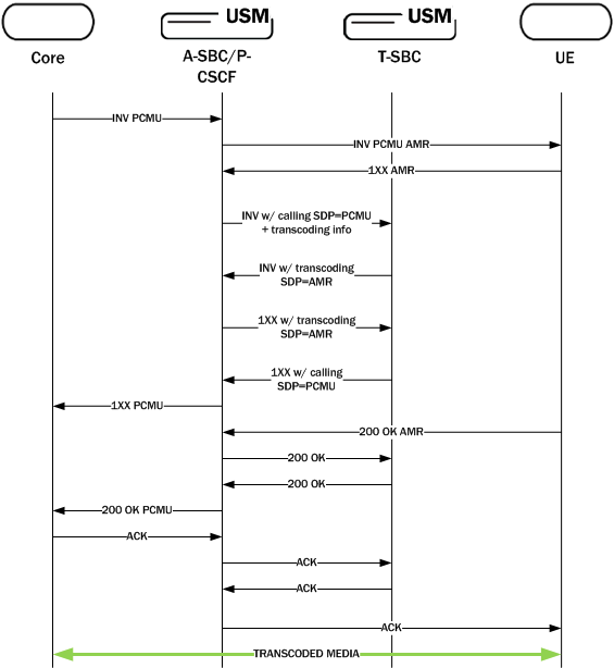

When the A-SBC identifies a transcoding agent, the A-SBC sends an INVITE to which the T-SBC responds with a 2xx message. Configuring the A-SBC as a session agent and disabling dialog transparency (in global SIP configuration) on the T-SBC allows the T-SBC to accept SIP messages from the A-SBC. Then the T-SBC acts as a B2BUA, using the information received in the INVITE from the A-SBC to invoke transcoding and to route SIP signaling back to the A-SBC on egress.

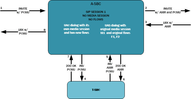

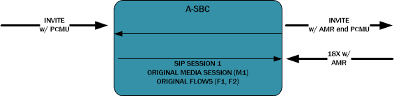

Scenario 1 INVITE with SDP
When the Access Session Border Controller (A-SBC) receives an INVITE with SDP, the A-SBC creates a SIP session and an associated media session with two flows for audio. The A-SBC applies the appropriate codec policy (with add-on-egress configured), so that the egress INVITE contains the necessary codec.
The INVITE with SDP call flow is described in the paragraphs above and below the image.
The A-SBC receives an answer to the INVITE, and when the answer contains the added codec the A-SBC invokes the Transcoding Session Border Controller (T-SBC) using an INVITE with the same SDP as the INVITE received on ingress. The communication between the A-SBC and the T-SBC is a separate dialog associated with a new media session.
The following code block shows and example of the INVITE the A-SBC sends to the T-SBC.

Note that the Target Dialog and Acme-Codec-Policy headers communicate operational parameters for pooled transcoding. Using such information, the T-SBC applies two codec policies and returns the INVITE to the A-SBC. The A-SBC moves the media session to itself, but the SIP session does not have a media session at this time.
The INVITE with SDP diagram is described above.

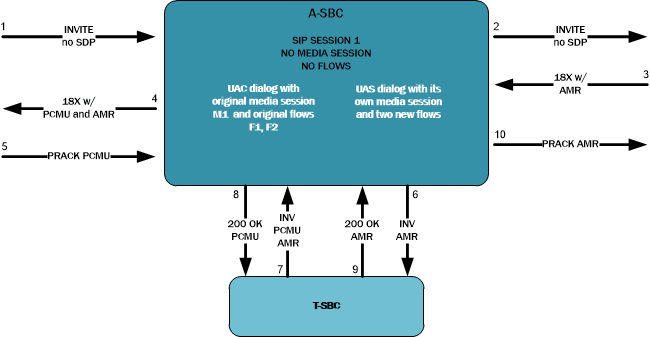

For an offerless call flow, the system creates a media session when the offer comes in a reliable provisional or final response. The Access Session Border Controller (A-SBC) applies the codec policy and sends the egress offer to the calling UE.
The INVITE Without SDP call flow is described in the paragraphs above and below the image.
When the A-SBC receives an answer in either a PRACK or ACK message, the A-SBC compares the offer and answer. An answer containing the codec added in the egress offer causes the A-SBC to invoke the Transcoding Session Border Controller (T-SBC) and create a standalone UAC dialog, just as in Scenario 1.
Because the A-SBC advertised its media address in the egress offer to the calling UE, the UAC dialog uses the original media session.
The INVITE Without SDP diagram is described above.

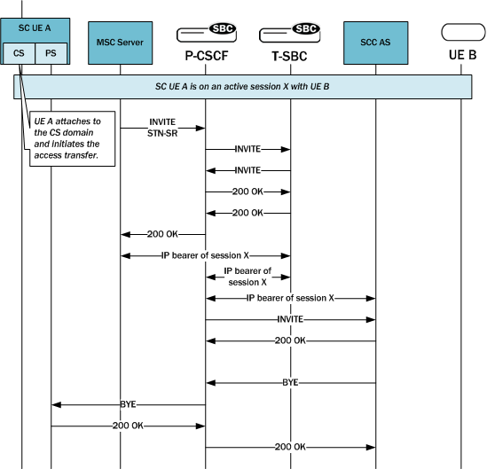

eSRVCC Support
For enhanced Signal Radio Voice Call Continuity (eSRVCC), the pooled transcoding deployment model supports instances when:
  • Original call is not transcoded, but the handover call is
  • Original call is transcoded, but the handover call is not
  • Original call is transcoded, and so is handover call
Depicts pooled transcoding of an eSRVCC call

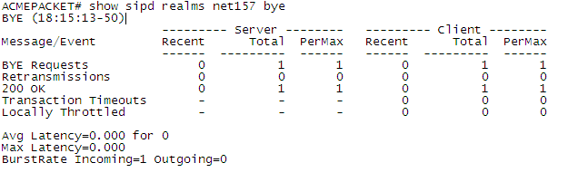

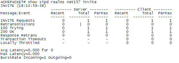

Per-Method Statistics
When you set extra-method-stats to disabled in the global SIP configuration, the system displays the per-method statistics for the Access Session Border Controller (A-SBC) public transcoding-realm.
ACLI output for the show sipd realms command, with extra-method-stats disabled.ACLI output for the show sipd realms command, with extra-method-stats disabled.
