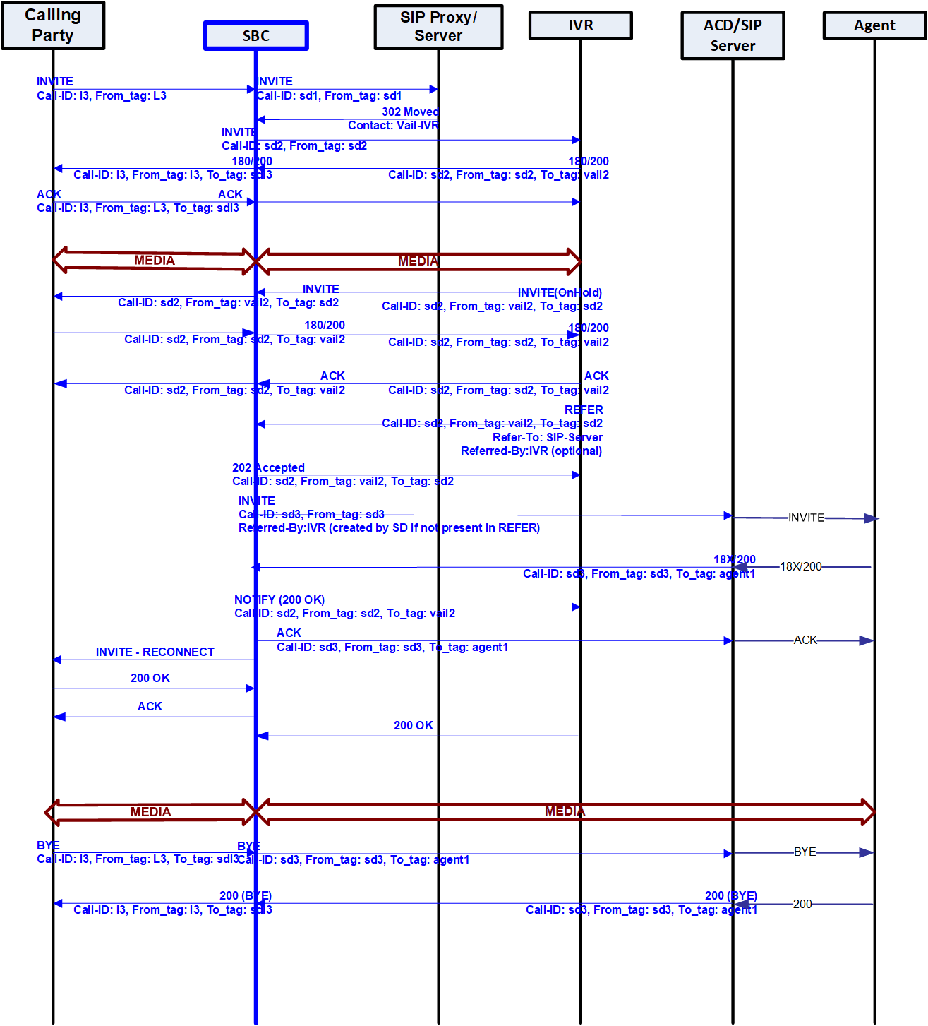

The following is an example call flow for an unattended call transfer:
An example of a call flow for an unattended call transfer.

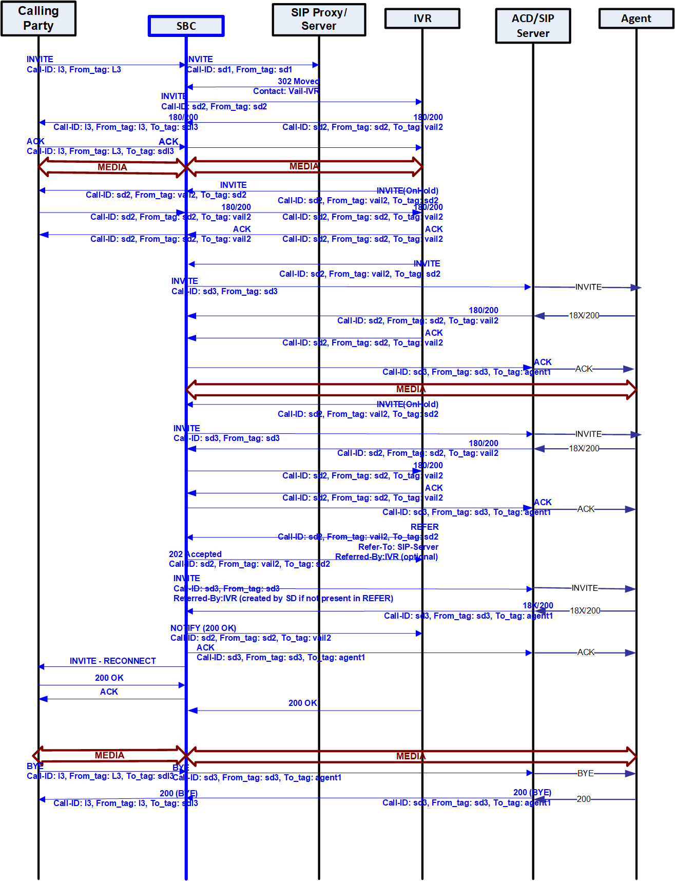

The following is an example call flow of an attended call transfer:
An example of a call flow for an attended call transfer.

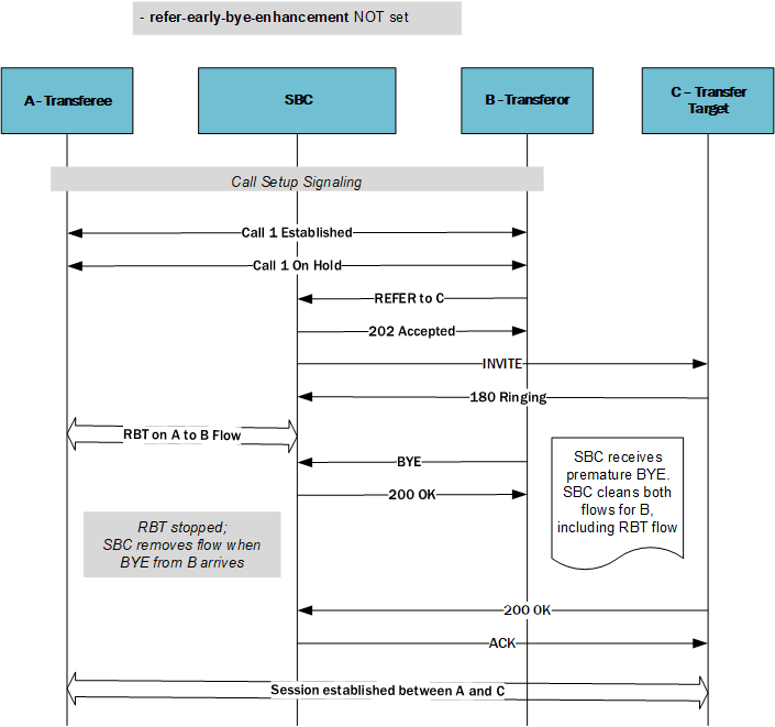

This first scenario is a simple transfer scenarios. Upon receiving a BYE from user agent, the SBC performs its default behavior, which includes the system stopping the RBT and clearing the flow on both sides. This drops the flow from the SBC to A even though it is busy supporting an RBT media flow.
This image depicts the system dropping the RBT flow after receiving a BYE from the transferor.

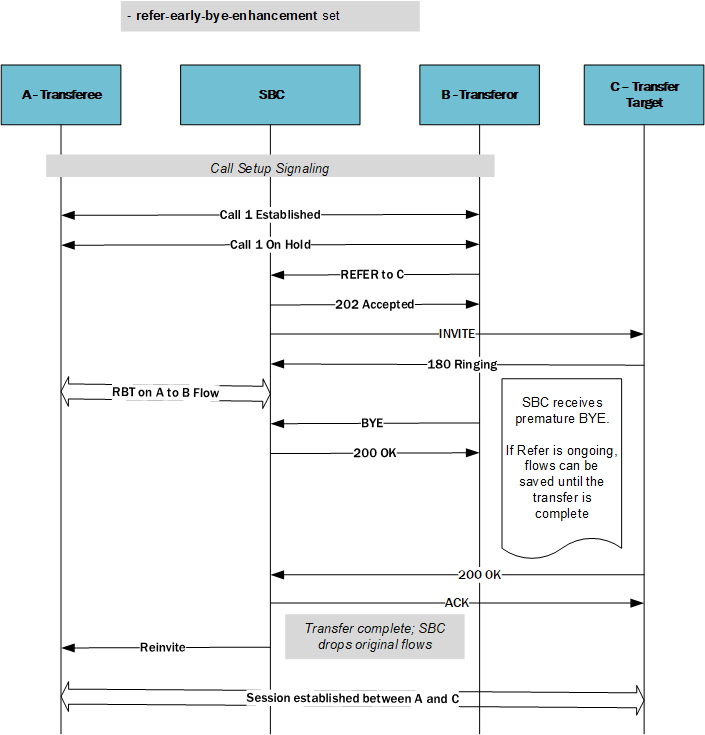

When you set the refer-early-bye-enhancement option, the SBC does not tear down the flow during this blind/attended (Invite) transfer because it detects a pending REFER. Instead, the SBC maintains the flow until the transfer is complete or it receives a 200OK from B.
This image depicts the system successfully supporting the RBT flow in this blind attended transfer even though it has received a BYE from the transferor.

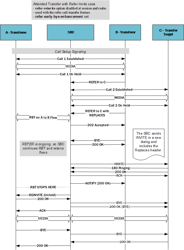

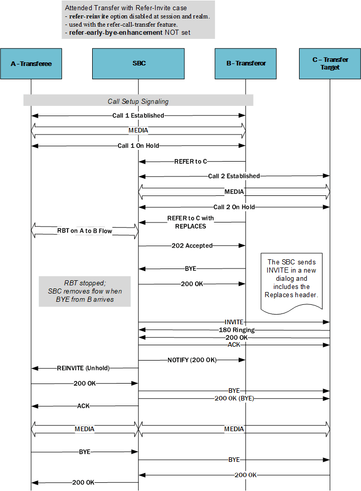

This scenario depicts the SBC supporting an attended Transfer with Refer-Invite case. You have left the refer-reinvite option disabled at the session and realm. Here, the SBC sends an INVITE in a new dialog and includes the Replaces header. This is used in conjunction with the refer-call-transfer feature
This image depicts the system dropping the RBT flow during this attended Transfer with Refer-Invite case after receiving a BYE from the transferor.
Again, because you have set the refer-early-bye-enhancement option, the SBC does not tear down the flow during this attended Transfer with Refer-Invite case because it detects a pending REFER. Instead, the SBC maintains the flow until after it sends a NOTIFY (200 OK) to B confirming the transfer is complete.
This image depicts the system successfully supporting the RBT flow in this attended Transfer with Refer-Invite case even though it has received a BYE from the transferor.
