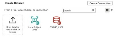

  3. Click Create and select Dataset.
    If the Create button is not visible, the user does not have the appropriate permissions.
  4. Select Local Subject Area.

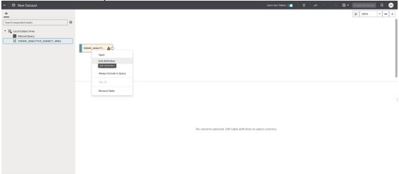

  5. From the left navigation pane, drag and drop the OSDMC_ANALYTICS_SUBJECT_AREA onto the Join Diagram canvas.
  6. Select Edit Definition.

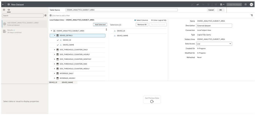

  7. Select the tables you want to add and click Add Selected.
    This example shows a dataset being created using existing tables.
    To ensure proper data association, Oracle recommends adding the DEVICE_DETAILS table (which includes the DEVICE_NAME column) to all relevant datasets and tables.
    To join the DEVICE_DETAILS table with associated tables, click and hold the Circle icon on the DEVICE_DETAILS table, then drag and drop it onto the desired tables.
