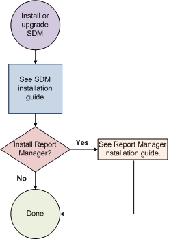

		  you can install Oracle Communications Report Manager. Refer to the flow diagram
		  below for more information:
                     Figure 1-1 Installing or upgrading OCSDM with Report Manager
