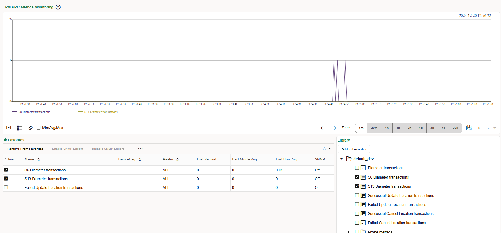

The Control Plane Monitor KPI/Metrics page offers similar functionality as the KPI/Metrics page from the Operations Monitor product. The difference is that only Diameter specific KPIs are available, and they are not editable.
This is the Control Plane Monitor KPI/Metrics page.
Figure 6-1 Control Plane Monitor KPI/Metrics Page
