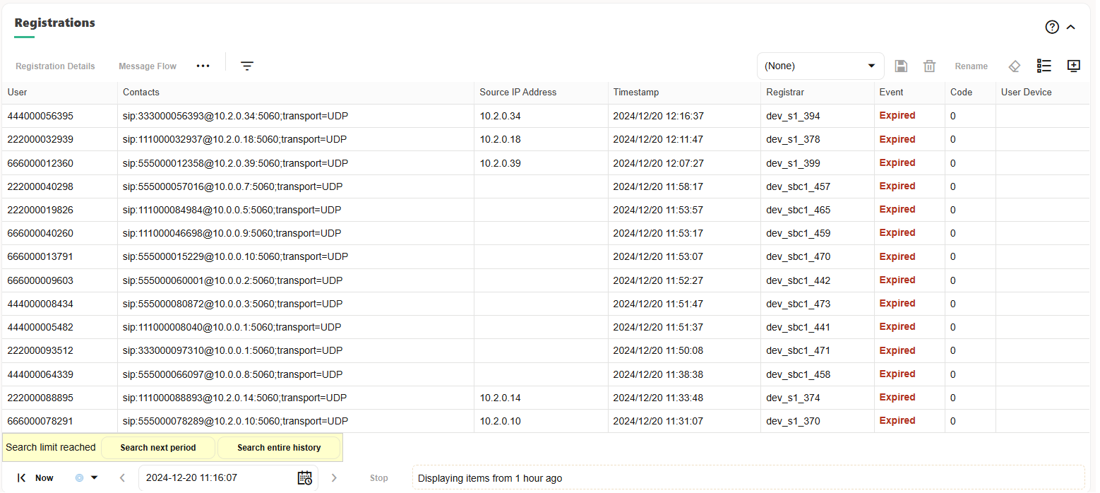

The Registrations panel contains a table of the registrations events, grouped by SIP user. The list is ordered chronologically, presenting the latest event as the first entry by default. Table columns can be resized, and the size adjustments persist even after navigating away from the page and returning back to the page. The table can be sorted and/or filtered. For more information on creating Filters, see "Filtering".

| Column | Description |
User |
Contains the user part of the AOR; if the system setting Use users domains is enabled, the domain part is also included in this field. When specifying a filtering token, all users that contain that token (position independent) will be shown. |
Contacts |
Filtering is done by matching a given string. All the contacts provided by the registering device are listed here, each as a SIP URI. |
Source IP address |
The IP address of the network device that initiated the registration event. Filtering is done by matching a given string. |
Destination IP address |
The IP address of the network server targeted by the registering device. Filtering is done by matching a given string. |
Timestamp |
The moment in time when the event occurred. Filter by specifying an interval (between Before and After) or a Date (the On date selector). |
Registrar |
The device configured in Settings/Platform Devices that was targeted by the subscriber's device when registering. When trying to filter by a certain device, a list of configured devices is presented out of which one or more can be selected. |
Event |
The type of registration event; the table below is detailed on each defined type. For filtering one can choose to filter the presented list to only include some of the possible events. |
Code |
The SIP code that the registration message exchange finished with. Filter by specifying any valid SIP reply code. |

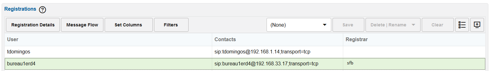

Click the Registration details button when a row is selected in the table, and a window appears containing more details for individual registration events; this window can be also opened by simply double-clicking on the selected row in the table.

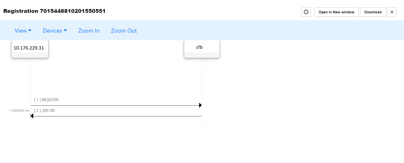

Click the Message flow button to open a SIP message flow diagram window that depicts the network entities involved and message exchange of the registration event.
Click the Set Columns button hide/unhide the columns from the display.
Click the Filters button to define filters and to see the required information in the table. For more information, see Filters section.
The CSV export button allows to have all table entries exported into a CSV file. If the contents of the table have been filtered, the contents of the exported CSV file will only contain the filtered results.

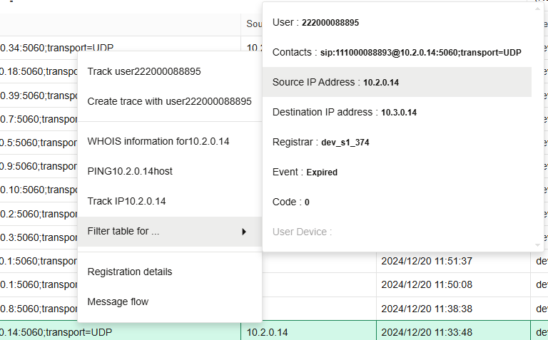

Many of these actions are available by right-clicking on a row.
Right-Click Contextual Menu - Registrations
Right-click menu actions are as follows:
Table 4-15 Right-click menu options
| Menu option | Description |
| Track user <user name> | Loads the User Tracking page with the User field pre-filled in the search panel taken from the event |
| Create Trace with user <user name> | Loads the Traces page with the User field pre-filled with the value taken from the corresponding registration event. |
| WHOIS | Allows you to inquire who is the owner of the IP used as the source of the registration. A window appears that contains the record stored into the WHOIS database for the given address |
| PING | Pings the source IP address. |
| Track IP | Redirects you to the IP tracking page to get the details about the specific IP. For more information, see IP Tracking |
| Filter Table for... | Filter table for ... allows you to filter for:
| Registration Details | Opens the Registration Details window |
| Message Flow | Opens the Message Flow window |

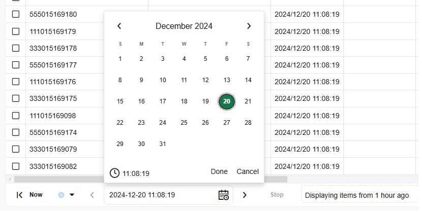

The Now button takes you to the first page, showing the newest entries. The date picker allows you to choose an arbitrary first date and time period.
Figure 4-56 The Date Picker

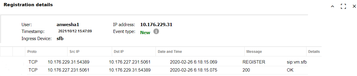

The details window for a registration event contains the following information:
The user of full AOR (subjected to settings).
The timestamp when the event occurred.
The network entity of the platform having received the registration request (the ingress device).
The IP address used to originate the requests.
The type of registration event.
A table that contains details about the exchanged messages in this event, listed in chronological order.
The table lists the columns in Registration Details window.
Table 4-16 Registration Details Window
Proto |
The network transport protocol used to carry the SIP messages from client to the platform. This field can be either UDP or TCP. |
Src IP |
The IP address of the device that generated the message; can be either the client's or one of platform boxes, depending on the direction. |
Dst IP |
The IP address of the device that received the message; just as with Source, it can be either the client's or platform's. |
Date and Time |
The moment in time when the mirrored network packet was received by Operations Monitor. |
| Message | SIP message which caused the particular event |
| Details | Details about a event. |
Registration Details Actions
In the Registration Details window, Click Expand messages to view all the raw SIP message as seen on the network. You can click Collapse Messages to display the brief view of the messages.
You can view one raw message at a time by clicking the Triangle button on any of the table's entries, as shown.Figure 4-57 Registration Details Window with One Expanded Raw Message
Beside the Help and Close buttons, the details window contains a Message flow button and a PCAP button. The Message flow button creates a SIP message flow diagram, and the PCAP button allows you to save the shown network packets into a PCAP file.
