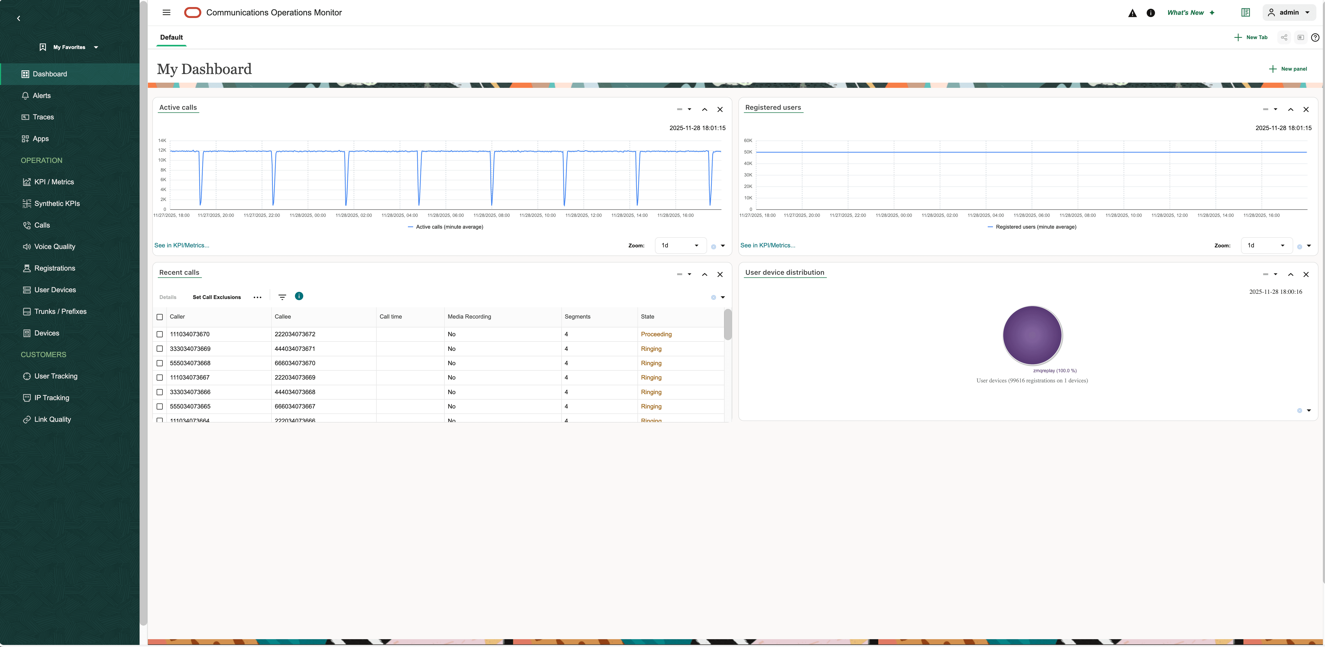

The following shows the Add a panel dialog box on the dashboard.
Figure 1-1 Dashboard
